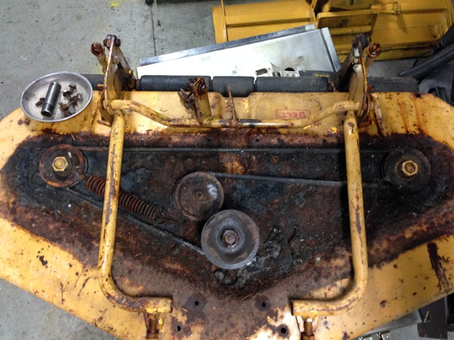

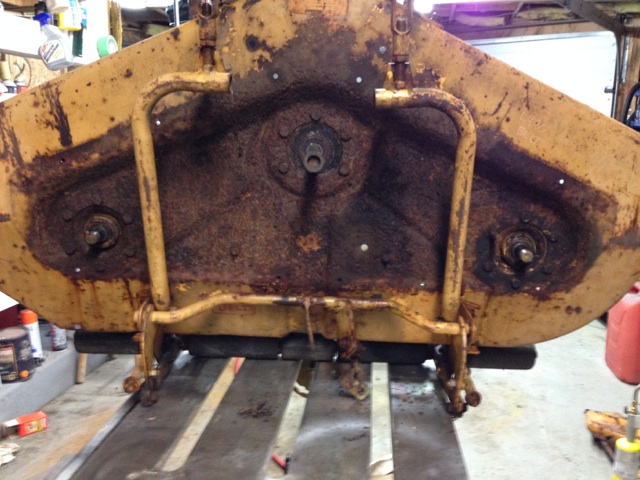

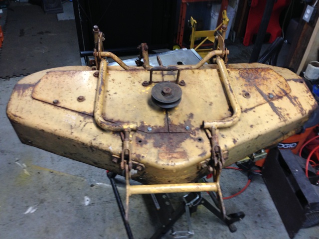

Mower deck was looking pretty sad parked out back, so in it came.
Looks like something might have been living in here the last dozen years
Got things stripped down a bit

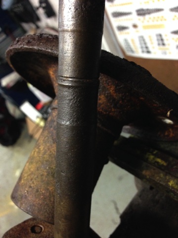

Looks like one of the center blades bearings seized up, and the lower pulley spun.
Screwed up the shaft in those two places.
Ground down the nasty area
TIG welded up the area
Then stuck it in the lathe and cut it all back down to 3/4".  And promptly forgot to take a picture of it.  Embarrassed

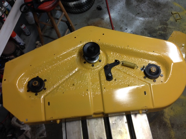

Anyhow, pressed out the old bearings, and pressed in a new set.
Stuck it all (the bearing/shaft) back together and gave it a shot of paint.

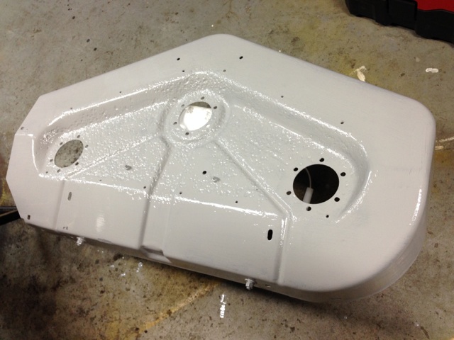

The actual body of the deck (this is the 42" version BTW) is too big to fit in MY blast cabinet (36" wide), so I'll have to run it out out to U-Blast and use his.  Went this far...  Why not!
Have to go shopping tomorrow for a new tensioner pulley (totally rusted out, and the non replaceable bearing is shot), and a new lower pulley for the center shaft.  New belt too of course.  Damn that things big!

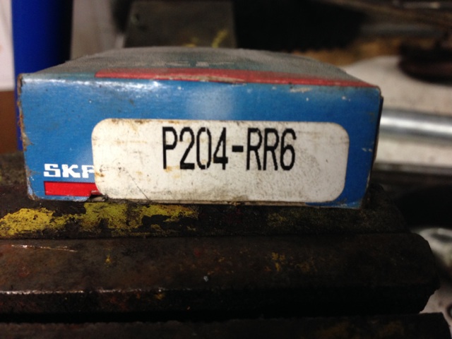

Just for 'records' sake, the bearings used were:

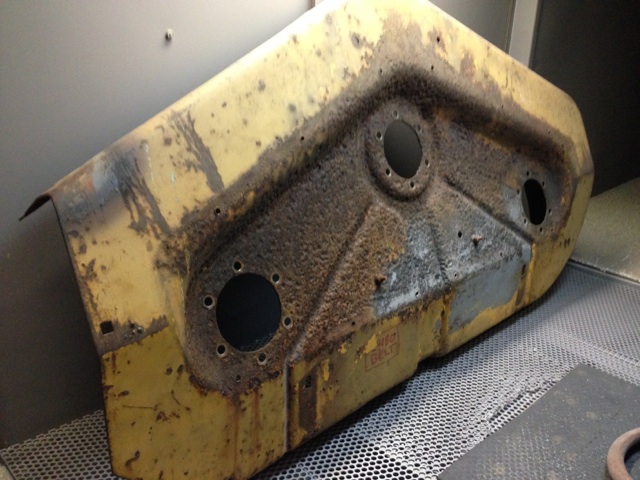

This is the deck, as it went into the cabinet (with a small test blast down in the corner!)
Then out of the cabinet, and with a shot of rust primer on it
The bail and bits are also done in the same fashion.
Things are drying now, then I'll have another go at it tomorrow when I figure I'll get it all painted, then hopefully put back together.

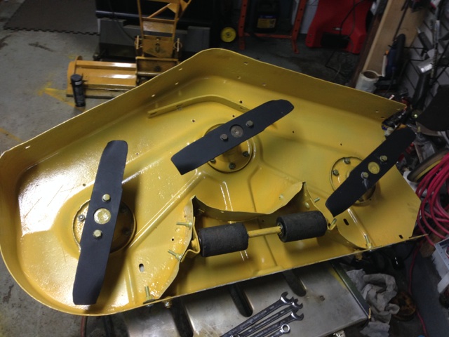

Didn't get a huge amount done...  but at least parts are going back together, instead of apart.  :)
Blades all sharpened, rollers lubed up, new fasteners, etc.
Gotta trim down the ends of the carriage bolts so they don't turn into grass hooks.
Can still see the mottling from the rust on top of the deck - at least it's under the cover(s) so you can't normally see it!

Did some more assembly last night - was having a bit of trouble getting things back together, as they just didn't seem "right".
Started looking at the parts diagram, and realized that at some point in the last ~50 years, someone has messed with things!  The adjuster assemblies had been moved from inside the bail to the outside. Then they moved the rectangular plate (the one with one square and two round holes), and put some weird bends in it!
So, a bit of quality time with a club hammer and anvil...  and now there's two flat plates. Also back where they belong. Things all fit MUCH better now. Though I'm missing the 'ears' or 'wings' that appeared to be at the top of the adjusting bolts. No biggy.

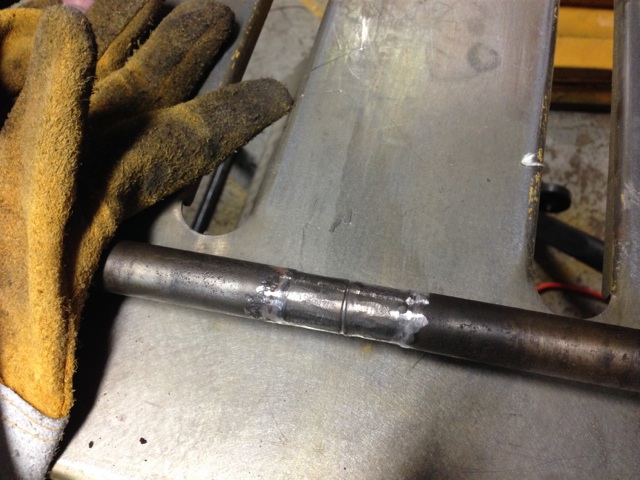

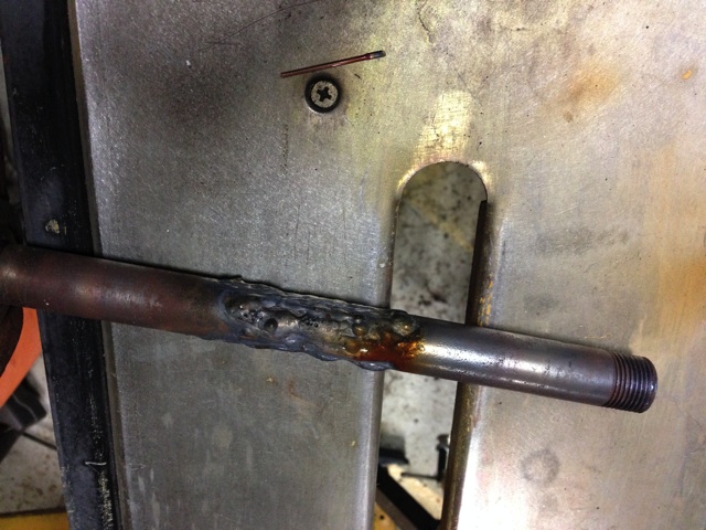

Also not sure why but your bail assembly has been cut. Sould be solid across the front, not two pieces.
Ah, good call on the bolts!  I'll make sure to flip those around.
So someone actually cut out a chunk of pipe across the front?!  Ugh.  Was it straight?  Bent?  Maybe a picture of what it was supposed to look like?  At least that's something I can fix!   Thanks!

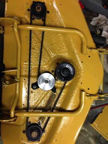

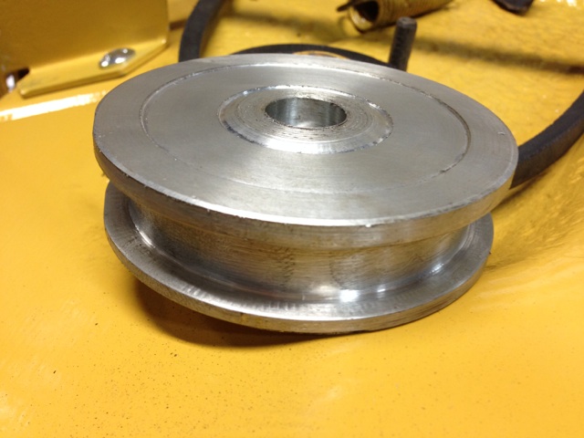

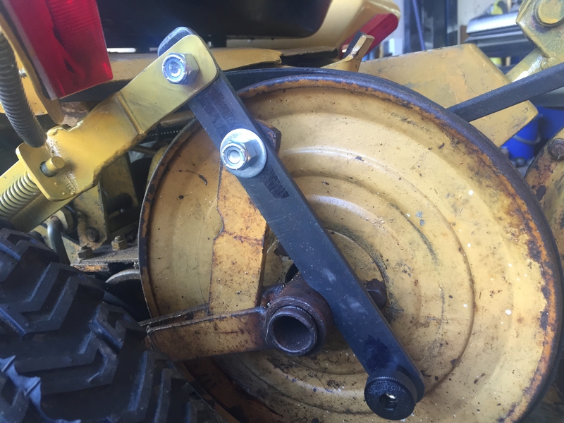

Oh, and from yesterday....  I decided to try and make that tensioner pulley.
Not perfect, but:
The photo is doing funny things with perspective. It's 3.75" at both the widest points!
(also, there's a bearing pressed in on the underside)
From an economy standpoint - this would have been ludicrous.  But, it's a hobby, and I like challenging myself to make stuff.  This started off as a 4*4*1.5" block BTW.
Current slow rides: '65 Big Ten, '79 JD 317

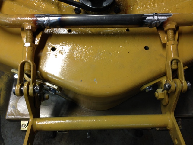

Post Options Post Options   Thanks (0) Thanks(0)   Quote Dr.Fiero Quote  Post ReplyReply Direct Link To This Post Posted: 08 Nov 2013 at 8:10pm

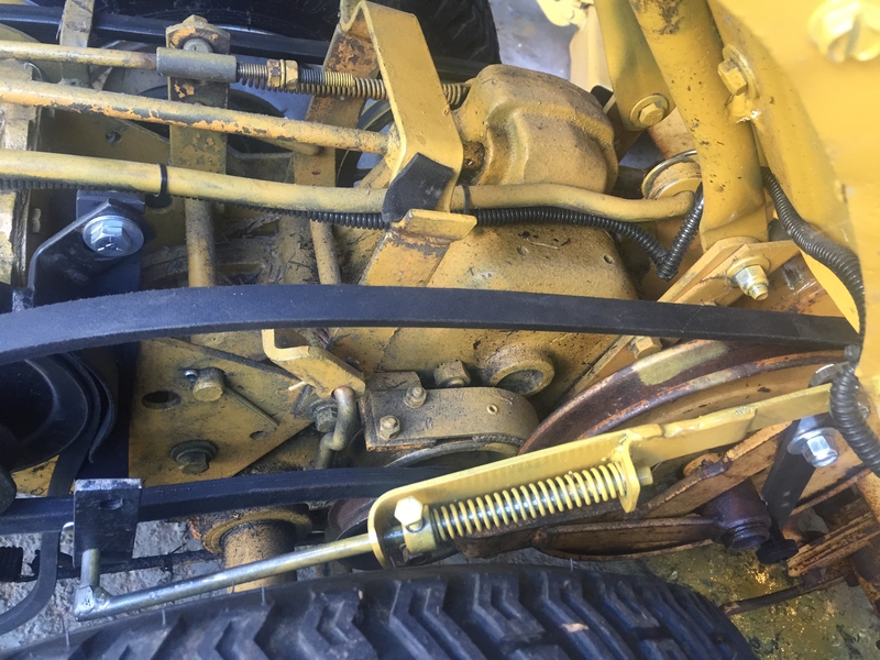

Took ACMG's advise above, and started to replace the missing chunk of bail.

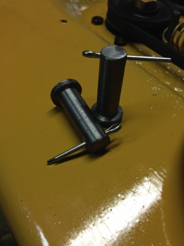

Noticed the pins at the front of it weren't really "right" (since one was an old bolt!).  Off to the store, but they didn't have anything bigger than 5/16.  Needed 1/2".
What EVER shall I do?!  Wink
There...  that's better. Got my lathe fix in too.  ;)
Smacked some 3/4" tubes inside the bail tubes, then slipped a bit of 1" over it.
There's those pins too!
Here's the belt, pulley etc all in place:
Anyhow - enough for the day.

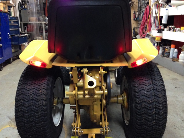

Hey ya'll...

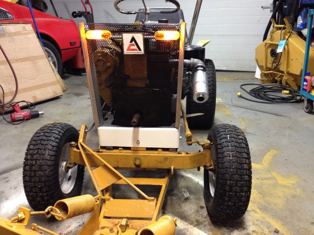

So, I was out plowing the driveway, and a bit into the street.. would seem that it's rather hard to see me after the sun goes down!  Nope - no hits - but I could feel the stares from people (though it could be of jealousy, since they all knew they'd be shoveling when THEY got home! )  LOL

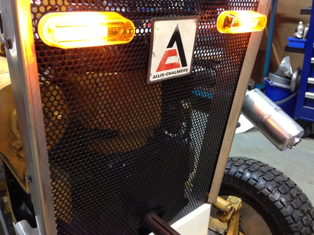

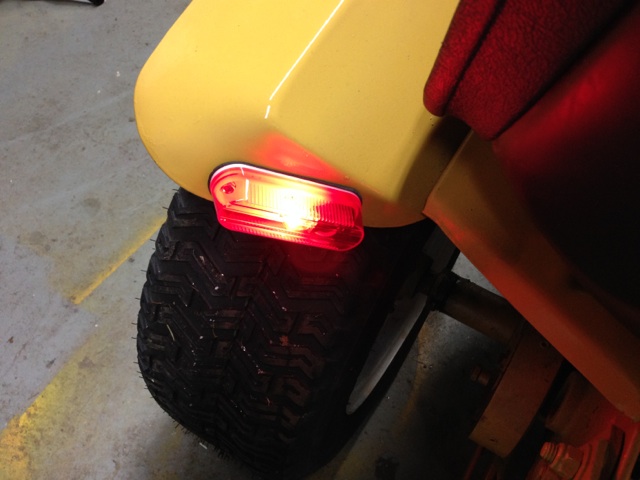

Anyhow, went out tonight and hooked up some running lights.
Nice and bright!  Found a running light kit at a "harbour freight" type place for $10, and it gave me about 10 spares to boot.  Only took about an hour.  Totally worth it.

Didn't mention - I tied the lights into the ignition relay circuit, so as soon as the key goes on, the lights come on (that way I can't forget to turn them on, or off!).
Still haven't done the decals.  Just too damn cold out. Guy who does them recommended it be at least 10C before applying, I've probably got another 2 months to wait.  Or I break out the IR heater!

So, needed to do some tilling.  Have a tiller. It hadn't seen dirt in at least 20 years.
This can't be good.  Nope, wasn't.  Seized up almost everywhere!
Well, after several days of cursing, torching, hammering - then the required remachining of now smashed parts (!)....  I got it all moving.
Didn't have any of the linkage parts though, just a lot of pictures to go from.  Had to guess on a lot of the dimensions.  At least I had the pulleys to go from. So I could take the dimension of the pulley I had, scale the drawings I found, then extrapolate the size of some of the other bits.
Not my prettiest work!  But functional.
Ditto.  ;)
Got the yard tilled anyhow, so it was a succesful mission.
