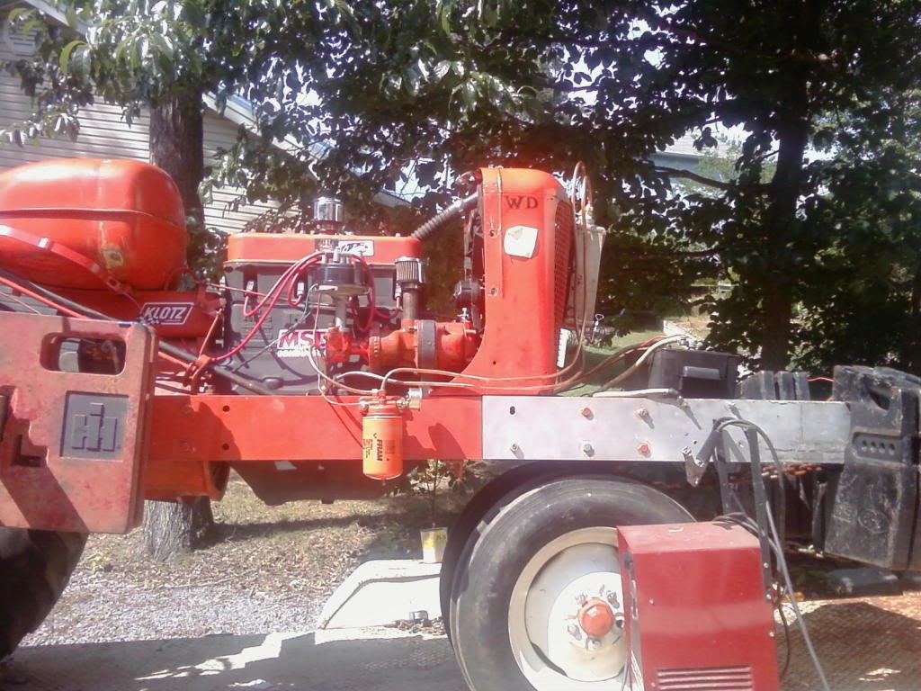

It will hold more wheight hooked to it than kens wheels will. Pulled 6000 lbs alot with that hitch.hitch has ran many of years in kentucky alabama and tn

Yeah, 6000 pounds of slow gradually applied weight, that's a lot

Better height on tires no front weight rack . What you pull 2750and quit at 3000. Butch you can move shifter to road gear with my engines. I am sure its just not my talent around the entire usa. Last picture proves point looks dont make them pull
well you so called experienced puller, I do believe road gear on the tractors ken posted is 4th gear, which he said he uses, which would also be to the middle and down, (left and down is reverse lol)

I really doesn't have to do with the strength of the adjustable link. I'm sure it's strong enough as there is much less pull downward in comparison to the pull rearward. The problem has to do with the location of the top of the adjustable link. Anything above the centerline of the rear axle is incorrect and dangerous.
Example #1:
If the lower portion of the hitch fails or gets pulled loose from the tractor, then the adjustable link being higher than the axle centerline (still attached to the loose hitch which is still attached to the sled)could potentially pull the tractor over backwards. Then, in this case since the wheelie bars are attached to the broken lower hitch, there now is nothing to keep the tractor from going over backwards.
Example #2
When a hitch fails it is typically at the beginning or even more likely at the end of a run just before it spins out. At the end of a run the front wheels are in the air so if a hitch would break at this point it is the equivalent of dumping the clutch heading up a steep hill at full power. Again, if the wheelie bars are attached to the hitch that has just left the scene, then there is nothing to keep the tractor from flipping over.
Yes there are some that will say it would never happen, but what if it did. It is certainly two plausible scenarios. If we take time to think of what could happen when building things, then bad things are less likely to happen.

Good grief slow down, take a deep breath and wipe the tears out of your eyes and the slobber off your mouth. Your like a toddler who just got told to put the cookies back in the cupboard as supper is in the oven.  Wheneveryougetallworkedupthewordsallruntogetherlikethis.
My post has nothing to do with NATPA other than I used their rule as an example. Other organisations use the same rule and it was formed with sound basis.
 The reason your hitch is not allowed is if it breaks loose at the bottom the adjusting link then becomes the pulling point and being above the center of the rear tires, or axle as they say it, this means instant back flip before the cutoff cable can work or you can get off the throttle.  This is why NATPA and a whole host of other pulling organisations require the adjusting devise to be located BELOW the axle centerline.
What this has to do with somebody who has water in the oil you need to further explain as you lost me somewhere?
Where is the Gleason?.

Usually whenever plink0 gets haggled these threads turn into a 5 gold star rateing. Whatever that means.
I wish I had more time to pull up some old info, but plink0's reason for his oil cooler at one time was because he was oil cooling the block also. Seams he couldn't keep the water out of the oil pan. Then he posts using .002" press fit on sleeves, any of you care to guess what .002" press fit will do to a ribbon of material left after boreing the block? Plink0's not as bright as he thought.
Not only is his lack of experience showing, but his lack of intelligence is showing. Trying to argue the same point from different angles every few days, not knowing if it's water, oil, what kind of system is used.
Ken and Mike would know about gears and gear ratios. One of my favorite plink0 lies is when he was telling me he was running high gear, fast ring and pinion and pulling at 5500 or 6000 pounds. His governor broke and his engine went to 6000 RPM so fast he couldn't pull the throttle back. Do any of you know how fast high gear is in a WD? Well it's very close to 18 to 1, meaning 18 turns of the crankshaft turn the wheels 1 turn.
I pull a NTPA Light Super Stock. Many of the tractors in this class also run a gear ratio real close to 18 to 1, some taller, some shorter. Just depends on turbos and how fast the engine is set up to run. But with and 18 to 1 gear ratio and big enough windmills up front, a pretty good cylinder head we can run in the 6000 RPM range also. It's just that we can prove it and have roughly 3000 HP under the hood. At 6200 pounds it takes about 2500 ft lbs of torque to pull it off and the engines may have to build more than 3000 ft lbs when the pan on the sled loads up. That's not even an impressive lie plink0, it's showing lack of intelligence even thinking you can lie like that. By the way, when the tires break and spin even the forced induction engines will climb fast, but usually only a few hundred RPM before the driver can pull the throttle.
I love the external balance BS, his flywheel drilled full of holes, OEM CAST flywheel that is. Shoots the 6000RPM story full of holes now doesn't it.
And last but not least, lets see some more pics of that oil cooler. I'd like to point out a few flaws in the way that ignition system is set up. Mounting the coil where it's placed is a no no. Running a coil wire that long is asking for trouble on such a "high performance application". The longer the wire, the more the resistance. Trust me, I have to pay attention to those things to keep all the cylinders fireing.
