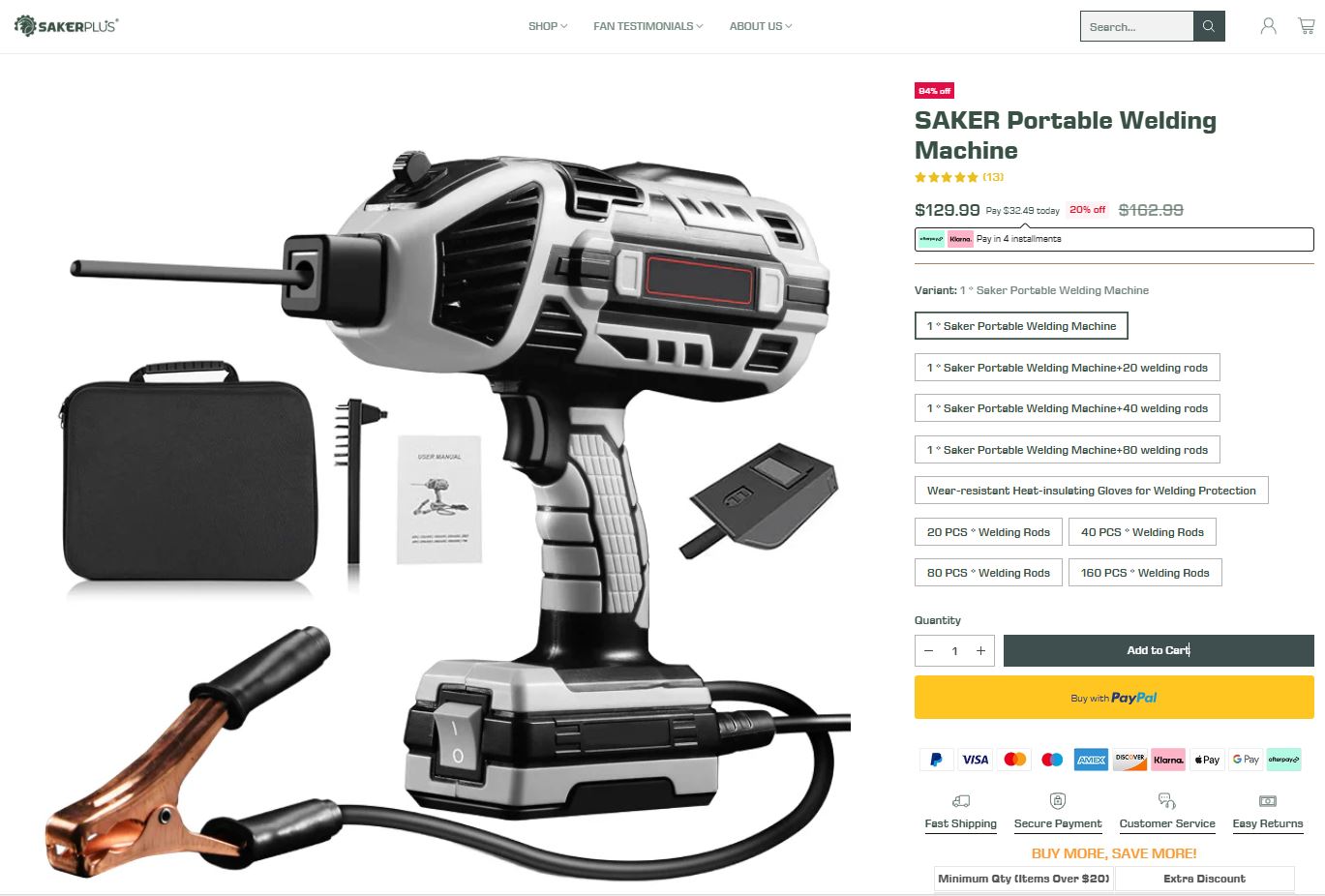

Post Options Post Options   Thanks (0) Thanks(0)   Quote Jim.ME Quote  Post ReplyReply Direct Link To This Post Posted: 16 Sep 2024 at 7:07pm
Like This?

Post Options Post Options   Thanks (0) Thanks(0)   Quote desertjoe Quote  Post ReplyReply Direct Link To This Post Posted: 16 Sep 2024 at 9:59pm
  Yeah,,Jim,,that's the one I was looking at,,,but maybe ole Steve done shot it all up,,,,,

they seem to have a FEW good reviews on some sites.. but half of the reviews are questionable.... The REALITY is that you cant get 90 amps output when your using a 120v INPUT 20 amp plug.... so i dont know how they are using 3/32 rod .. and 1/8 would be worse..

I'd love to see the manual on that  welder !
From the front page the AC cord looks real 'small', maybe no ground either ?
 Wondering what the OCV ( Open Circuit Voltage ) is ?
 Even IF I had a 20 amp plug...  could be a nice 'toy' IF I was into 'thin tin' repairs like newer lawn mower decks. Could be useful for quick tack welds(holders until REAL steel added...... )
