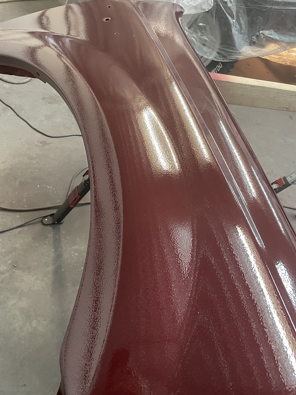

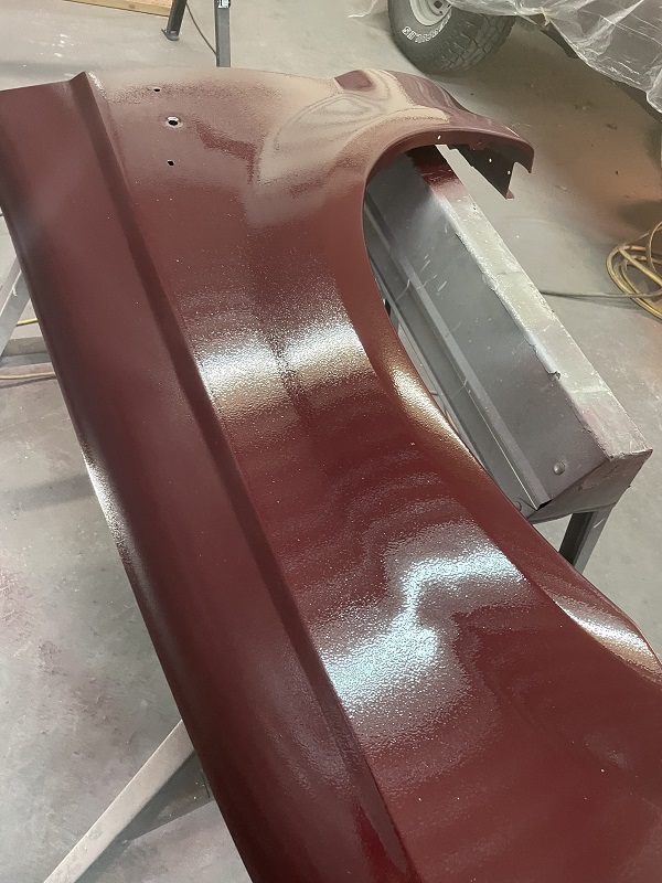

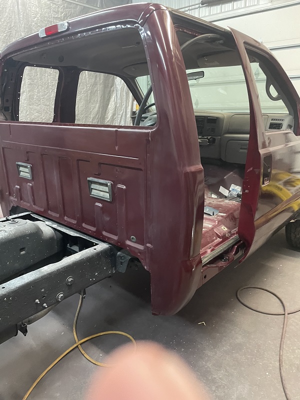

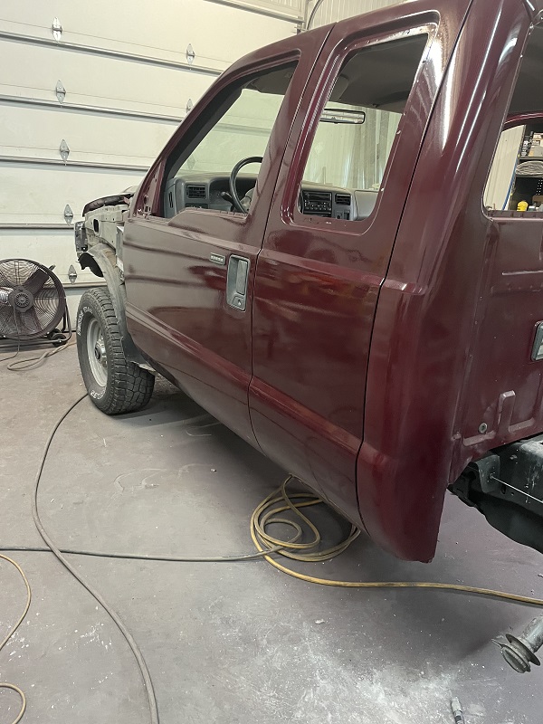

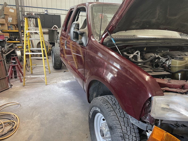

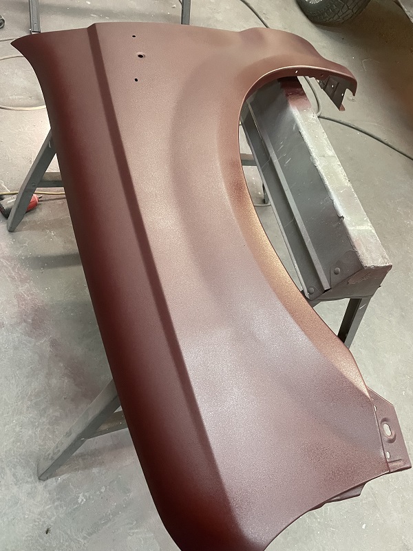

Feeling a LOAD better today.  After speaking with a PP rep and the guys here at the Body Shop that supplied my materials, for the last few days been hacking at the Left fender clearing off all the Crazed Paint, yesterday got that complete and sealed it back up with an epoxy primer.  Today I set to fixing the Lifted areas on Rt Fender the Cab Corner and repaint the Left Fender.  Used NO Reducer, per the PPG Rep.  Straight Paint thru my HVLP Gun, Same for clear once color was back on, NO reducing agents.
What went wrong was I have NO paint Booth, the materials are designed such that they are Used INSIDE a Controlled Climate Booth, Fixed Temp, Semi Fixed Humidity and Constant Filtered Airflow.  Same issue had painting the KW.
Today's results.
Cab Corner
Left Fender
right fender Hood line edge repaint
Edited by DMiller - 02 Jun 2024 at 4:31pm

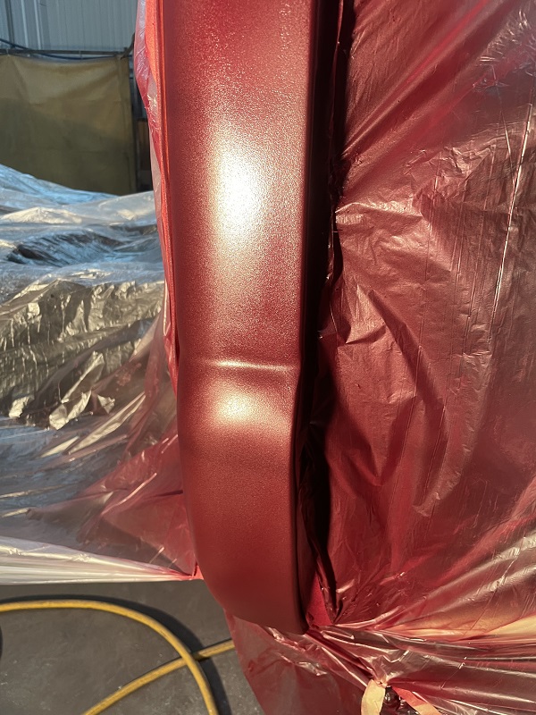

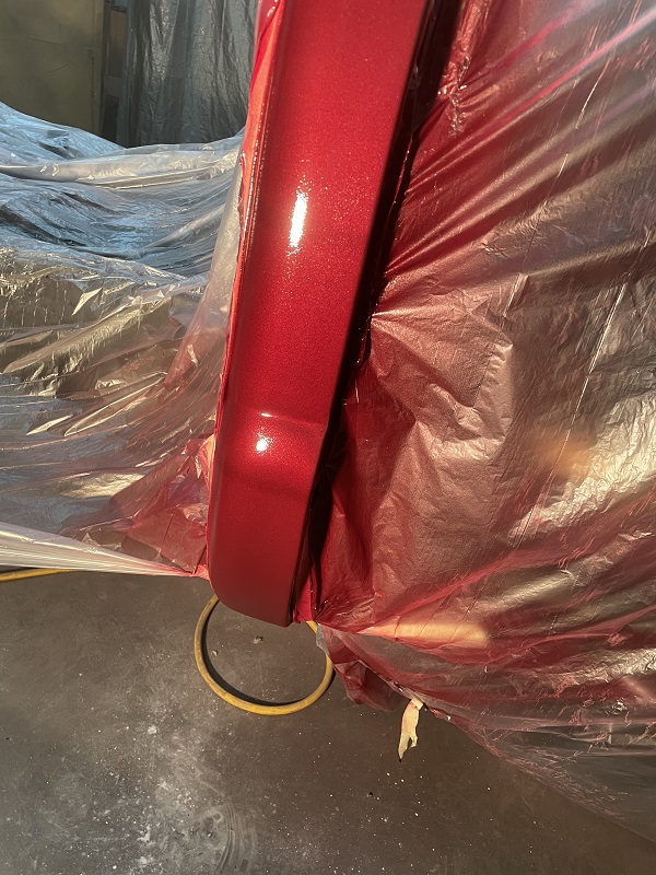

As soon as had the Second coat of Clear on
Allowed to Sit for an Hour, applied Third Clear WET Coat, pulled wrappings.    No Lifts, No separations, just DONE!!!  Corner is Artificially Bright as the Lighting I was using to actually SEE the work being laid down!!

The rep noted the Solvent paints formulas today differ from even ten years ago, most shops still have booths even for large trucks so can get away with Medium to slow Reducers.  Open Shops, Barns or sheds as I have are NOT conducive to paint work by his acclaim, even trying to limit dust or floating debris is about useless in my setting.
Showed him the paint Pops, he knew right off, Solvent Pop, noted with paint I received to Over Spray a repair area on fresh lain material(Under 2 months), NO reducer unless over 85 degrees otherwise the paint itself would flash far too fast.  Not having painted more than a few Lacquer jobs in the 70s then IMRON in the late 70s/80s into more enamel bases in the 90s, and this my first contacts with a HVLP for the KW and this I am completely out of touch.

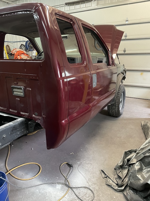

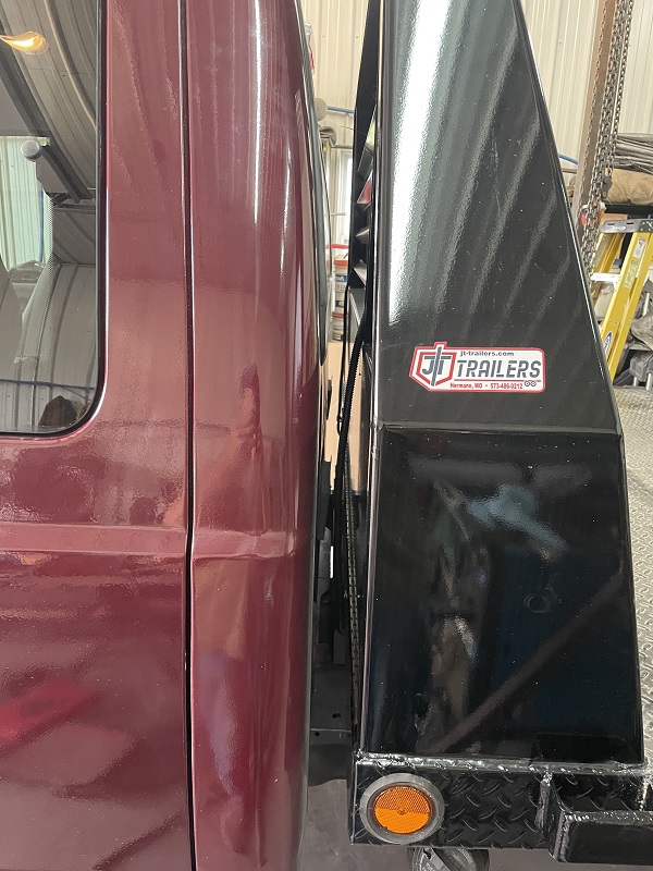

Worked all week, back at the pickup today EARLY.
Managed to Blend Buff RRr Corner then hung RRr door, adjusted on doors and installed latch works and hardware, BUNCHES of bump or scratch touchups ALL morning as nicked or caught a edge with pieces.  Had to run to town and get new hood prop cylinders, the Originals FINALLY said had enough.  Tomorrow more sand and buff spots, then install front door glass and operators, finish installing door speakers then Lower door panels the little pieces of Door splash seals on door bottoms and the between door seals and mirrors.  IF feel good of it may sand and buff on front fenders ready those to go on along with front bumper.
Still have seats to clean, floor covering to install and all the inside trim panels in back.  And as yet not ordered rear glass and the sealant for the Rear Side glasses.

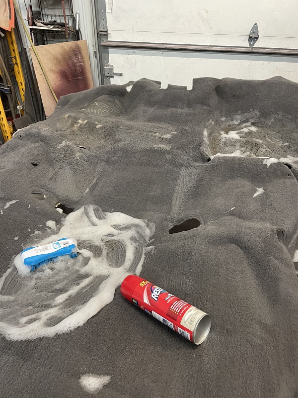

Spent the morning cleaning, Seats, old Carpet assembly, as the new floor mat is Not Worthy to go in.  May use it for something else but is just tacky.  Did assemble all the front door hardware, windows and operators, speakers, mirrors.  Got a little more cut and buff completed until shoulder said WHOA.  Carpet is down, started adding trim panels in front section.  Rearranged shop to situate the fenders on a pallet on sawhorses to cut and buff, easier on me!!.
Points: 36773
Post Options Post Options   Thanks (0) Thanks(0)   Quote DMiller Quote  Post ReplyReply Direct Link To This Post Posted: 16 Jun 2024 at 3:43pm
Entire last post disappeared, Started OVER!!
Last week a bust, Wife's Birthday and our 38th anniversary, Dinner yesterday at White Mule Rosebud MO.
Today back at truck, seats in, Fenders buffed as far as could tolerate on sawhorses, installed those where will go back sand and buff rough spots all around.
Added photo of Carpet Cleaning for last post.

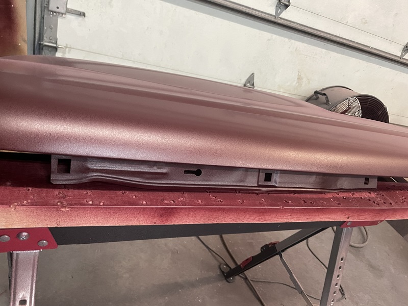

Was inspecting the replacement cab step boards, mounts will cover the tear drop and small rectangle holes at three of the four locations against birds and mice just not for wasps and mud dobbers.  Thinking will install the Aluminum tape I have and use for welding over those holes, maybe even cut up an old inner tube as a backing insulator.  Need to keep the vermin out and there is a fourth hole that I will need come up with some kind of covering.
Small round and ovals can use commercial plugs

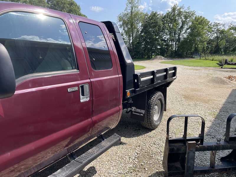

Post Options Post Options   Thanks (0) Thanks(0)   Quote DMiller Quote  Post ReplyReply Direct Link To This Post Posted: 30 Jun 2024 at 5:30pm

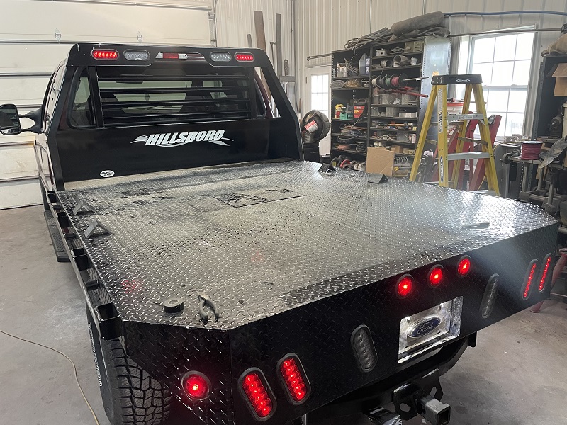

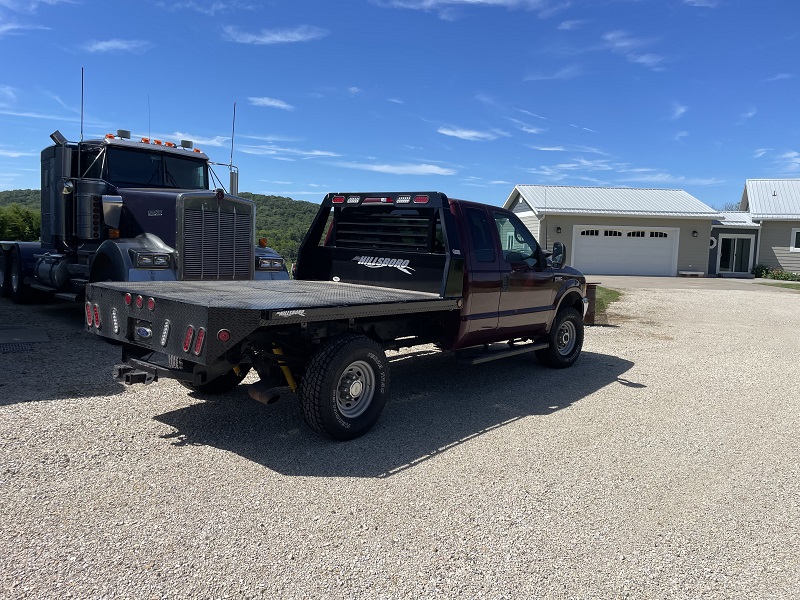

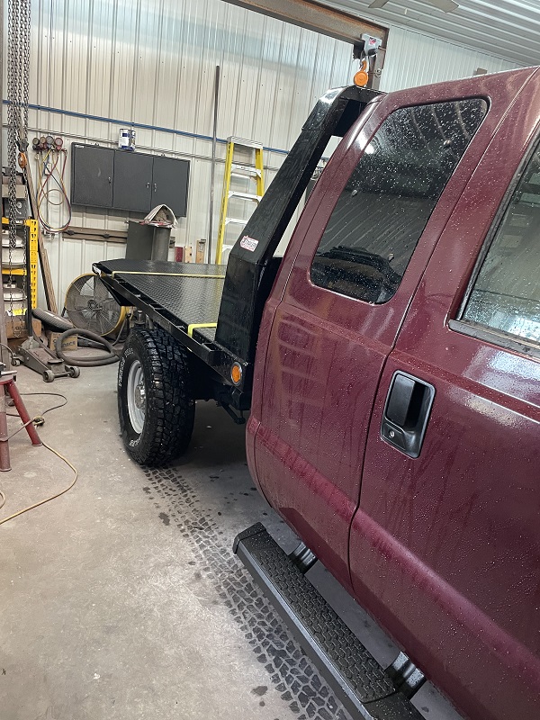

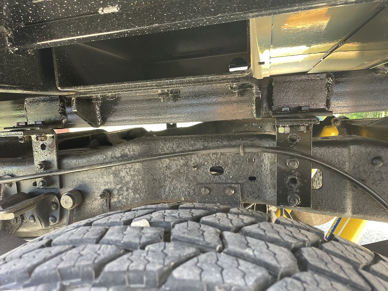

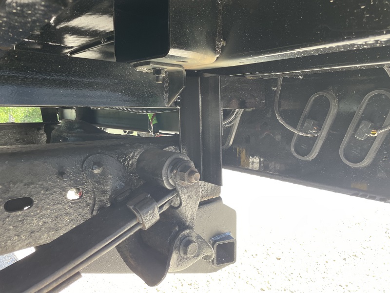

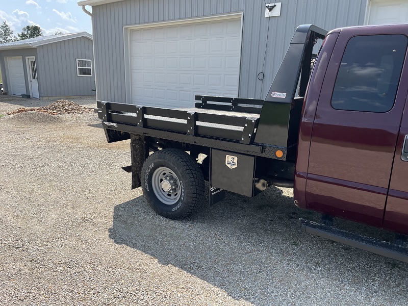

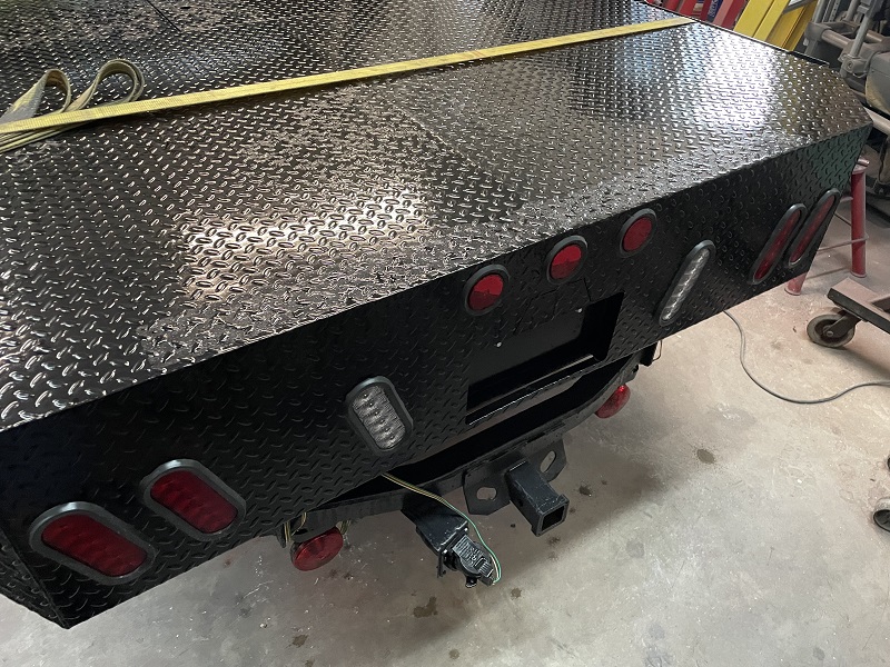

This morning, Bed came off with Aframe, rear crossmember removed and built new one from 3" to 2 1/2" and added 1" Angle to top of Front Crossmember to make a better stop, got all the under work done reset bed, the Off Angle is pretty well gone Cab to Bed..  Made Angle Iron attachments to the old Reese Hitch points, rear mount is 2x2 1/4" angle bolt to frame welded to bed.  Lights all functional but will add more resistors to the Taillights for TS to slower flash.  Interior is all back together, AC been evacuated over three hours and recharged, seems to be working fine.  Made up a Fuel Fill pipe support so that is done.  Still need to set Mudflaps, the right tool box and a few odds and ends as Side Boards but it is essentially Completed enough to use again.

Just under $15,000 as to investment. Still cannot/could not buy a replacement for what is in it and could barely make a down for a new one at that much. Extra cash on extra paint materials, bed prices moved up, a few more components in cab and engine compartment otherwise held to what planned to do.

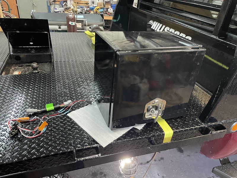

Currently building Stake Sides for the back, have added mudflaps and thinking may buy another tool box but are pricey, added resistors did arrive and are installed where TS are responding normal speed.  Also hung Spare off rack on 1" Square Tube support for easier access.  Final Pics in a few days as sides come together.

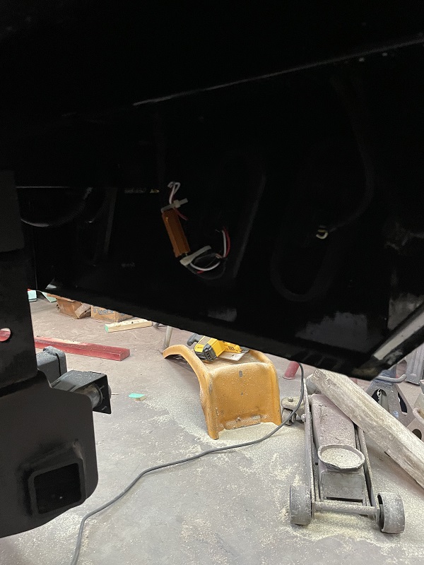

Post Options Post Options   Thanks (0) Thanks(0)   Quote DMiller Quote  Post ReplyReply Direct Link To This Post Posted: 10 Jul 2024 at 4:37pm
Have not built a tail or intermediate board set yet but working on how to accomplish as inexpensively as possible.  These are final results.
Spare Support
Bed Side Boards
Those include Fuel Filler bracket and the four Mudflaps.  Still need to Enganear a Rear Step but working on it.
Then one of Four Resistor sets

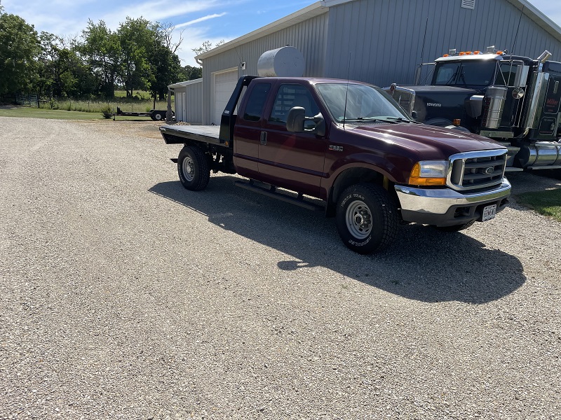

Thanks Guys, wish it had been a restoration, just a mass repair to keep it functional, if had not noticed already Baptized with mud from Barn/Feed Lot.  Scratches will continue!
