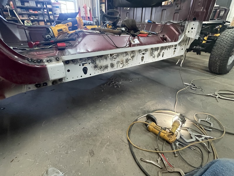

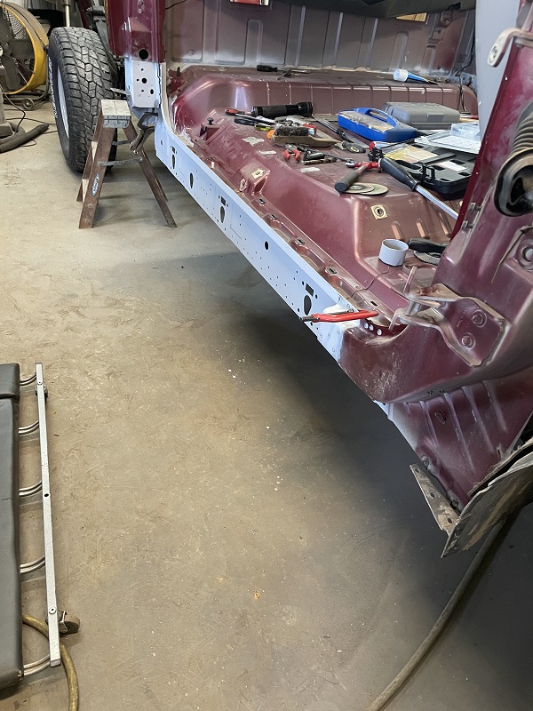

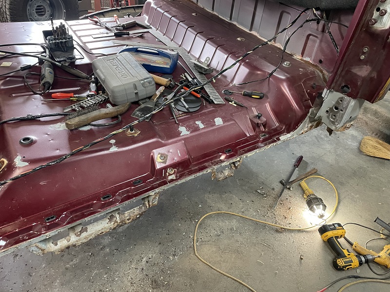

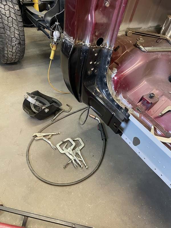

Having to allow the Slicin and Dicin to heal awhile before slip the arms back in the razor blade barrel.
BOTH arms look as that, snag heaven anywhere near edges.

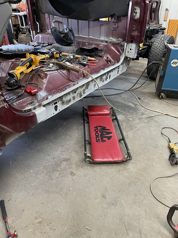

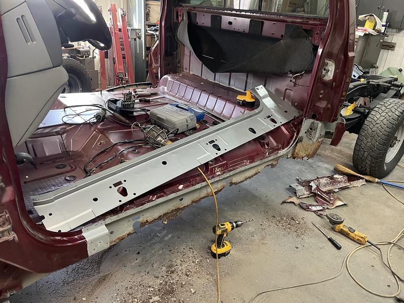

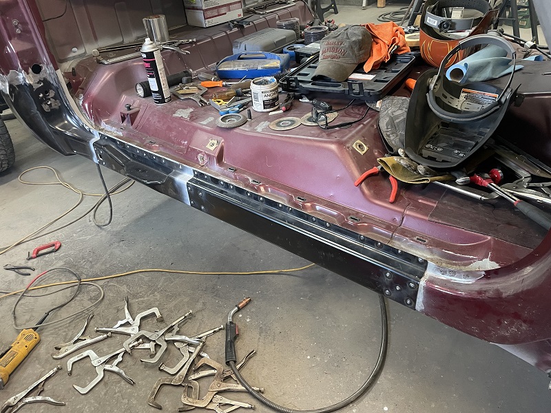

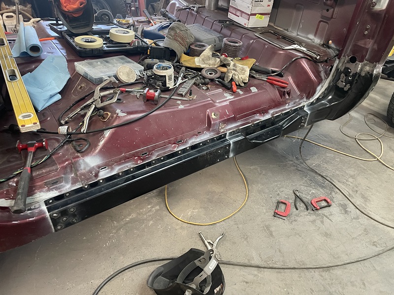

Latest and greatest news is the inner rockers are clamped in place, weld thru primer on them. Getting used to the fast melt of .023 wire is tough but should be welding some time tomorrow

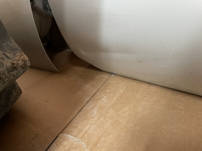

A other note, doors, went to site to order the four doors, got “Out of Stock For Foreseeable Future” on ALL. Had local body shop try Ford, no good on rears and front shells 6 weeks out are $1300 each.
Back to pc search found Decent doors thru a scrapper. All clean and no external rust or pop bubbles, off 2012 or newer but are same shells. Got all four for $2200 plus freight.
Are complete with all inner Panels and

What weld through primer did you use?

Seymour, was recommended by local body man.

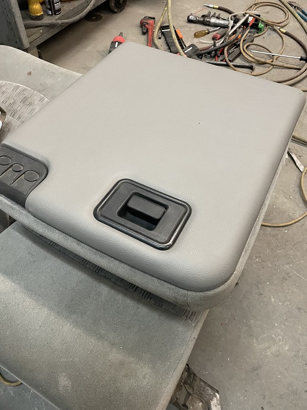

Both New panels fitted up, and did some experimenting with the .023 wire.  My Miller 210 does NOT like it but is welding, have the Left panel sewn in, just have to do some dress down and reprime.  Get the Right one attached and will start hacking up New Corners to fit up.  Still going to fight with the .023 for now, be the LAST time I use in this welding machine.

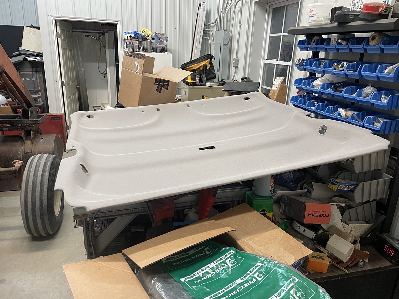

Yesterday the local shop does Upholstery work got my Headliner and Console compartment cover done, they are back home for $360.
Not a bad product. Try U-Pol in copper based spray can. I purchased by the case it was so favored.

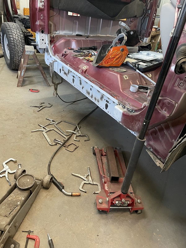

Got after the Inner Rockers, getting better on the ,023 wire in my machine, is a adjustment to use.
Inners are Both sewn on, will need to dress out some then prime over before move to cab corner caps then the outer rockers.

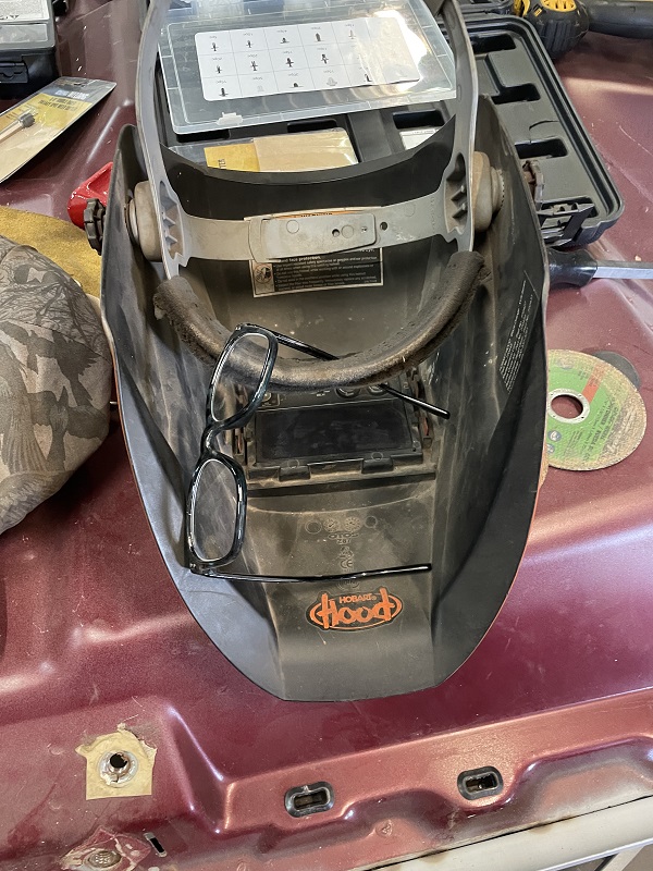

Welds looked FAR better when moved to wearing Cheaters under Hood.

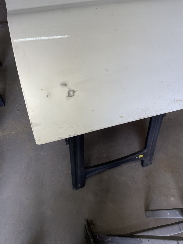

Door shipment to arrive today, Freight Company driver to call when around a Hour Out so have staged for that to pickup on a Asphalt or Gravel lot rather than the Mush that is here.

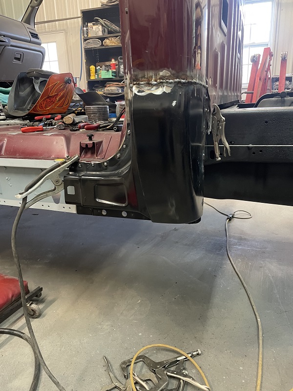

Made a Solid covering of the to be Covered face on the Inner Rockers, left the Weld thru Primer exposed and had masked that off prior to paint.  Have fitted the Left Corner well enough to initiate Weld, so went to the right side, still stretching out the outside rear corner some so do not have to fight in to align.  Once Both are fit up as best I can tolerate will set the first arc, is that no going back moment I dread Most.

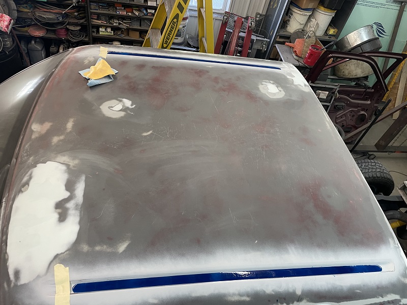

Soon as the welding phase is done will be back to cab roof body work and readying for epoxy priming all the new parts and body work.  Then have to wait on paint for finances to catch up.

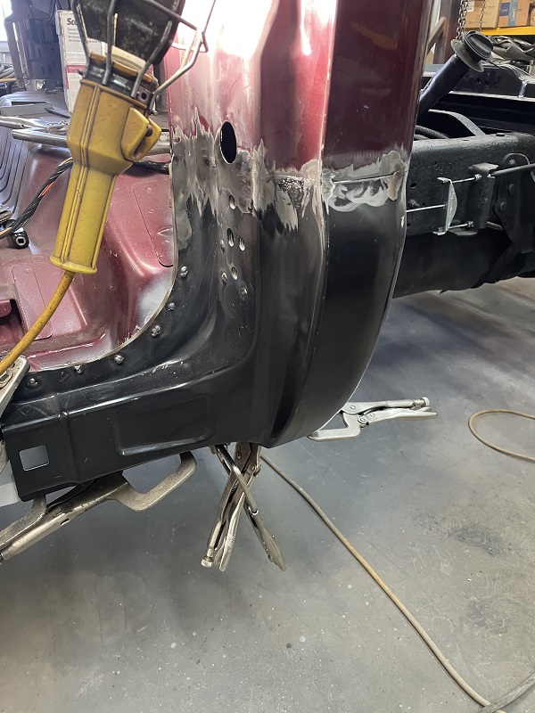

BIG Day today. worked up the courage to set the corners, been fussin and floggin on them for three days getting them to fit the way I see needs to.  So today anchored by All manner Clamping Grips, set the two.
Need to dress down welds, have to finish rear of Right Cap but had to attain a replacement Argon/CO2 bottle to continue welding.  Then can add in the Outer Rocker Panels and get to prepping, with plastic cover work of body work and priming.

Welding is Complete, since photos taken, ground off high spots of pocket welds and started sanding off the peeling material on the roof, working down the cab to self etch filler prime once get all the spot filling done.  Even trial fitted old door to check body lines.

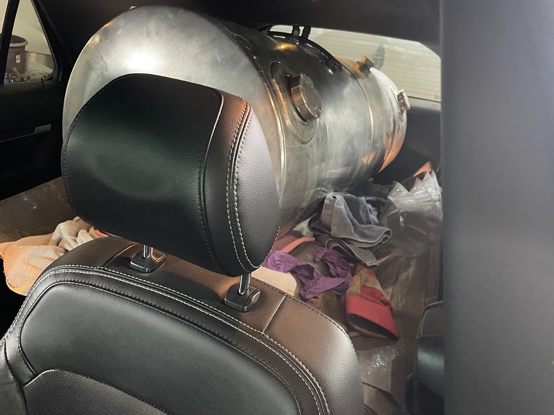

Wife none to amused with me as removed that seeping KW fuel tank, took to Car Wash and flushed as much as could remove internally, hauled it to Haslag Welding Krakow MO, 3-5 weeks will be Strapped and bad spots repairs.  Hauled in Her Explorer as the Above truck is a bit out of service!!!

Haslag called Friday, tank is completed.  They were quite surprised as I, NOT ONE TIME called to ask of progress and it worked in without concerns.  Is costly yet cheaper than the $1300 replacement fuel tank. $628, will be picking it up if happen to a Rainy day off this week.

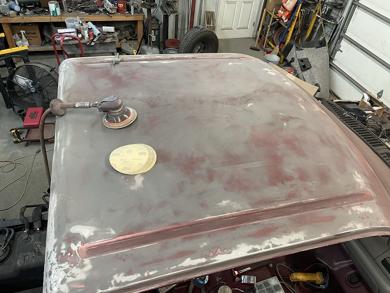

Getting there on Ford Roof, will post a later photo as the Channels have had the Seam Sealant removed and primed for today's activity of replacing that as was pulling away from the roof sheet allowing moisture to corrode the skin.  Body filler work is 99% completed on Cab and R Rr replacement Door.

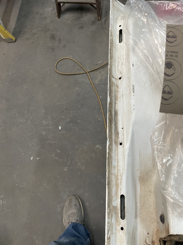

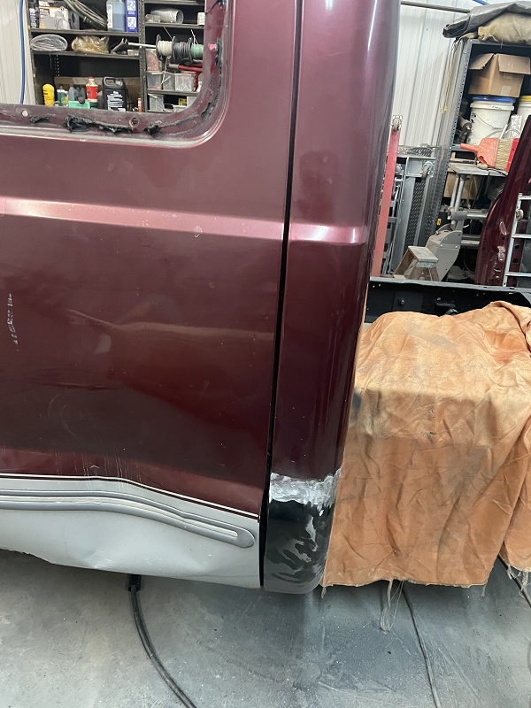

This is Today, Seam Seal on roof, door repair much better, and a photo of the bottom on rear doors.

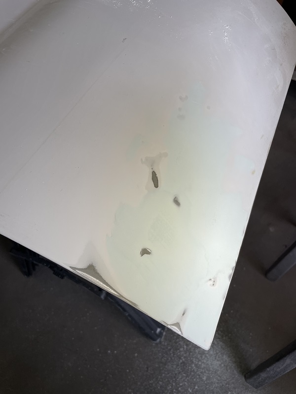

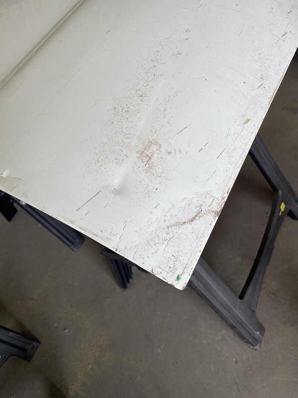

This was the door skin as Lifted the wrinkle and straightened that rolled corner.
