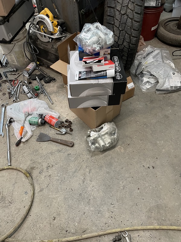

So MORE Bushel Baskets of parts!!  and have loaded backing plates coming.

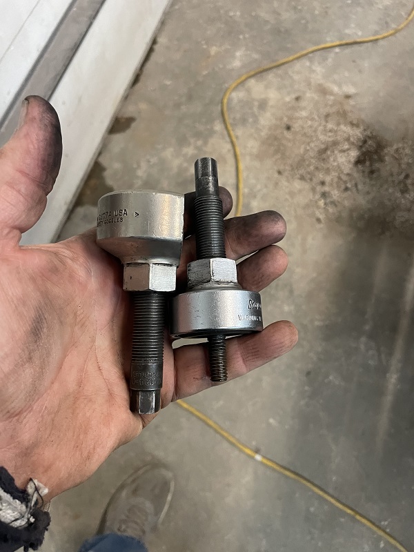

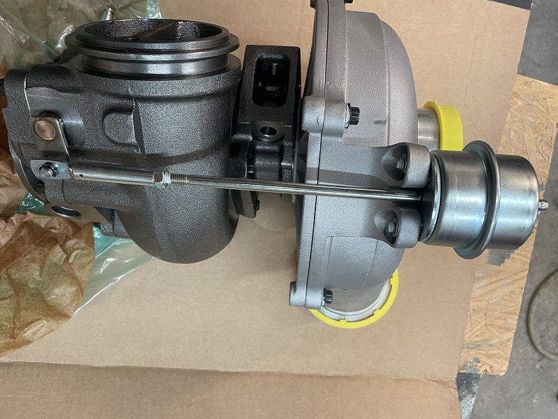

All but one PS Hose is here, PS Pump replacement is on and all but gear is drained of old PS Fluid.  New Tensioner pulleys on, and all cab mount bolts out clean.  Received the Taiwan made replacement Head and front TS Lamps, appear constructed as a Direct OE replacement.

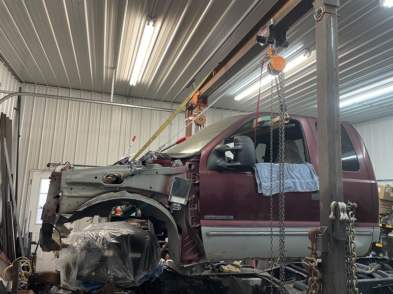

Soon as rear brakes are complete down to Bleeding and tires BACK ON, will set up to lift the cab for Turbo remove..
SO Glad kept my OLD automotive tools.

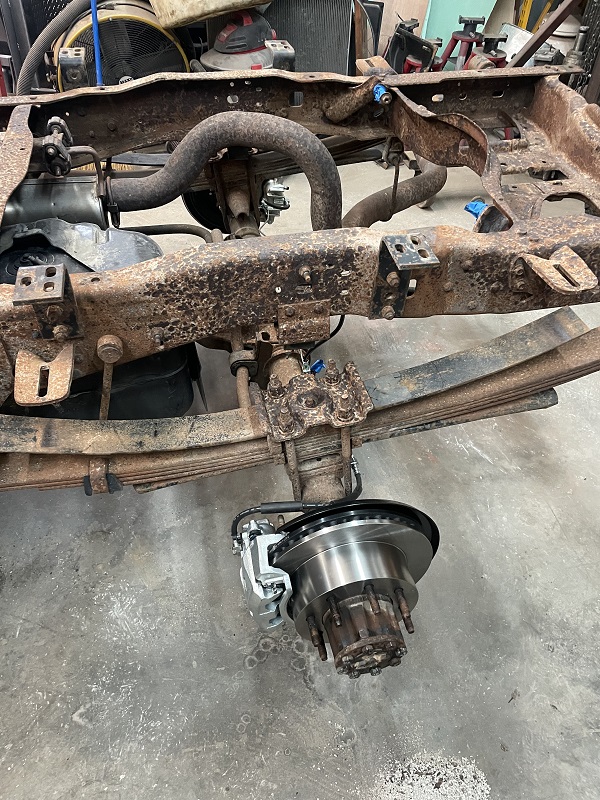

Rear brake assemblies and hubs back together, Brakes still dry and will be that way until cab is set back down.  Turbo is here but remaining pieces for that may be into Monday next week to arrive.
Will bag the two rear brake/hub assemblies, then ready to paint rear frame section tomorrow. After paint dries, will set next body mounting brackets and reset fuel tank, possibly install rear shocks and rear wheel park brake cables.

Are you Shure Brake calipers go on front of axle driver side? All 4 SDs of mine are on the back.
Edited by fjdrill - 25 Jan 2024 at 3:35pm
Points: 36773
Post Options Post Options   Thanks (0) Thanks(0)   Quote DMiller Quote  Post ReplyReply Direct Link To This Post Posted: 25 Jan 2024 at 5:03pm
99 and 2000 SD Fords only ones to do this. Same calper both sides, brake lines significant difference on both, is a heavy shield goes around the Left one. A True oddity to this model and year.

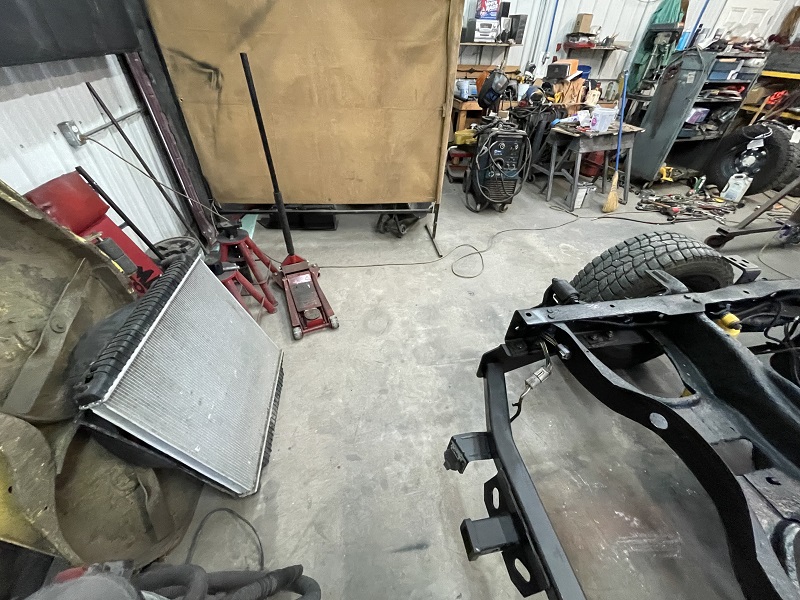

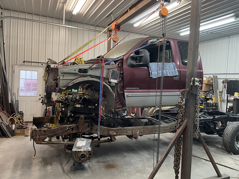

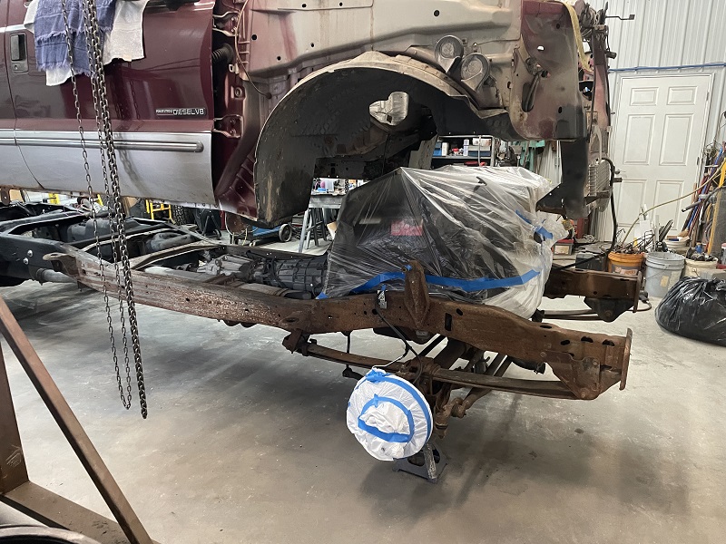

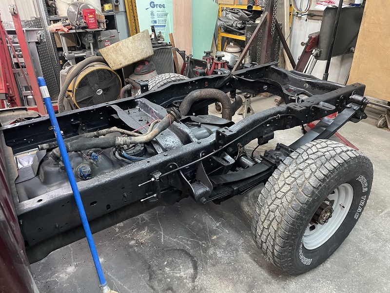

The truck as currently sits, too cold to spray so masked up what want paint off of and cleaned up around it.  Did Change out the ratchet straps to light Comalong winches.

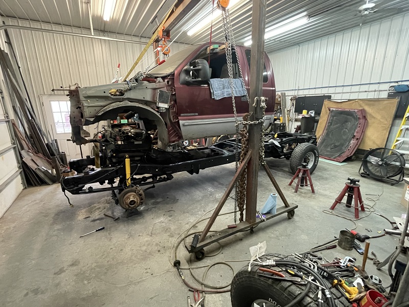

So today I lowered the cab back to the frame where it can sit unattended for next two weeks.

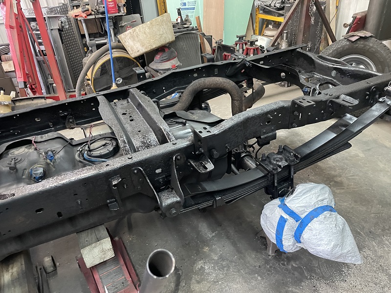

So Completed the Frame Paint, even sprayed rear hitch and reinstalled.    Had sat cab back down but raised back up today.  Had PLENTY of time so cleaned up floor around truck.

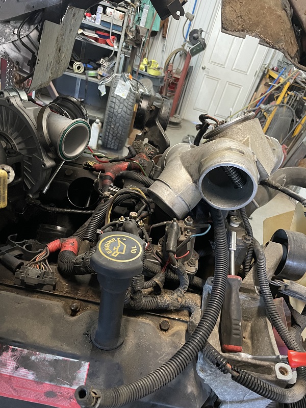

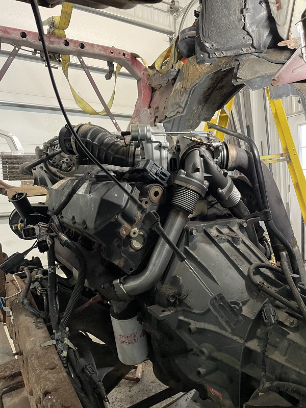

Under VC parts and Intake Boots is what is supposed to arrive.  Covers are still on but bolts already loose, Silicone Boots were leaking on X Piping.  That is Clean and ready to reinstall.

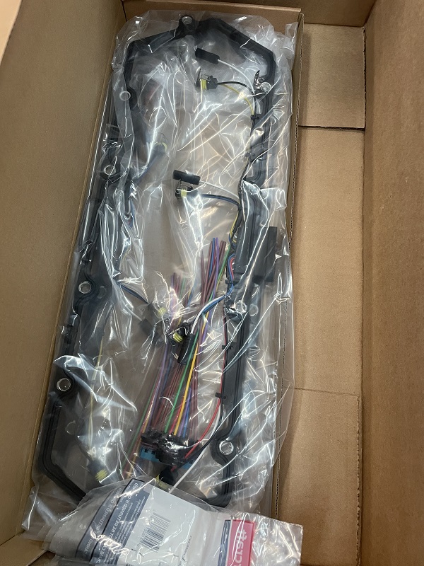

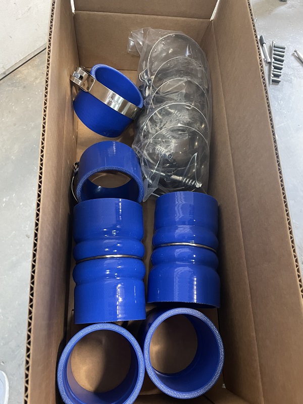

Almost TOO amazed.  Mail cam parts order in it.  Not ONE Scratch, Dent, or piece of damaged sealing tape, Label as crisp and clear as day was sent.  NO REASON was Not shipped.
All pieces in pristine condition
Guess means Back To Work!!

Above under covers parts fully installed, Cab is sitting on new mounts but had to stop and take care of Sick Wife.

Boots were a No Go item, too stiff, too thick and too sticky to slip onto the hard housing connections.  Reinstalled OEM for now until figure those out.
That said got brake leaks where were occurring sealed up(MANY), managed to get all the base engine compartment materials set and had engine running today, no leaks to note and turbo spooled into service just fine.  As to the Brake leaks, the New SS Tubing requires a LOT of Brute Crush to get the Double Flares to seat out, got that from my brothers who have also used them.

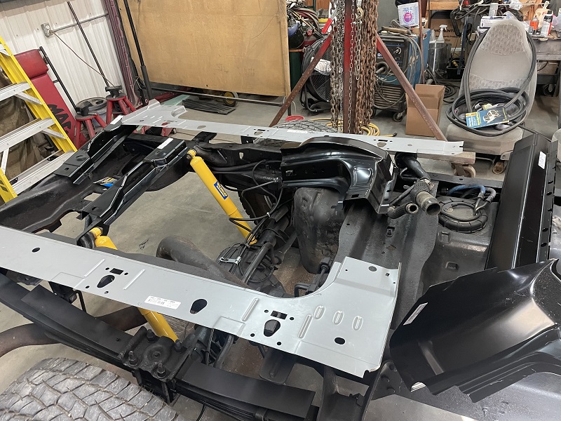

Into Body stuff now.  Tins arrived

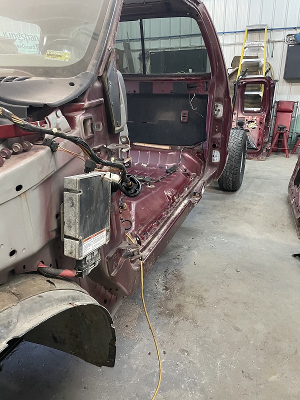

Have gotten all the rusty panels off the Left side now. Photos I have on the phone just not downloaded yet.
Some dressing work on previous spot welds, and must have been 200 of them on Left side, then predrill new Inner Rocker for MIG welding in place, Weld Thru Primer on as much as can cover then weld it up.  First back on will be fit up and install Corner, then Rear Door threshold, then the Forward Door threshold.  Then move to Right Side repeat.
