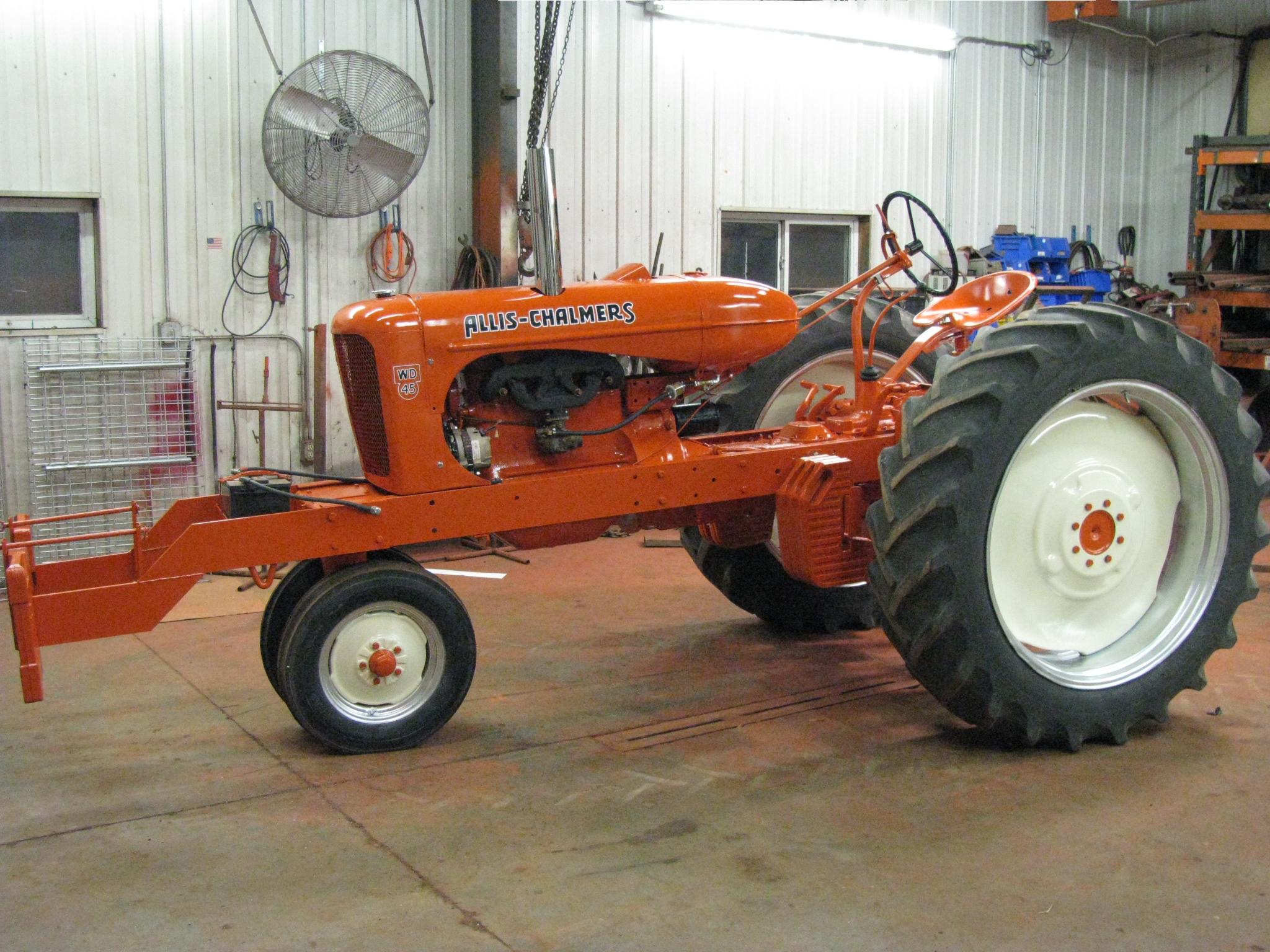

Here's a pic of my WD-45 with some free 15.5X38 tires I scored, I cut the 9 bolt pattern out and welded an 8 bolt repair center in, the regular 5-15 fronts.

Who sells repacement Rc rims? can't find them any place. I was thinking about having a set of " c " front hubs machined to fit the wd front spindle or have the spindle turned down to fit the smaller hubs
firephight View Drop Down
Joined: 16 Sep 2012
Location: st.louis
Points: 320
Post Options Post Options   Thanks (0) Thanks(0)   Quote firephight Quote  Post ReplyReply Direct Link To This Post Posted: 01 Apr 2013 at 9:28am
what were these rims originally on?

those rear wheels were some light pressed steel 9 bolt wheels that have been on the farm here forever used as duals on a small tractor for seeding.  The centers were torn up, and I had bought a real nice set on an auction so I used the junky set for the Allis and moved the centers for a 60" tread spaceing when put on the WD-45 and welded the 8 bolt repair pattern in.  They are from a John Deere, but I don't know what.  A trip to the sandblaster and the tire shop, some new tubes, switching 2 pairs of tires and a pile of my time.
I never weighed the fronts, but I know the narrow front I took out of the WD-45 is HEAVY.  That tractor pictured weighs about 3800# with no weights and a 190# driver on it.  Nothing's stripped off, and just a little added weight for the front and center weight brackets.  We don't have much around here for light classes, most places start at 4500# and up, once in a while there's a 4000#.  The tracks are hard enough that you need to add the weight to the front anyway.
