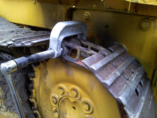

FWIW, I used a Harbor Freight ball joint press that I picked up for $20 and it worked great for the HD3 as the opening in the press is just the right size for the pins. I used an impact socket and 3' breaker bar to turn the bolt in the press until I couldn't budge it any further, then hit it with a hammer a few times to budge it a little before tightening the press again. Here's a photo so you can see what it looks like.
Don in WA.

now that harbor press will work good also. thanks for the pic. randal

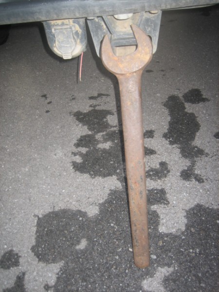

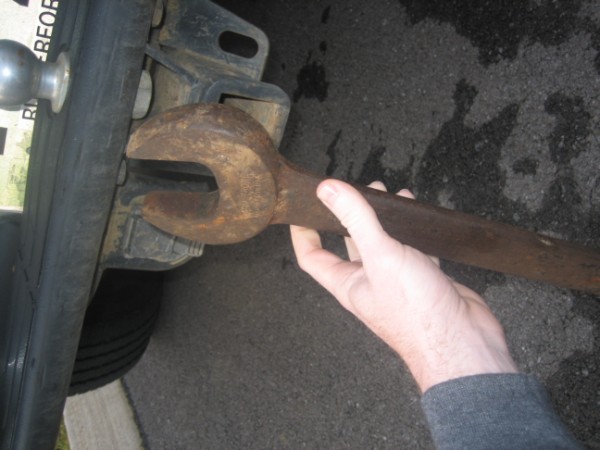

 Heres the wrench i got to modify to a track adjuster wrench. It's pretty heavy and since it's just plain uncoated steel it should weld good.
 The time i had set up to look at the parts machine the guy said he would sell got pushed back to 3 this afternoon so i'm still not sure what i have found. The last phone conversation left me thinking this may not be quite as complete as i first thought. I guess since the guy has multiple running machines that he fixed up, i should have counted on some things not being there lol. I'll see whats there and report back this evening.

that wrench with a cheater pipe on it will help !

 Yea Randal, it seems to have been designed with that in mind.
