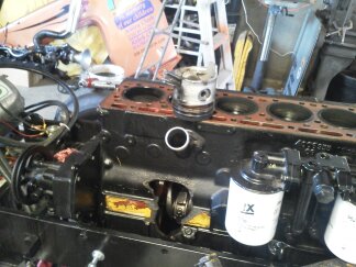

MINE AT 60 PSI

I'm going to run hx35 u made me nervous with pic

If your connecting rods are properly hardened you will not have any issues no matter what turbo you choose or what the boost is. Be sure to use new rod bolts when you assemble things. If you run the HX35 with the 12cm exhaust housing and the gate tied shut you will see 45 - 55 lbs. of boost. That should be just fine with your hardened rods.
Bob, you had the HX35 on yours when the connecting rod failed if I remember correctly.
