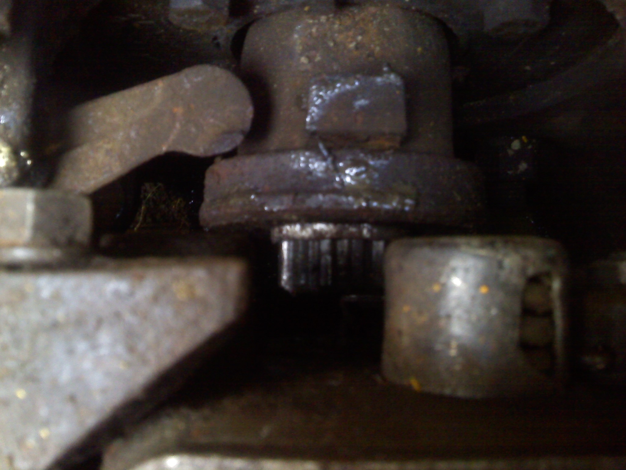

I'm on to my next project with ol' Alice and I have a few questions before I get too far: Is there an "axle" that connects the rear sprocket to the ring gear cluster? Forgive my lack of proper terminology; I'm used to working on cars. The reason I ask is because I can turn the left sprocket by hand. I took off the sheet metal that covers the brake band housing and can see things turning when I rotate the sprocket. When the dozer is running, it only wants to turn left because only the right track has power to it. I'm wondering if anyone has experience in this department and can point me in the right direction. My guess is that if there is indeed an axle, it is broken or the ring gear limited slip cluster needs to be rebuilt.

Thank you all for the responses so far. My manual has been copied so many times that it is hard to tell from the pictures what anything is... The sprocket turns by hand and is turning the steering clutch but is not turning the gear pack inside the center housing of the final drive. I'll pull the cover tonight and look to see if the shaft has worked it's way out of the splines. Keep those suggestions coming!

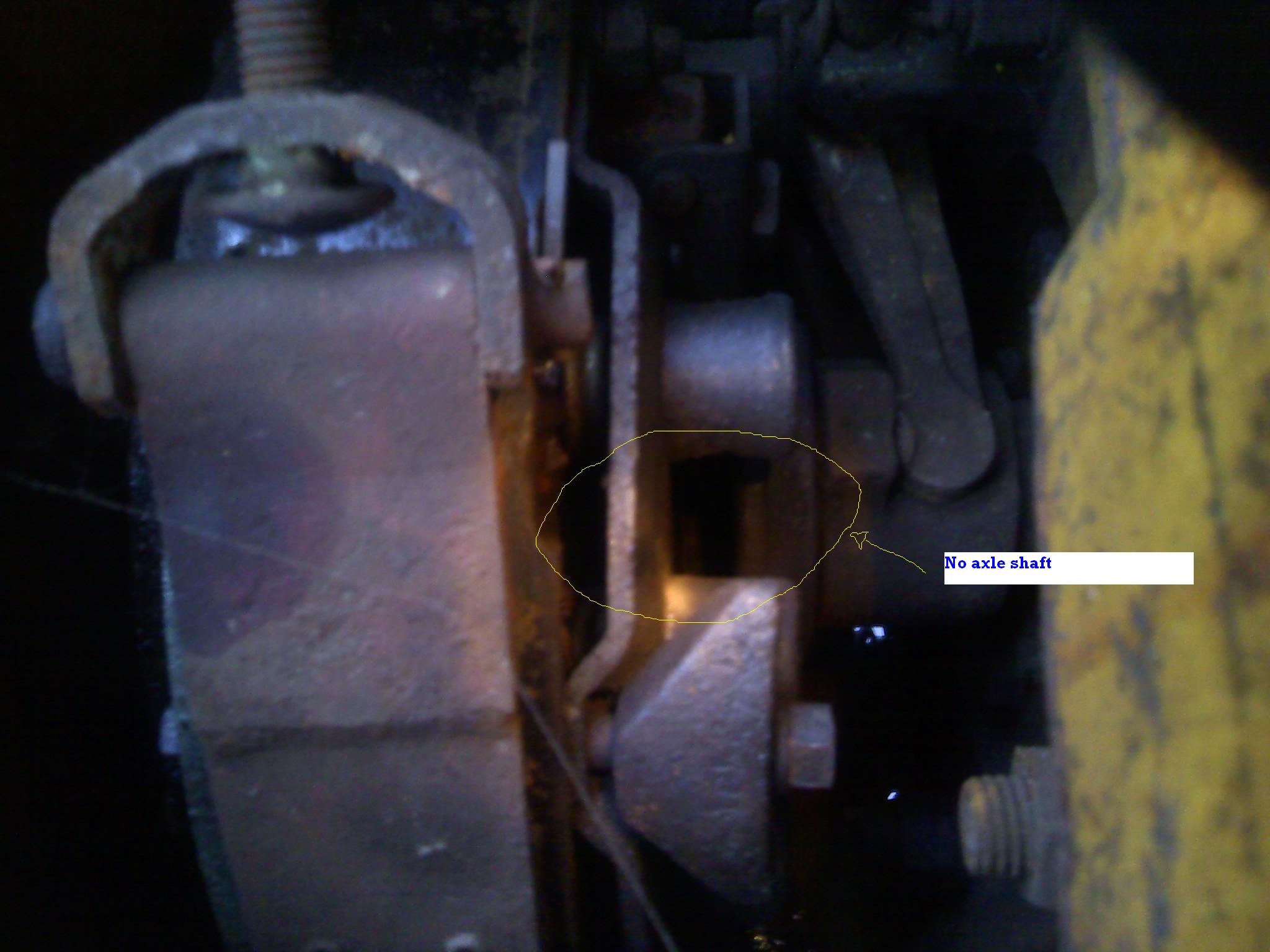

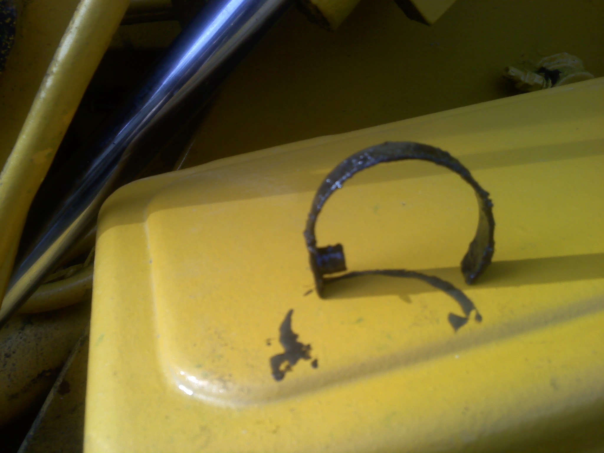

Kip and I spoke on the phone and he mentioned using a flashlight to peer down behind the steering clutch pack to see if I could see the axle turn. It appears that the axle retaining clip fell off or broke and allowed the axle shaft to work back into the center housing gear assembly (rear end). It's worked its way back into the rear end so far that I think I will need to take off the left side brake compartment. I don't know how else I can convince the axle shaft to move out into the steering clutch pack. Any suggestions? Here's a picture of what I was looking at earlier.

Use a strong magnet to see if it will pull it back out. If it floated in, it should be able to pull it back easily. You're gonna need that snap ring to hold the axle. It should be put into the middle hole.

I wanted to post an update. I was able to remove the fork that slides the throwout bearing, allowing me to slide the throwout bearing far enough to get at the axle shaft if that makes sense. Thank you everyone for your help on this. Hopefully this helps someone else as well.
