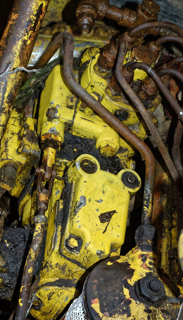

From the numbers on your pump in that first photo
PSB6A 90EH 4363
From some notes I made when I had the HD 11 service manual
90EH says a 9 mm plunger - Allis  also used 100EH with 10 mm
That pump number says  516G engine above #95455
Or it mightn't
Should be 4363A and it looks like your number  has been over-stamped so maybe a pump change/recondition somewhere along the line.  If the second digit was an 0 then it could have been 4083 which went with HD 11B, F, S
The tag on the head gives the head part number.  If it has an R in it the head was reconditioned
Edited by Ian Beale - 03 Dec 2018 at 5:46pm

Ronnie
I've just been looking at your pump photos on Page 2 and I hope I'm wrong for your sake.  Go to the third one.
The filter you can see is the primary.  Diesel feed is from the tank, through it, then to the transfer pump and through the secondary to the injection pump.
The hexagon at the back of the head section just in front of the rectangular cover of the top of the govenor section at the rear of the pump is the stud with the square section O-ring.
Then just above it on the back of the head is a brown fuzzy area - which is where the fuel feed hose from the secondary filter is supposed to connect to the head.   The other end of that hose  should connect to the T-fitting from the front of the secondary filter which is just shows in the photo.  So the head has been open to the weather since Joe Fiddler left it.
And if the hose that is clamped on that T fitting comes from the diesel tank then it is connected so it bypasses both filters and the transfer pump if the hose to the head was connected.  All this needs checking though.
Would it run like that?  We first started the engine from our grader on an engine stand with a temporary tank.  It did have the plumbing correct but the "reconditioned" injector pump was missing the bottom O-ring for the head so it had a massive diesel leak to the sump and less than design transfer pressure.  It ran like that.  So I guess the answer with yours would be "maybe" - but I doubt it would have made much power.  What would have been fed to the pump as well as diesel if it did doesn't bear thinking about.
IMO the pump is your first port of call.
Today's 2 cents worth

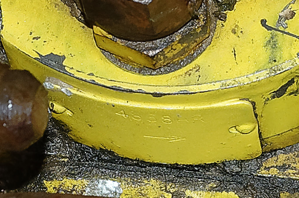

Here is a close view. Hopefully you are not looking at these on a phone lol
I think I see what you are saying. The hole on the head should have something in it besides rust or mud. So they left the system open which doesn't surprise me one bit.
Oh and I also seen a number on the head. Looks like there is a R stamped in it.
First the small one
Still large but I had to make it smaller than I wanted to meet the 2mb requirement.
-Hole I think you are talking about
Ian Beale View Drop Down
Joined: 03 Oct 2011
Location: New South Wales
Points: 1020
Post Options Post Options   Thanks (0) Thanks(0)   Quote Ian Beale Quote  Post ReplyReply Direct Link To This Post Posted: 04 Dec 2018 at 11:48pm
Ronnie
That is the hole.  The detail of the first one was ok after I went and had a look at our grader and was reminded of where things went.  IIRC that port feeds in below the head but that is where the plunger and the gear train that spins the distributor block are so water and /or dirt wouldn't be your friend.
Assuming you can find that missing hose - I'm not sure what the hose material is called.  It is reinforced and what we get has a blue fabric outer.
The head number on one of our pumps is HD 4606AR, which should be an EH 100.  (Correction to previous - 10 mm and 9 mm diameter plungers).  The other one (that works) has a damaged plate.  There is a little spring clip in the plunger area that (IIRC) holds the plunger tappet in the assembly.  You need to be gentle taking the head off or it will get damaged.
If you set about taking the injectors out the thread on the end under the dust cover is 22 mm,  don't remember which thread number.  A piece of our 3/4 water pipe was just right to make an adapter.  I could use a slide hammer as they are out in the open (well relatively) on the grader.  Someone else had to make a puller due to restricted room on the loaders - in an earlier post(s).
I have a .pdf that  lists many of the head numbers - from September 1976 so not much use to either of us.
In case of the worst might be worth finding out if Hector Gemme (Spelling?) who posts here has anything - he had a wrecking yard up in Canada
Later - those injector threads  are 22 x 1.5 mm
Edited by Ian Beale - 05 Dec 2018 at 1:48am

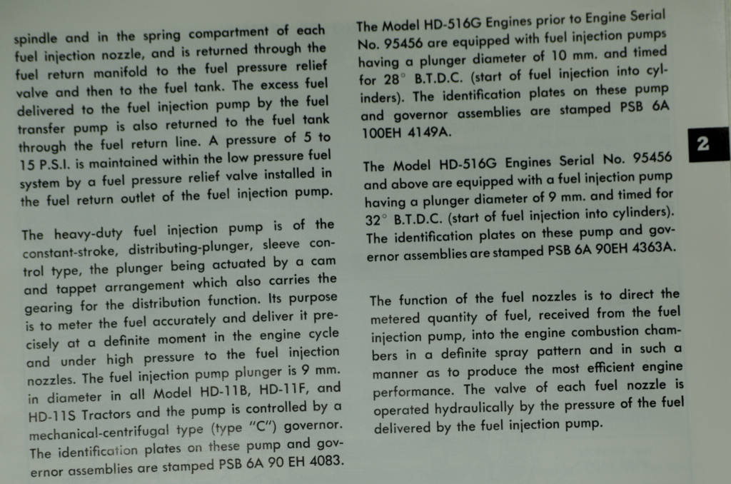

Ok came in for a quick break. I picked up my service manual. I'll post the actual contents of the pages later but from a short read they used 3 different pumps. The 90eh has two different timings 28 and 32 and the 100 has 28. Depending on engine serial number. So it appears any can be used but if I remember correctly the one with 32 was to increase the HP.
According to the SM the engine tag is supposed to be near the starter hopefully it's still there. Publication date is June of 58.
AC Mel I can't thank you enough for helping with the service manual :)
Obviously further research is needed before I attempt to change or fix anything.

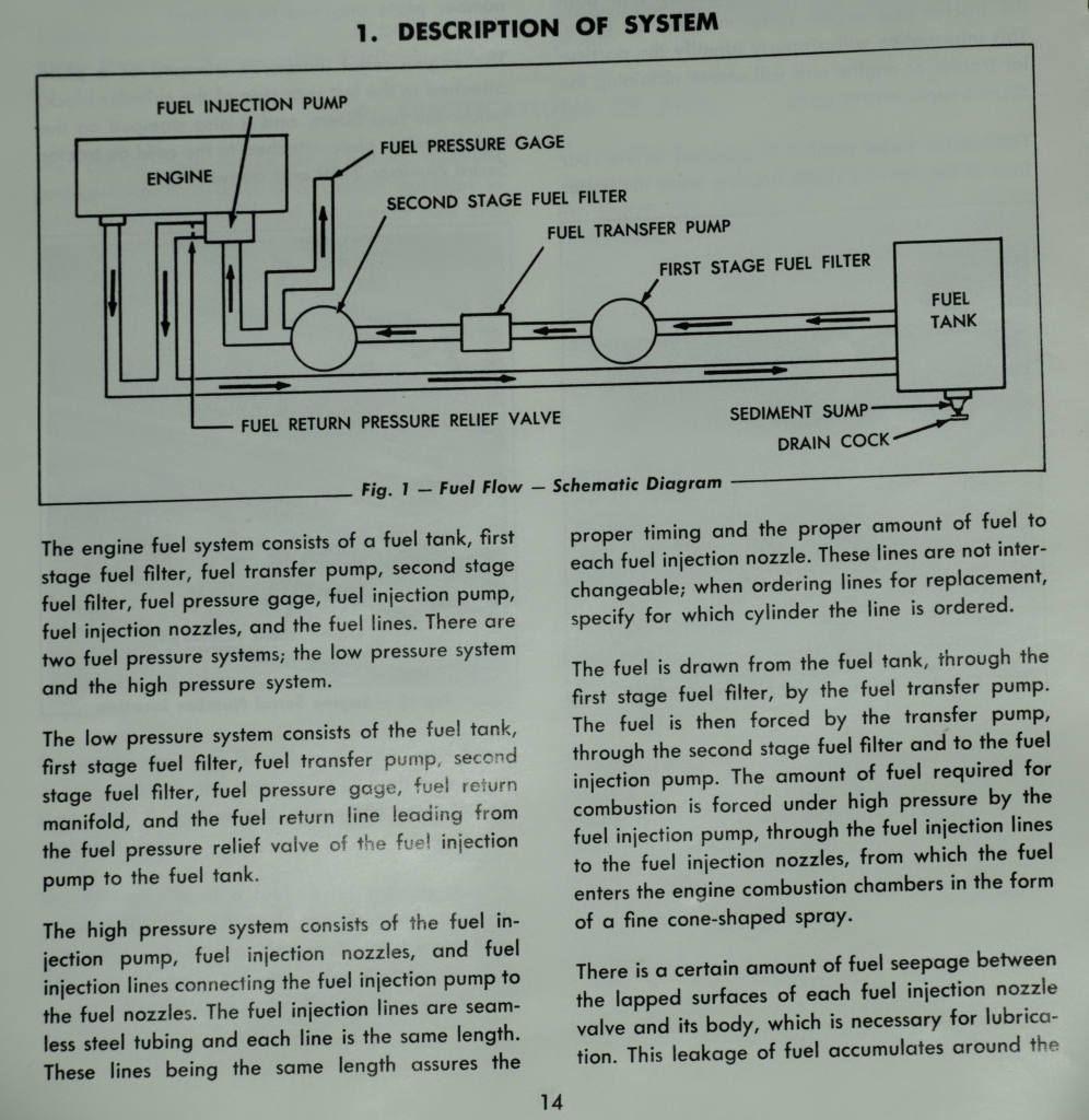

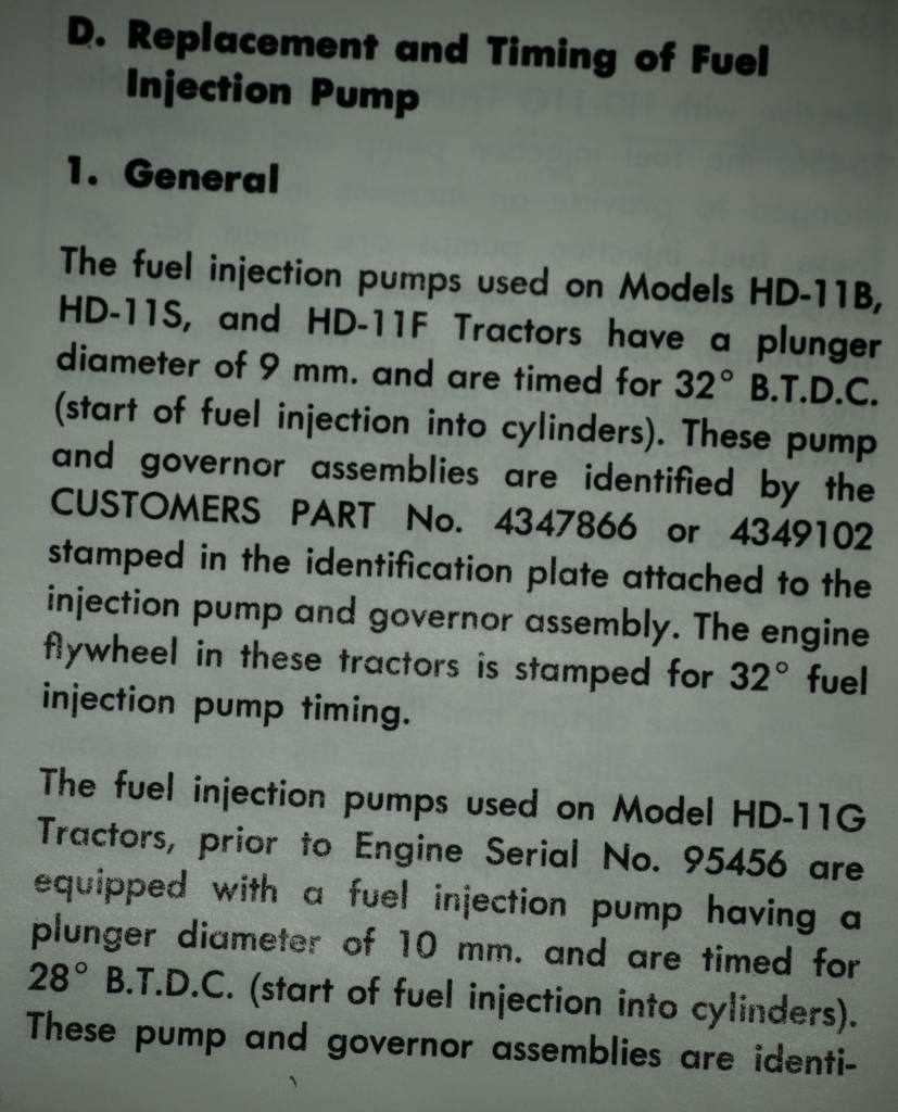

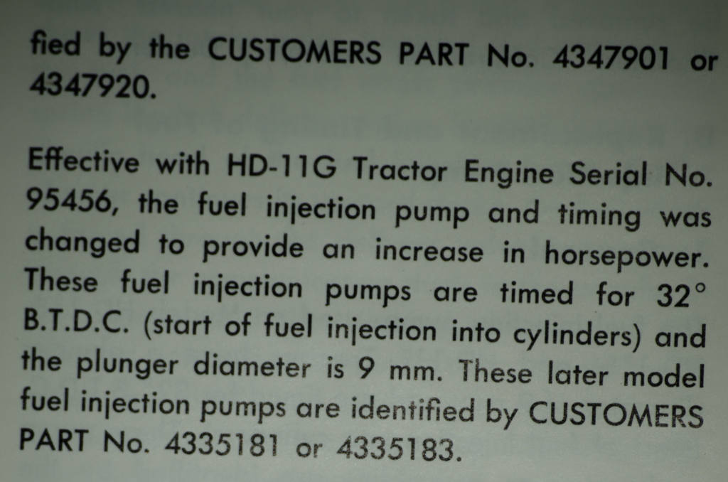

So here are 4 pages on the fuel injection. Hopefully this will help someone besides myself.
Joined: 03 Oct 2011
Points: 1020
Post Options Post Options   Thanks (0) Thanks(0)   Quote Ian Beale Quote  Post ReplyReply Direct Link To This Post Posted: 06 Dec 2018 at 3:16am
Ronnie
I'm guessing covered in there (but not stated) is the change from Budas with Lanova injection to direct injection with the 10000/11000 series engines.  (Lanova ones have the injectors on the lhs of the engine and "energy cells" on the right).
Just looking at that list it looks like early ones might have had 9 mm plungers at 28 degrees.  The graders had 10 mm at the same timing.  Which seems to make sense as they would have needed more fuel to keep up with the supercharger.
IIRC the later direct injection ones  got similar horsepower to the supercharged Budas without the blower, turbos even more.  Seems some then used the blower drive pulley for the fan etc

Yeah I don't remember when they changed engine design. I do remember that they changed the piston. The newer one was more/deeper concave. I wonder if this allowed a bigger cam to get more Mixture into the cylinder, maybe they changed the duration of the valves. They had to of changed something else in order to compensate for a larger combustion chamber. I have to look but I don't think they increased the liters. It's still 8.5L. You can only do so much with 516 cubic in. and 8.5L before having to go bigger.
I am curious on your grader what is the injector pop off pressure? This one says 2100psi new, used is 2k.
Now I am really curious about the pumps as well. In the 10mm plunger did they keep the same stroke of the plunger or did they shorten it? In non forced induction systems I am thinking they would have to shorten it to keep the same mixture. Or is the amount fuel delivered controlled by the volume of the head?
Seems to me the heart of a diesel is the injection pump, needs to be in a perfectly healthy condition.
I realize this is getting into the very technical aspects and some of my questions may seem trivial but it really does help me understand how all this works together. I am not trying to reinvent the wheel just want to understand the how and why of the invented wheel.
One last thing according to the re-stamped pump# on my engine it's the 9mm @ 32 degrees. It looks like the original number may have been for the 28 degree. Right now I can only assume the 9mm pumps are interchangeable with the only difference being the timing gear.

Originally posted by Ian Beale Ian Beale wrote:
2100/2000 psi
For what went on with stroke in the pump I guess you'd need an AMBAC parts book or two pumps to compare
I did catch something today when I was reading this again
In the diagram it's called the control sleeve and somewhere in there it said something about it controlling the amount fuel, not pressure but the actual volume.
So many questions and nothing to compare to :(
You have a couple of old pumps you care to mic? lol
This is kind of specific to design not sure if I can find specs this detailed.

Likely an Ambac 100.  The injection lines come off the head at an angle.  I've heard of that possibility.  But also that the parts situation is heading south.
Also worth reading about them
If you can replace an AMBAC 100 with a Bosch A series inline then why not a PSB replacement for a possibility?
I vaguely remember seeing something about some military 516's having Stanadyne pumps too - no details

Originally posted by RonnieJones RonnieJones wrote:
Control sleeve chamber
It would be interesting to know what the volume difference is between the 90 and 100 pumps.
If it's possible to make this chamber equal
Are the control sleeves just a different size
Can the control sleeve be changed
Anyone care to mic some dead pumps :)
Think you'll find that it is the position of the spill sleeve that counts and that it varies the spill cutoff depending on govenor control setting
Steve AD
You can do the inline swap on a 8000 426 because the pump drive you need is on a 7000 426. Doubt there is a half speed drive for that old bird.

Ronnie
The AMBAC pumps run at engine speed.
Also looking at the photo of your oil cooler shows oil pipe fittings from a very early engine.  Later ones used different oil pipes or hose.
Those fittings would indicate that the oil filter has bell and filter element above the base where with later ones it is below.
Edited by Ian Beale - 08 Dec 2018 at 2:11pm
