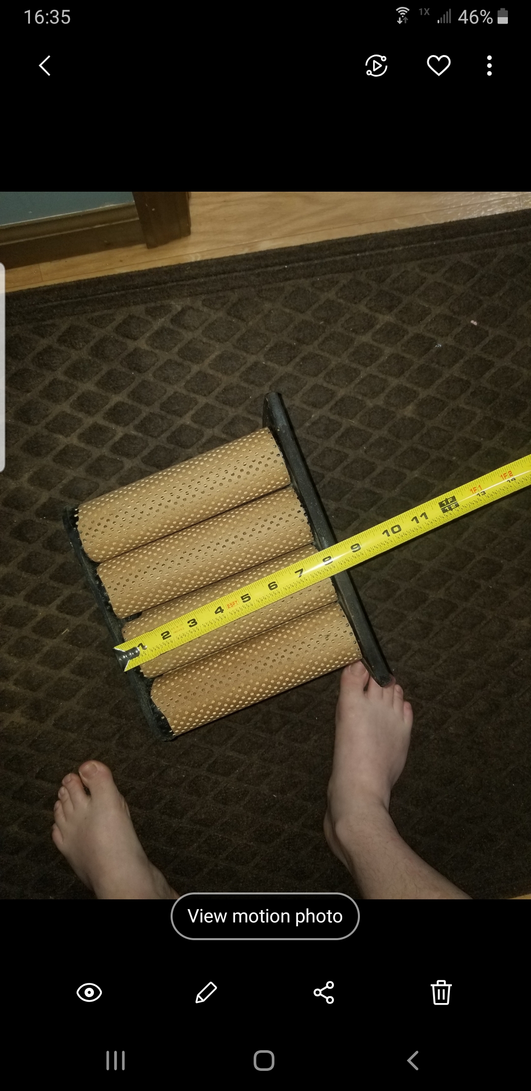

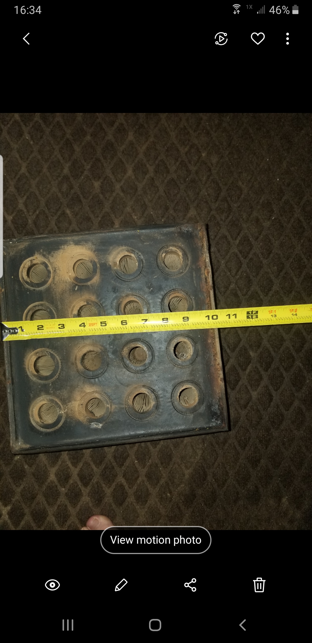

I am new to the AC family. This is my first ever post, I'm a bit behind the times. I recently purchased a AC-HD11 dozer (tractor serial# HD11E-6131, engine serial# 11-6054. I'm trying to find a part number for the air filter. I have looked through parts manual with no luck. The filter is square with 16 round tubes. 10 5/16"w× 8 1/4"tall. Tried to upload pictures but not sure exactly how. Thank you for any for any information you have. Also could anyone tell me what year it is I think its between 1960-1964 not real sure.

Post Options Post Options   Thanks (0) Thanks(0)   Quote 05ecofire Quote  Post ReplyReply Direct Link To This Post Posted: 17 May 2020 at 4:00pm

Thank you very much for the information. The baldwin website link you sent me is packed with information. Unfortunately neither of the filters are the same dimension as mine.

Post Options Post Options   Thanks (0) Thanks(0)   Quote 05ecofire Quote  Post ReplyReply Direct Link To This Post Posted: 17 May 2020 at 9:42pm
Thank you. Unfortunately neither the pa1775, the pa1806 will fit my filter box
Lazyts View Drop Down
Joined: 05 Feb 2012
Location: Manitoba
Points: 632
Post Options Post Options   Thanks (0) Thanks(0)   Quote Lazyts Quote  Post ReplyReply Direct Link To This Post Posted: 17 May 2020 at 10:08pm
it is likely the original oil bath filter was replaced with the square type, likely not from an HD11 at all.  The first dry cleaners on the HD11 were round, the square ones started in 1964 at serial number 10000.  1960 model year by serial number.

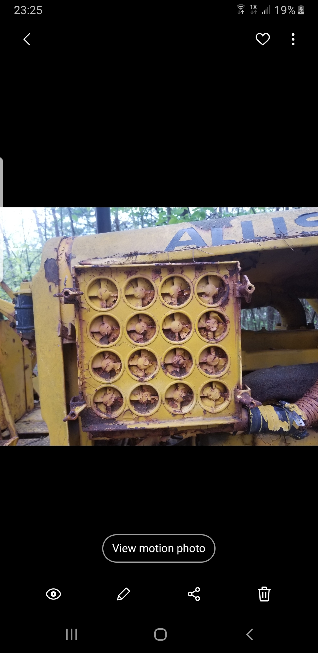

AC Mel View Drop Down
Joined: 23 Jan 2010
Location: N.Ca.
Points: 1189
Post Options Post Options   Thanks (0) Thanks(0)   Quote AC Mel Quote  Post ReplyReply Direct Link To This Post Posted: 17 May 2020 at 10:23pm

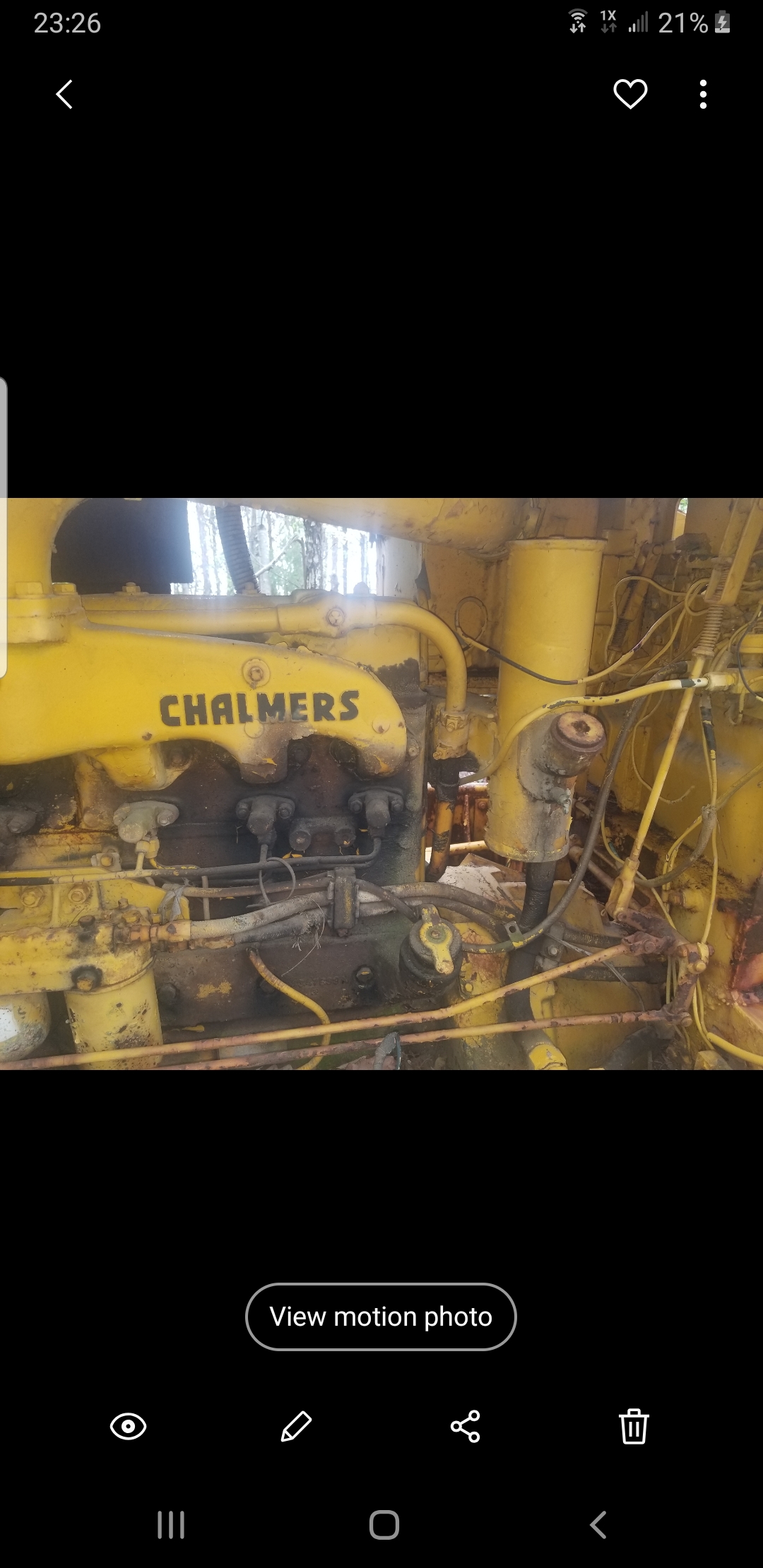

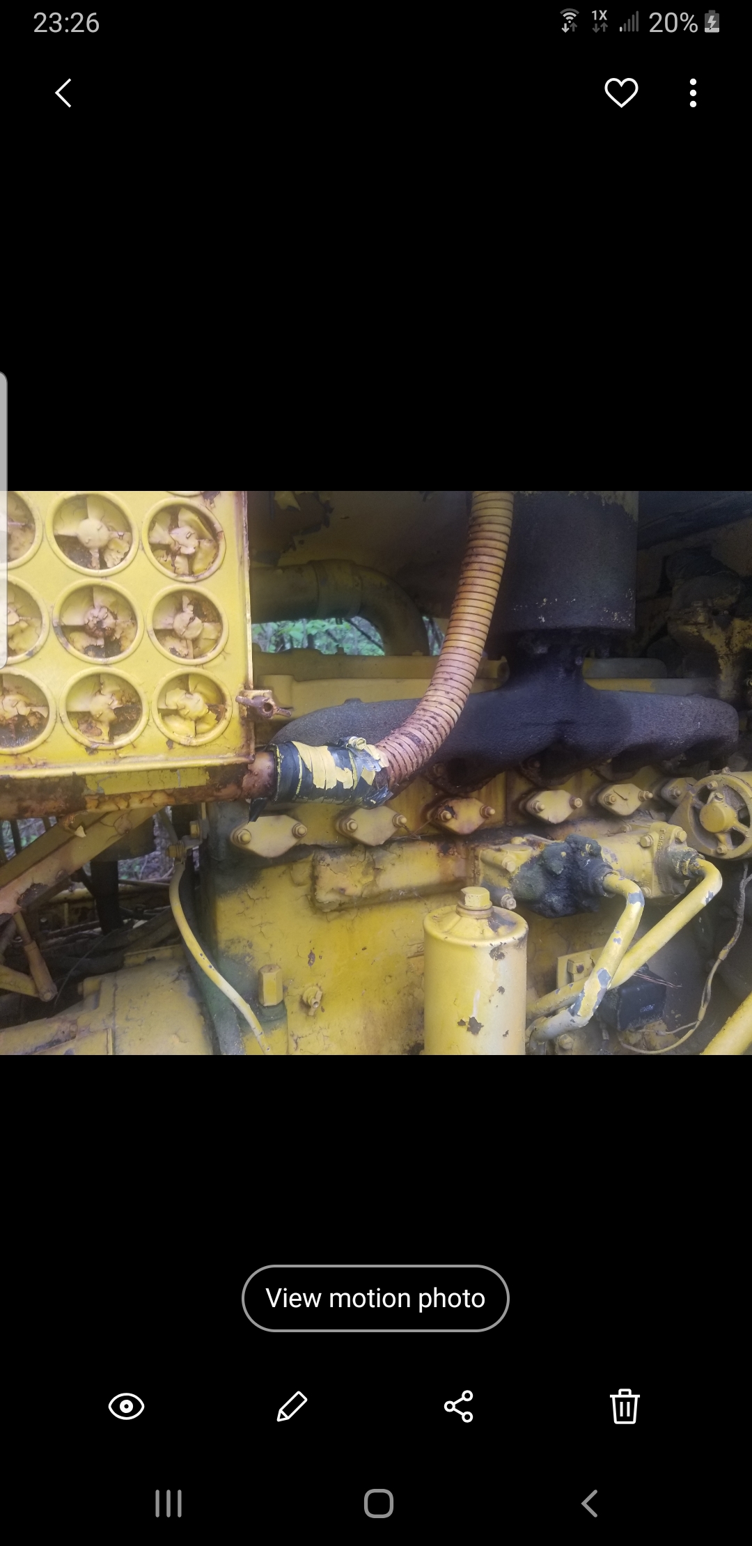

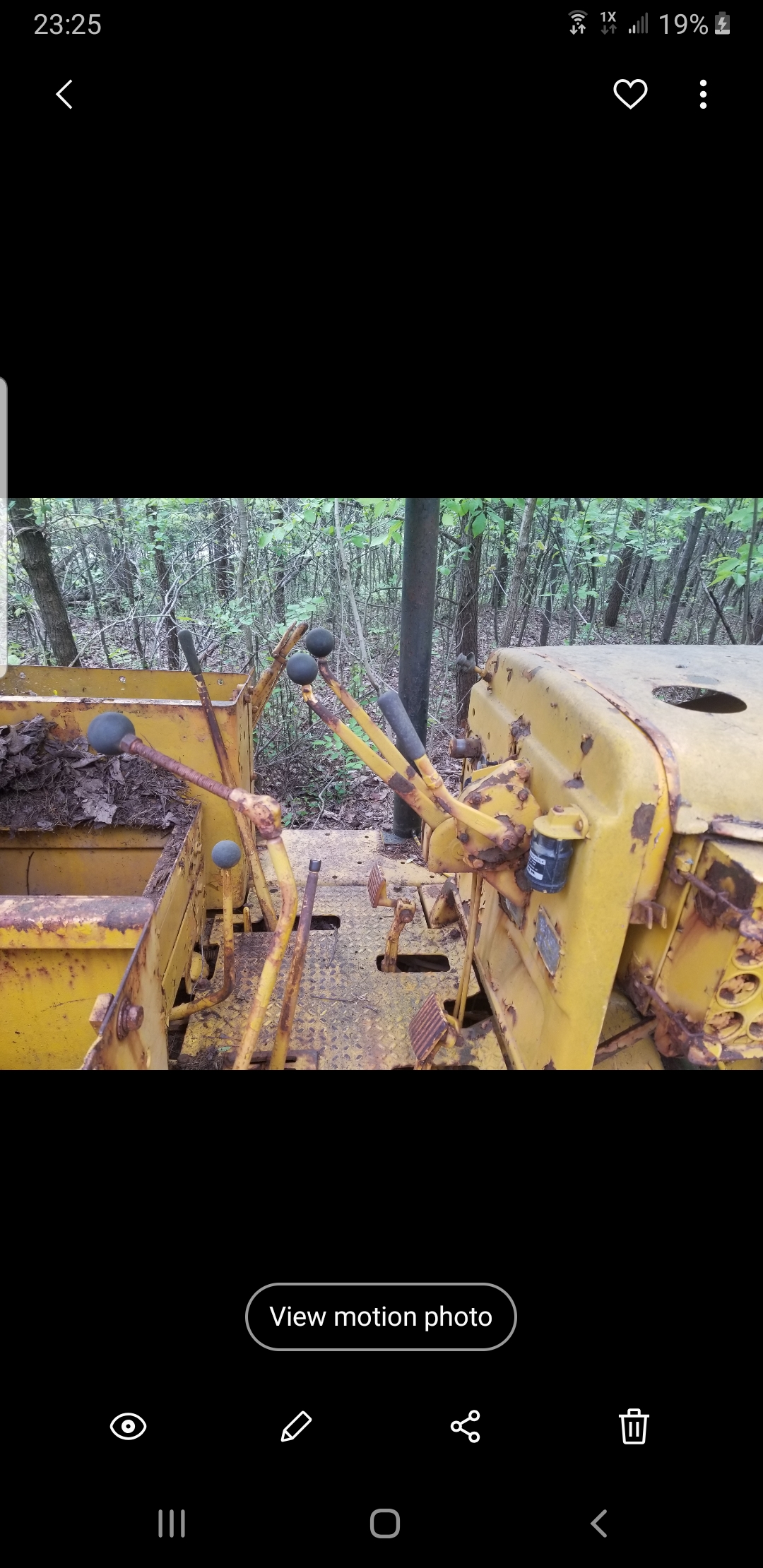

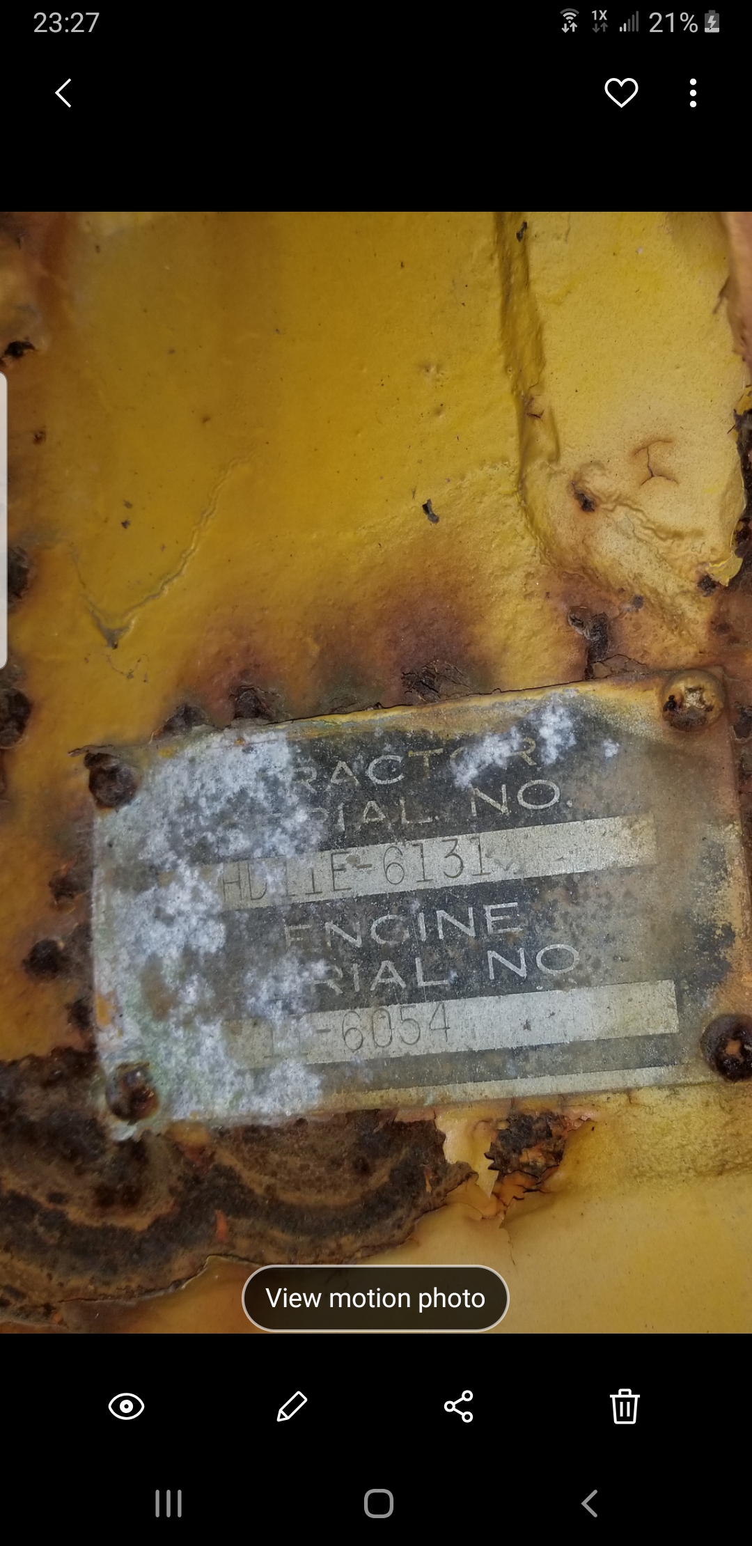

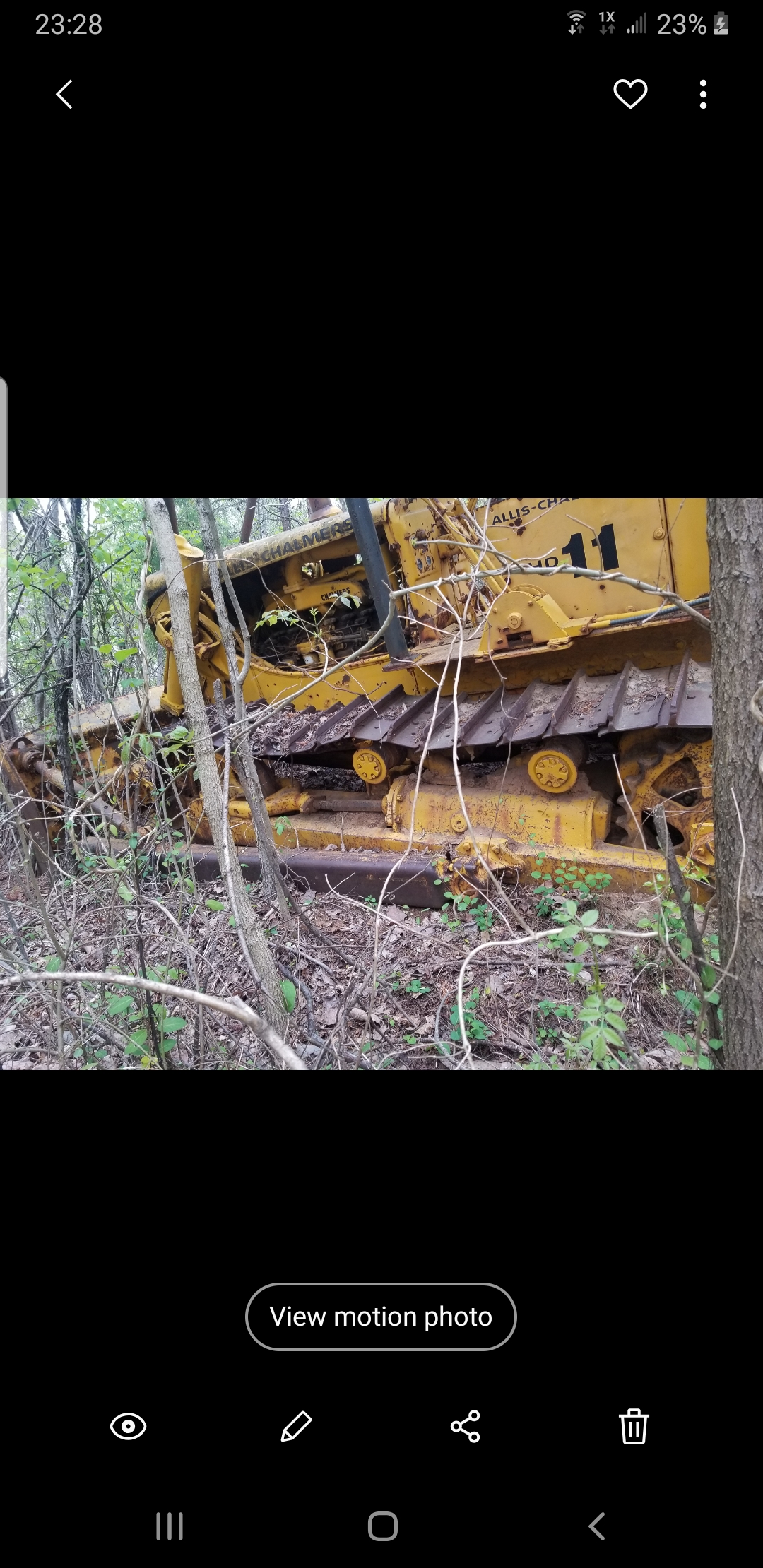

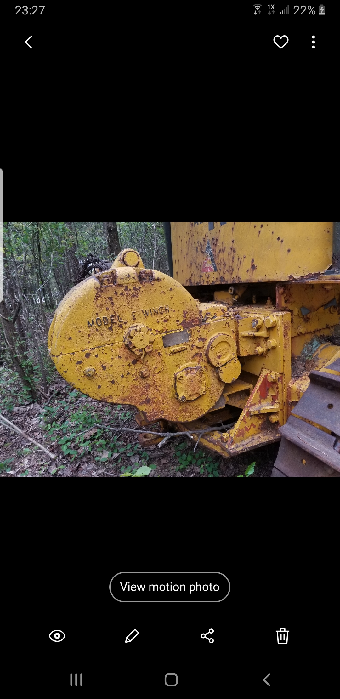

Yes..Trevor beat me to it...doesn't sound like original HD11 parts.  Post us up some tractor pictures...we like pictures here...especially some of the air cleaner set up...as well as tractor pictures.

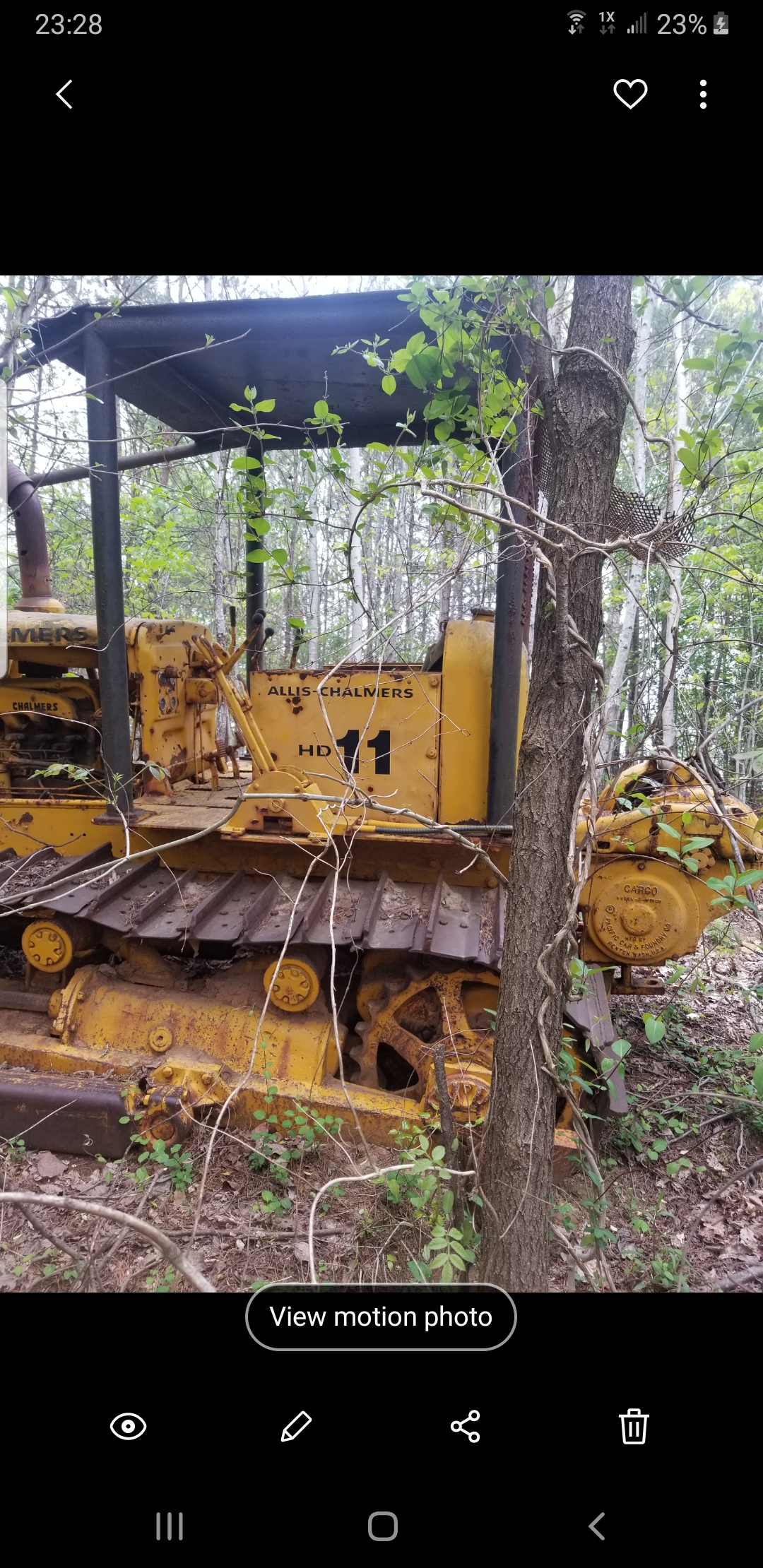

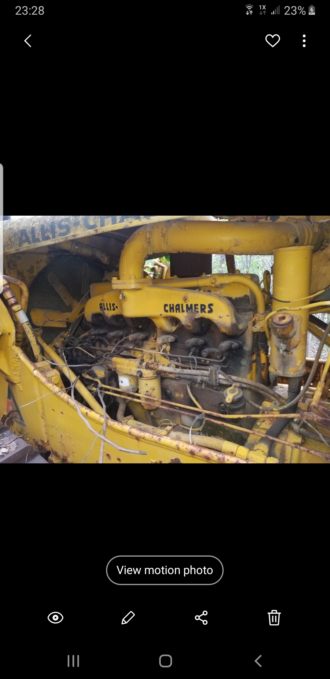

Post Options Post Options   Thanks (0) Thanks(0)   Quote 05ecofire Quote  Post ReplyReply Direct Link To This Post Posted: 17 May 2020 at 10:37pm
Joined: 23 Jan 2010
Location: N.Ca.
Points: 1189
Post Options Post Options   Thanks (0) Thanks(0)   Quote AC Mel Quote  Post ReplyReply Direct Link To This Post Posted: 17 May 2020 at 10:56pm
Ok...Cool!  you did good on the pictures..Has the Lanova style engine still..The air filter does look similar to what they did have at that time....I'll have to look at a parts book in the morning when I get to my office.  Nice specimen!

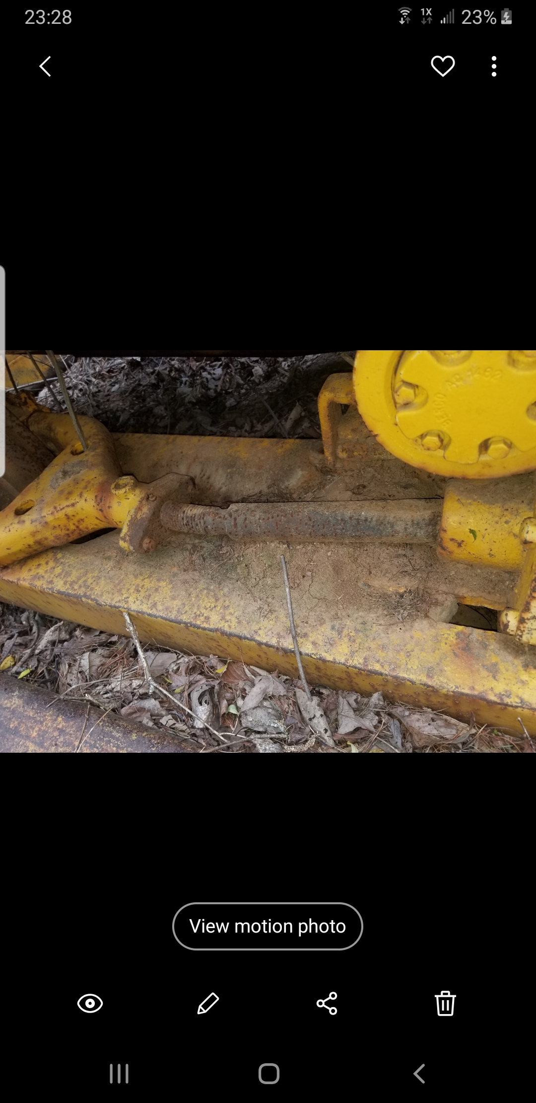

JohnColo View Drop Down
Joined: 03 Apr 2020
Location: Niwot, CO
Points: 1263
Post Options Post Options   Thanks (0) Thanks(0)   Quote JohnColo Quote  Post ReplyReply Direct Link To This Post Posted: 17 May 2020 at 11:54pm
The track pads sure look good, can't really see the rails to well.  Looks like it's been sitting there for a while.
Points: 36529
Post Options Post Options   Thanks (0) Thanks(0)   Quote DMiller Quote  Post ReplyReply Direct Link To This Post Posted: 18 May 2020 at 6:37am
Based on the Hood Hole this is a conversion. The old element will have a Number on it somewhere, these all did where that will be you best hope. The Farr Dynacell on my Allis has a Metal Tag on the housing with the Farr p/n on it.

Thank you all very much. Old owner said it's been setting for around 20 years. Aid the reason they left it setting was. The through a track and bent the tensioner trying to force it back on. From what I deduced he didn't loosen the tensioner. And bent it trying to use the rear sprocket to force it back on to the idler.I've been giving it some TLC trying to bring the old girl back to life. I will try to get better pictures of the tracks and undercarriage.

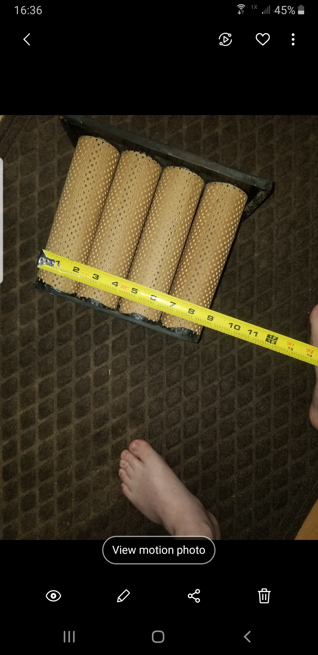

This is a list of filters I have purchased so far.after trying to convert them. Can anyone verify that there the right ones. Lol. Pt265, pf916, pf906, pt385, p20-hd,and b2,

Unfortunately P142799 will not fit either thank you. Gonna try to call Baldwin and see if they can point me in the right direction

Post Options Post Options   Thanks (0) Thanks(0)   Quote 05ecofire Quote  Post ReplyReply Direct Link To This Post Posted: 18 May 2020 at 12:12pm
I found the air filter. Called Baldwin directly. (800-822-5394) and they were able to look it up by its dimensions. They said they could do it for virtually any filter you could think of. the filter is a PA1776. Thank you everyone for all the help in finding out what this thing was.

Points: 36529
Post Options Post Options   Thanks (0) Thanks(0)   Quote DMiller Quote  Post ReplyReply Direct Link To This Post Posted: 19 May 2020 at 5:49am
Would suggest on the adjuster, to cut the bent threaded portion off the hex stem, then take both pieces to a machine shop and have a threaded rod made then welded to the hex length and reinstall.

Post Options Post Options   Thanks (0) Thanks(0)   Quote 05ecofire Quote  Post ReplyReply Direct Link To This Post Posted: 20 May 2020 at 7:39am
So if I cut the adjuster I can just unscrew from idler and pull the adjuster shaft out? Or do I have have yo take the tensioner system apart to get adjusting rod out? Sorry for crapy verbiage just want to make sure I'm doing right. Don't screw it up
Edited by 05ecofire - 20 May 2020 at 7:42am
Points: 36529
Post Options Post Options   Thanks (0) Thanks(0)   Quote DMiller Quote  Post ReplyReply Direct Link To This Post Posted: 20 May 2020 at 2:21pm
May or may not Just Unscrew!! Take the lock off the yoke and may come right out, main thing is to release the stress against the yoke and hex section of the shaft then the hex can be lifted out of the way and the threaded end worked on.

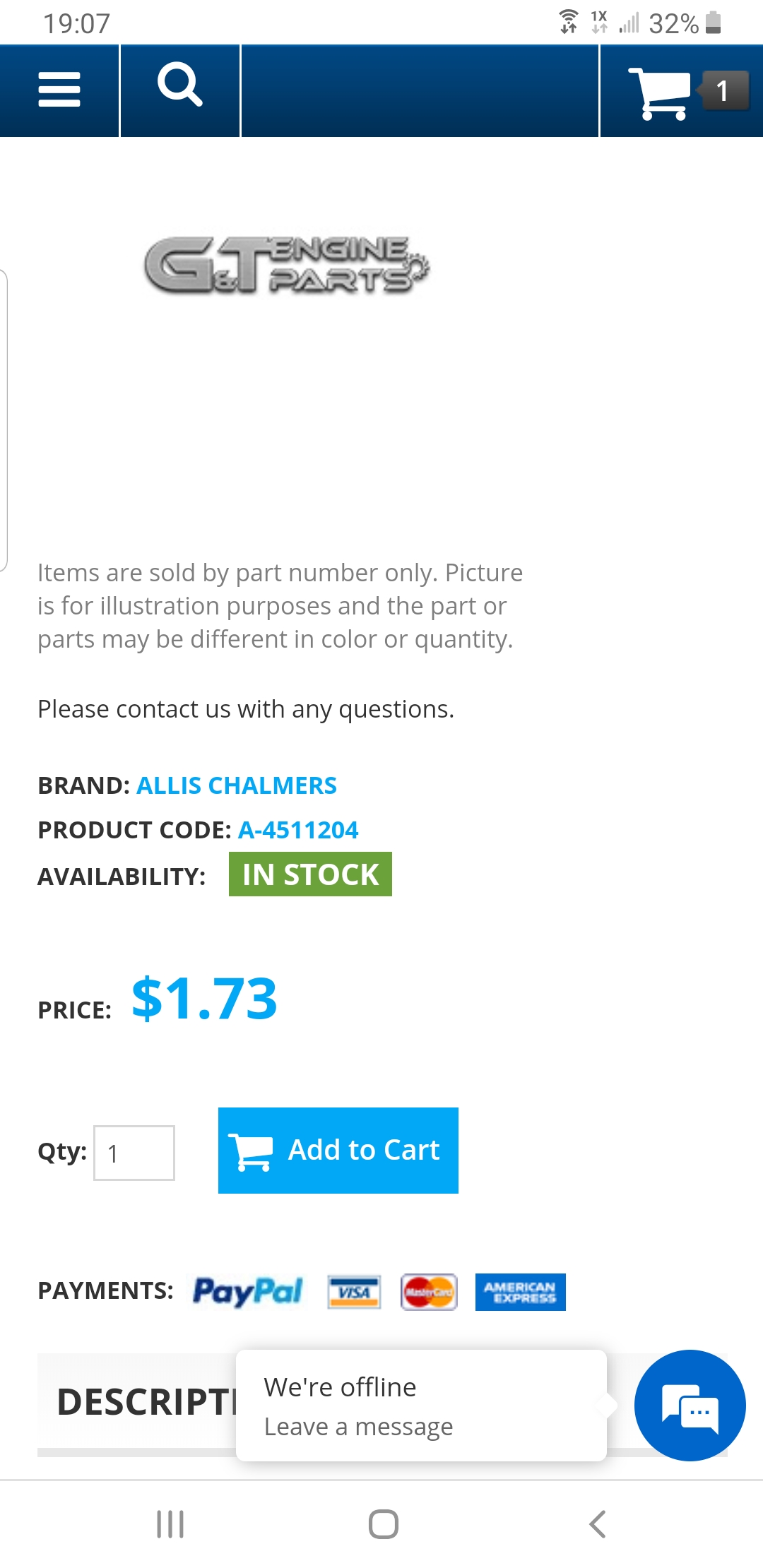

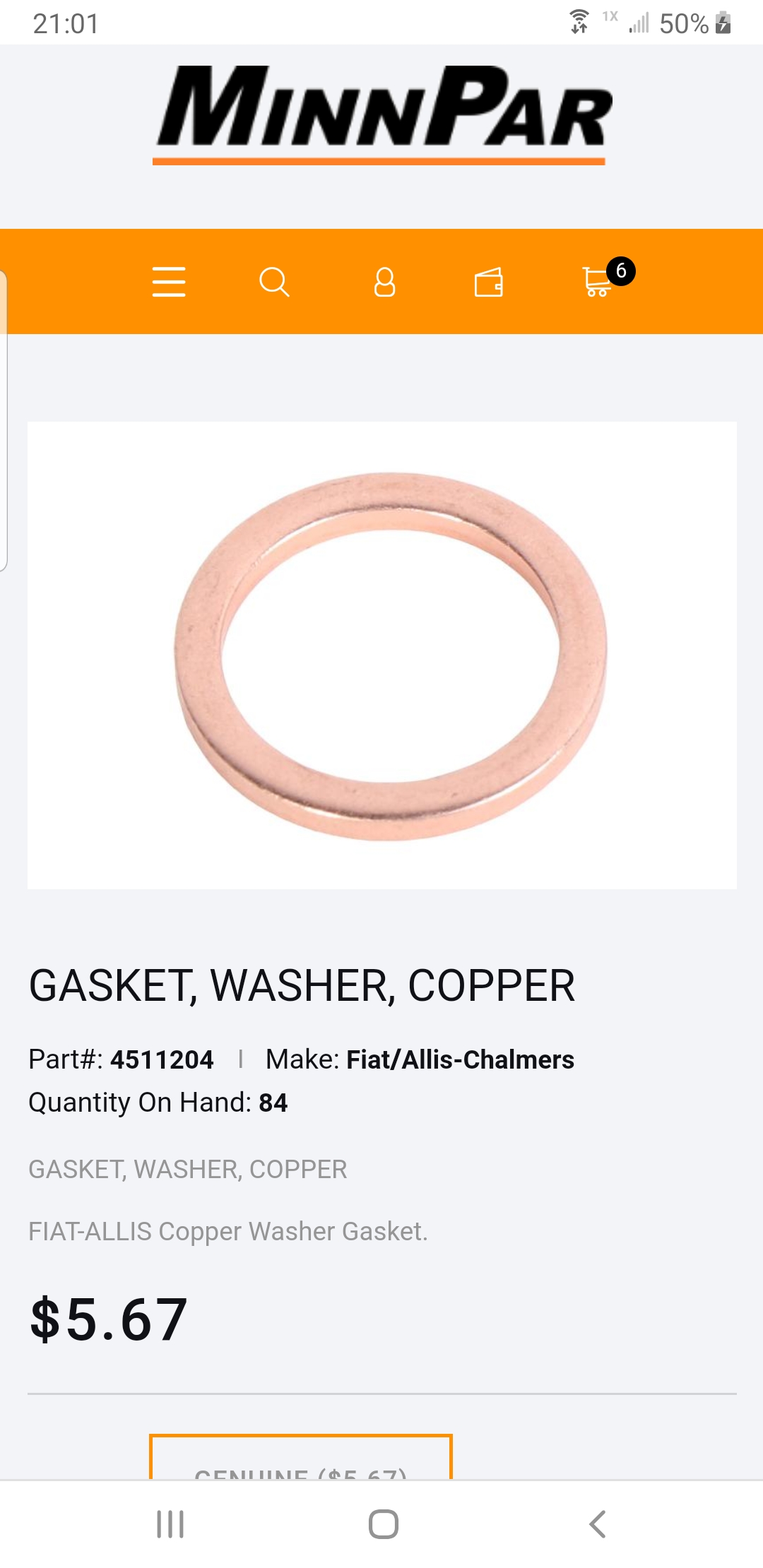

Awesome thank you. I have another quick question. Dealing with injectors. I am looking for the copper gasket. I looked up the part number in the manual (4511204) but when I look on line and I found a few but the items that are coming up are priced way different and from one sight it is listed as A-4511204 and the other reference 74511204 as the OEM. So confused on what I'm supposed to buy any help would be greatly appreciated. Screenshot_20200520-210105_Chrome.jpgScreenshot_20200520-190726_Chrome.jpgScreenshot_20200520-190726_Chrome.jpg

Post Options Post Options   Thanks (0) Thanks(0)   Quote Ian Beale Quote  Post ReplyReply Direct Link To This Post Posted: 21 May 2020 at 1:32am
IIRC part numbers got that extra 7 added in front later on
Points: 36529
Post Options Post Options   Thanks (0) Thanks(0)   Quote DMiller Quote  Post ReplyReply Direct Link To This Post Posted: 21 May 2020 at 6:46am
That is correct Ian, as AC incorporated to FA that number change occurred. As to Nozzle coppers, any decent Fuel Injection shop can get those, does not have to be Allis.

Post Options Post Options   Thanks (0) Thanks(0)   Quote CAL(KS) Quote  Post ReplyReply Direct Link To This Post Posted: 21 May 2020 at 8:03am
im sure minnpar.com stocks then and can order online if you want
