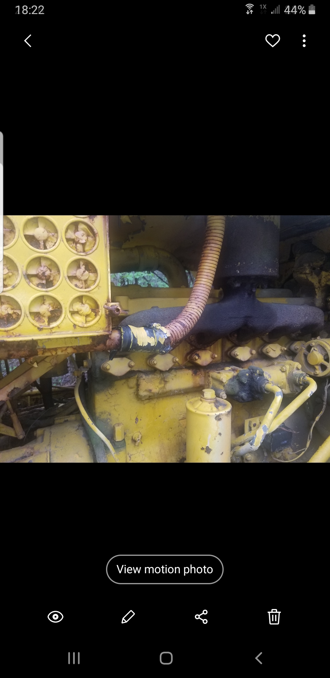

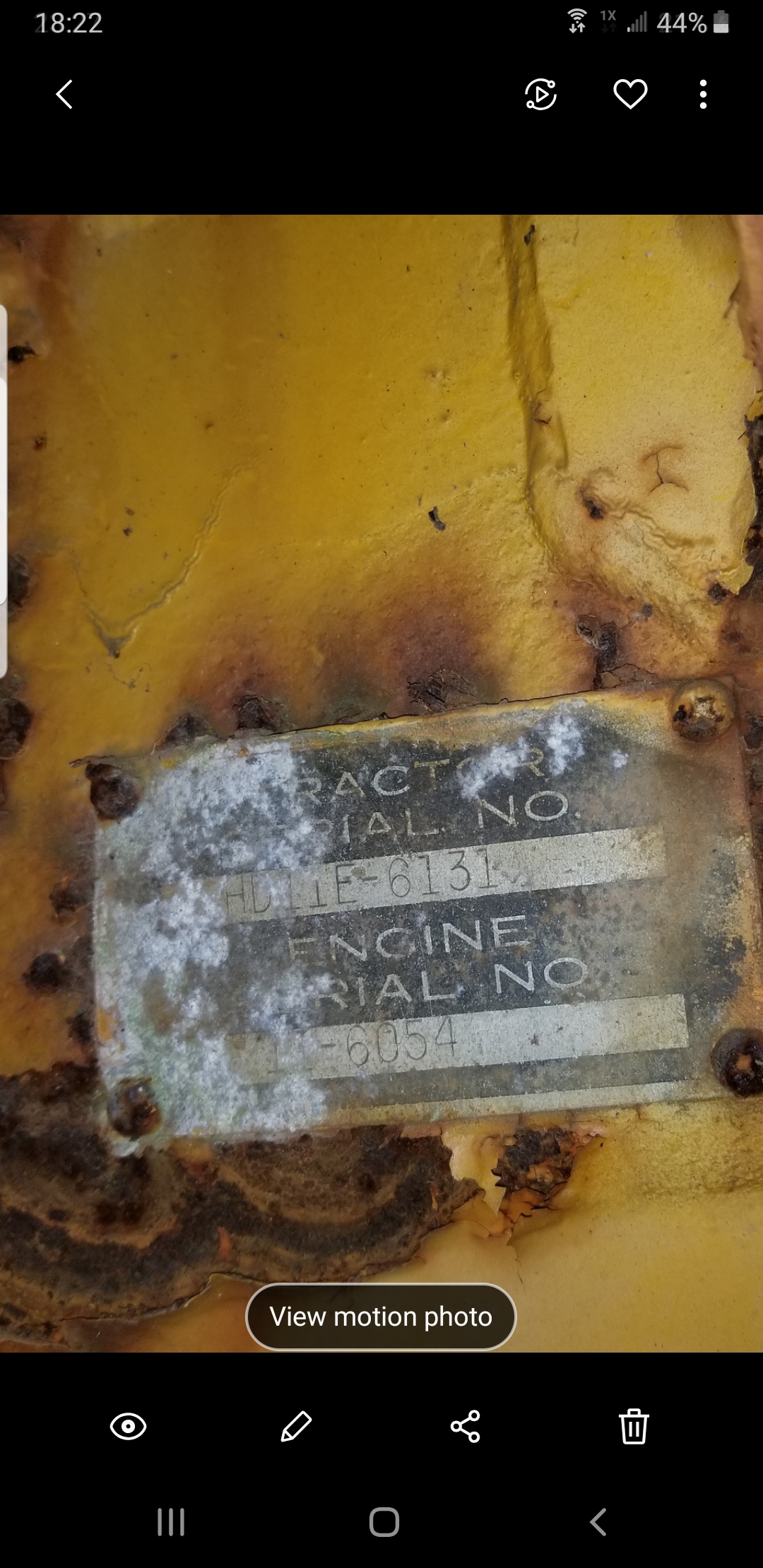

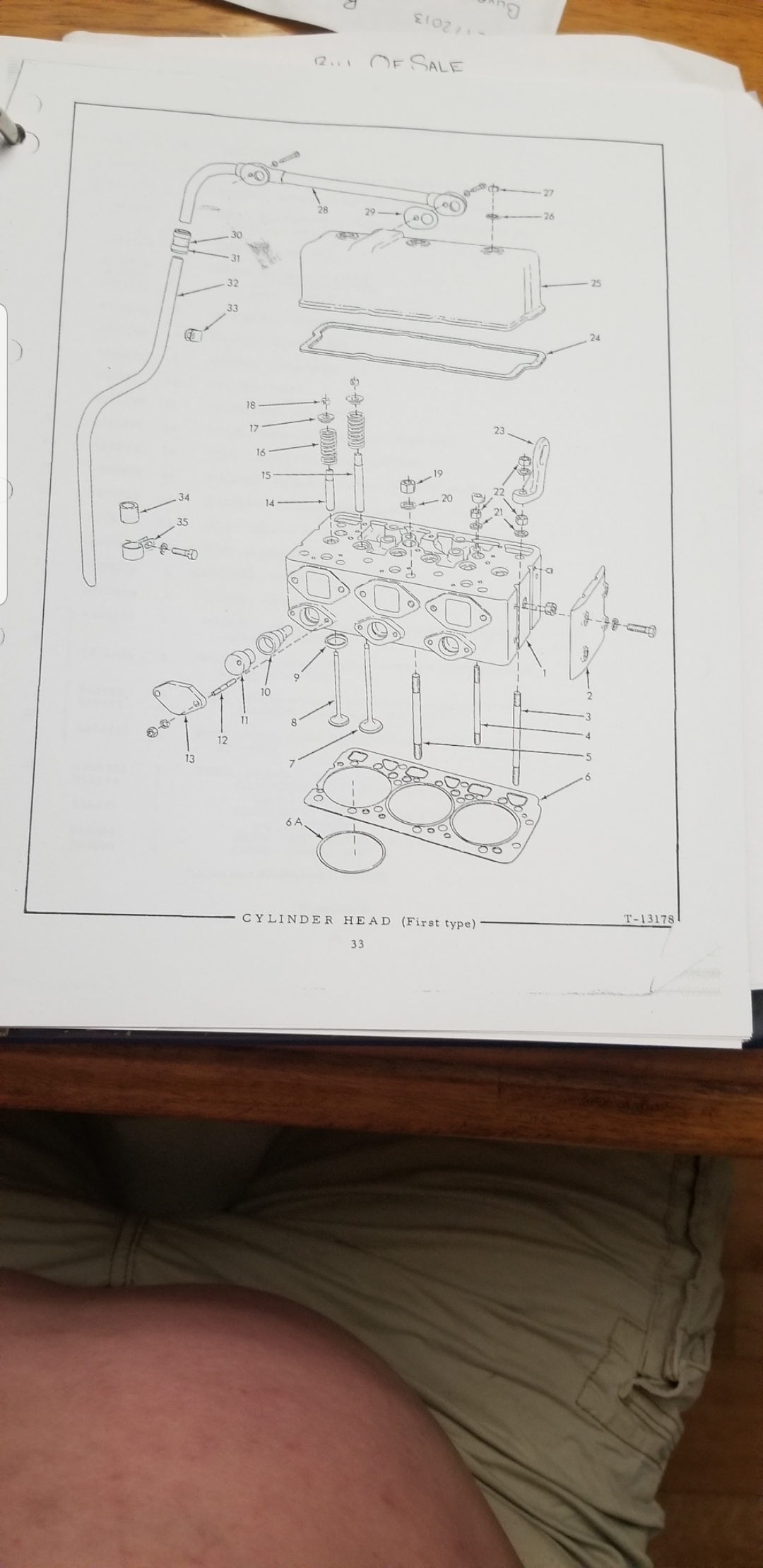

Can anyone help me with head gasket numbers. HD 11 dozer engine serial# 11-6054, tractor # Hd11-6131, I looked through my parts manual and unfortunately that page is missing. Just my luck. I took picture of the diagram, to show style of heads. Any information would be greatly appreciated.

Google MINNPAR, go to Parts Manuals, Allis, then Crawler Dozer scroll down to HD 11, Can download the latest and greatest.
gemdozer View Drop Down
Points: 1131
Post Options Post Options   Thanks (0) Thanks(0)   Quote gemdozer Quote  Post ReplyReply Direct Link To This Post Posted: 25 May 2020 at 6:39pm
The front head gasket 4354294 and the rear head gasket 4354295 and fire ring 4339848

Gaskets for a Lanova head AC Forty Five grader (parts page numbered the same as yours) are
Front  4347798  rear  4347799, no fire ring.  Package  of the pair 4335831
Might work if you're stuck as AFIK the heads are the same

Try  "7" in front of the number as happened with later parts numbers

The head gaskets number are HD11 prior to serial no 6427 in my munual parts

The head gasket parts number for HD11  4354294 front and rear is 4354245 and fire ring should be included with and in my second manual  head gasket with no fire ring are 4347798 front and rear 4347799

The Parts Depot in Wisconsin shows they have 74347798 and 74347799
Machinery Parts Warehouse shows they have 74354294 for $23, and 74354295 for $16
