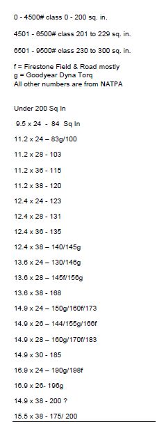

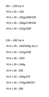

I've done some research in the Firestone and Goodyear catalogs and came up with these number for Sq In.
Some are more and some are less than the NATPA numbers. I can only assume that the NATPA number are the deciding numbers, for what your allowed, for tire size.
In that case a larger foot print listed for g & f would be advantageous.
The 15.5 x 38, 175, is Goodyear and the 18.4 x 34, 291, is Firestone.
Edited by frnkeore - 08 Jun 2019 at 1:46pm
