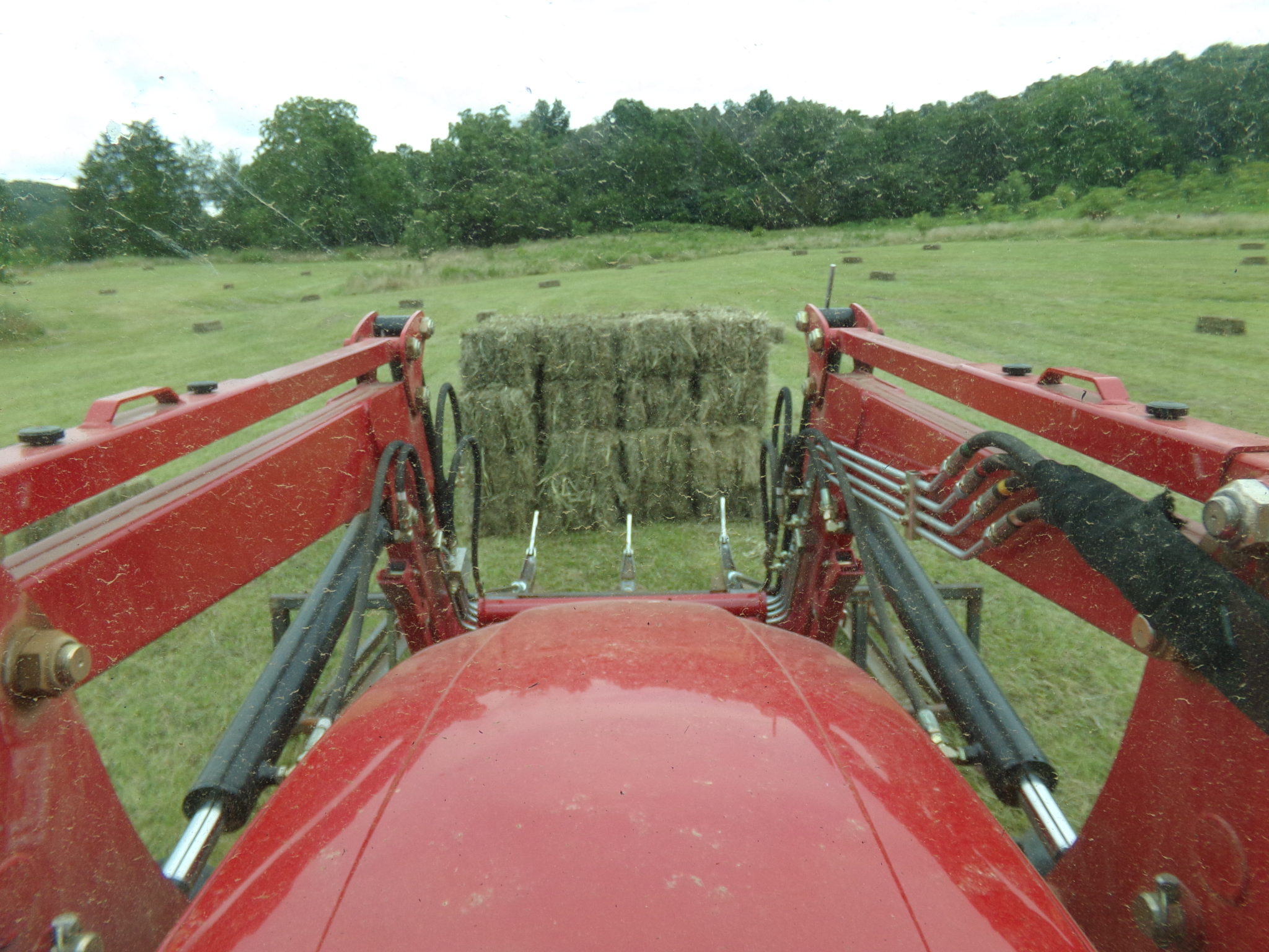

Here is how I put up my hay now.
Over 1200 bales this year with no help.
The 3ed cutting starts this week.
32 bales to a stack, then off to the barn.

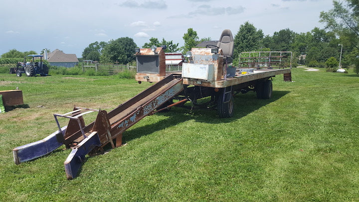

OK, this is what a hay monster looks like in full fighting trim.
Have had help the past two days, and we have installed a new wiring harness for the ignition and all new gauges. Got the front snout off the deck and installed and working.
Even pulled a few old square bales off the stack and scattered them around to see if she would pick them up and she did. Looks a bit scruffy from years of neglect, but beauty is as beauty does and she is working as intended. New coat of paint someday will do wonders.

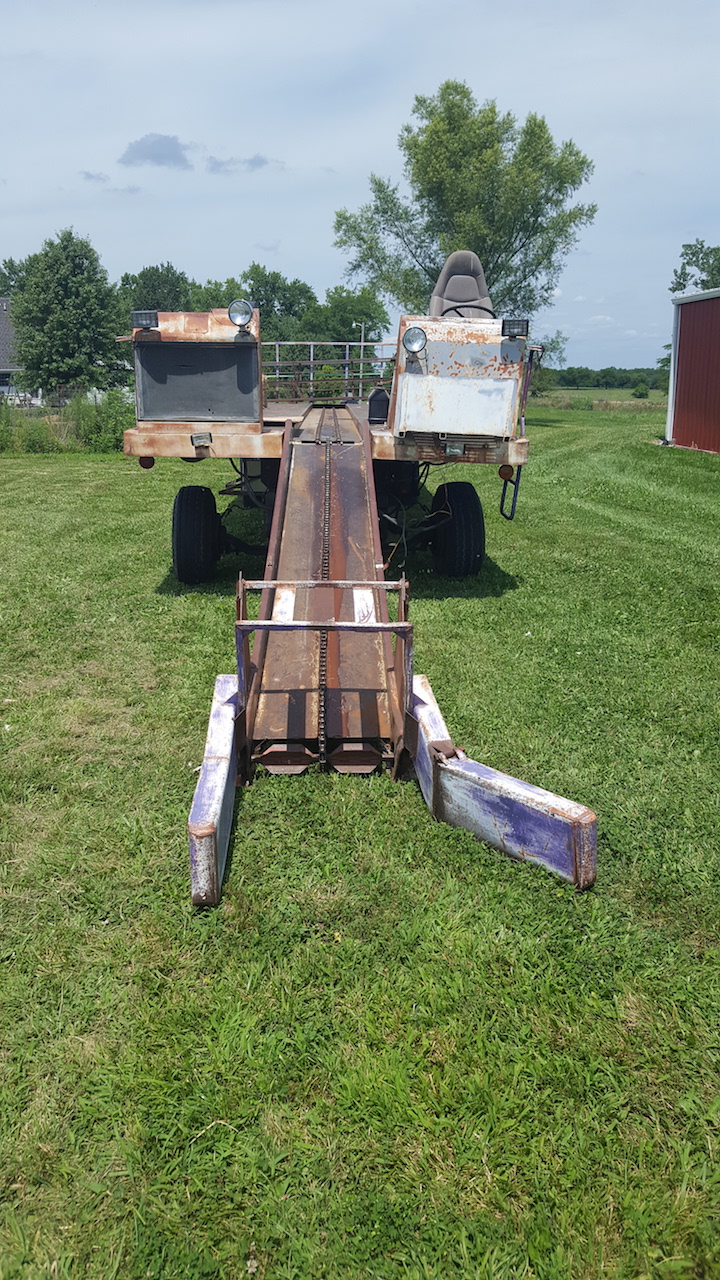

Another view of the business end........keep in mind this is 1970 technology and this particular example has been rode hard and put away wet more than a few times.......

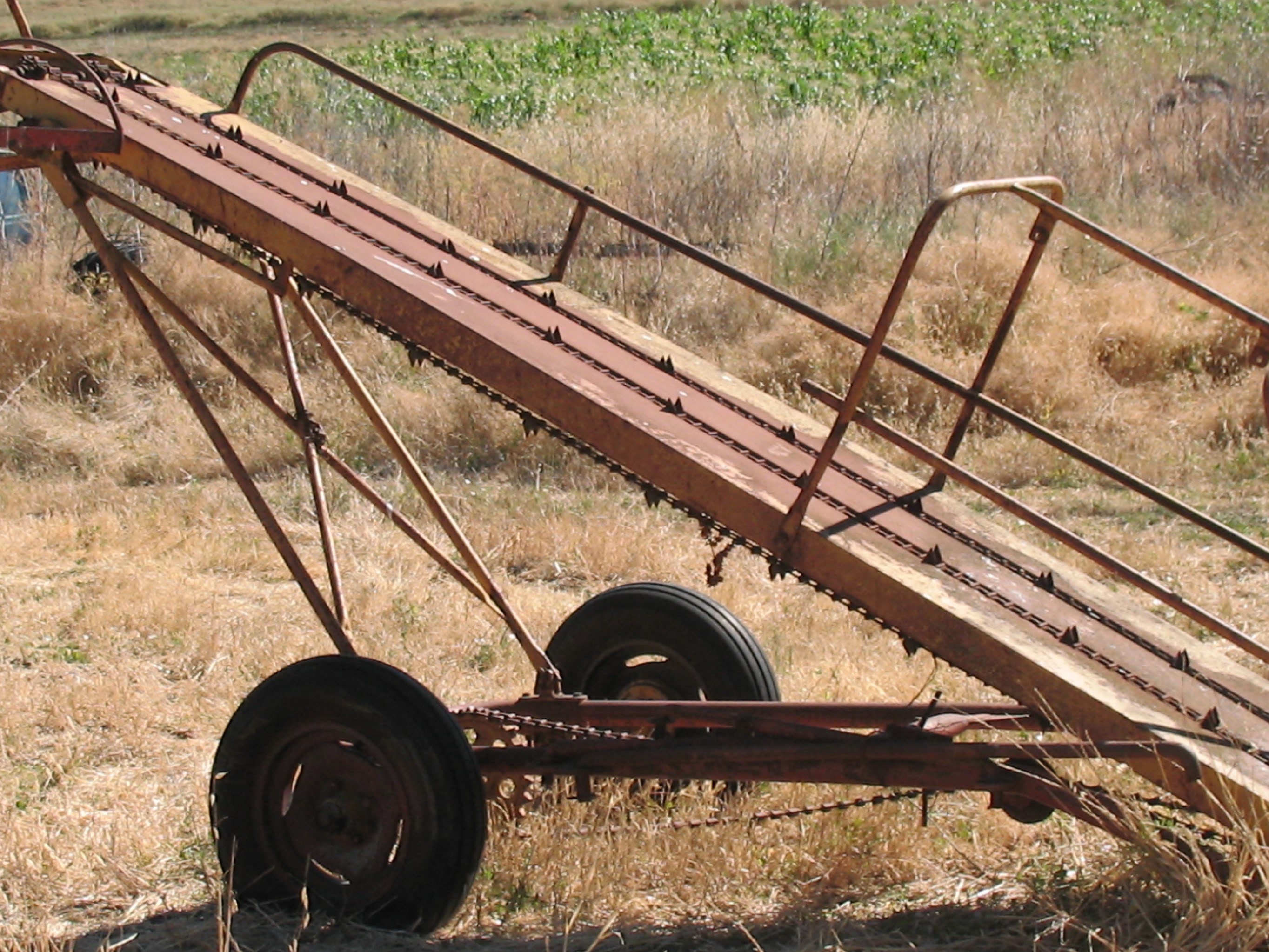

We still use a Graves bale loader and a 1954 Ford F-500 to haul square bales.  I was just a little kid when my dad bought the loader.
I don't mind loading the truck, if I have a good driver.
The part I do not like is stacking in the barn.  We do not have a bale elevator.
Unlike most people, we do not use a hay hook.  My dad did not allow us to use one while hauling hay.

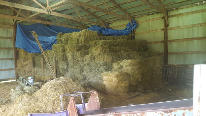

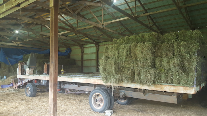

Update on the Hay Monster.......
Put 260 bales down the other day for a test........had first 150 bales off the ground and stacked in the barn in one hour flat.
Neighbor wanted about 50 bales for his hay burners......so after picking up remaining 110 bales.....we cruised over to his place at about 20 mph.......stuck the nose of the front chute in his barn door and dumped bales off right where he stacks them. Rest are going to a different neighbor.......he stacks his in a loft......will shoot them up to him to be stacked.
Had 3 kids riding on the back......they were able to keep up stacking on the monster while picking up.....but they had their hands full on top of the stack. I was unloading on the truck and all I had to do was keep dropping bales in the tray. Bales ride the chains going forward and front chute raises up to become elevator to top of the stack.
BTW......tarps on the hay are because roof leaks pretty bad......rubber seals on nails mostly gone after 50 years. Just to the left of JD sickle bar mower is where D15 sat waiting for me for 20 years.....same D15 used to rake all this hay. Smile
