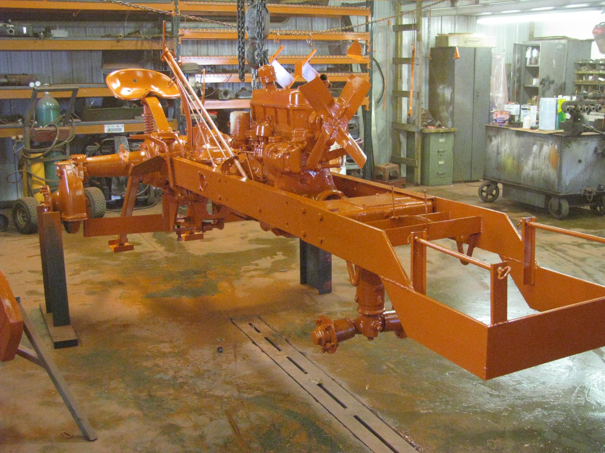

i need  to weigh one again memory isnt what it use to be . anyways you can tell in the picture the gleanor doesnt have the mass the tractor flywheel does that was more my point than scale weight. If you do what dr. allis described then its at it on the scale.
