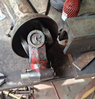

10/26/2025 Status (7): The Dunham Lehr disc rims were not in good shape.  One of them was completely mangled.  Can't even imagine how it could get twisted that way (or the tongue crank handle).  The other one could possibly be salvaged with a week's worth of work.  I opted to order some new rims and had Pomp's put some trailer tires on them.  This increased the disc value by 500% or more Big smile  The better one had a G78-15 tire on it which would have been sometime in the 1970s.
Edited by dfwallis - 26 Oct 2025 at 3:32pm

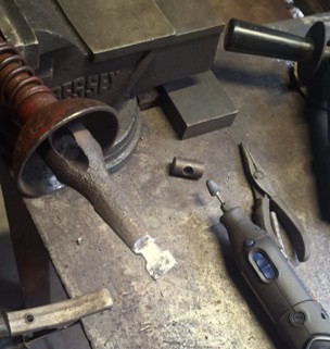

10/26/2025 Status (8): The last item was to remove and start cleaning up the disc hydraulic cylinder.  If anyone knows what brand this would be, please let me know.  AI says they owned a company called "versahaul" which made the cylinders, but I didn't find any parts for those.  The closest appearing end cap/gland/head I saw was for a bradco.  There is some minor pitting in the barrel and on the rod, but the rubber O rings all look like new.  There was only a very tiny amount of water that came out of the petcock.  I ordered a new 10' hydraulic hose for it.  The old one was 9'4" and consisted of two jointed sections, one 1/2" and one closest to the tractor 3/8" but with 1/2" NPT fittings.  I'll probably buy a breather plug for it after I decide what I need.  Hopefully the hydraulic shop will be able to identify it (but I have my doubts).  In any case, they said they could likely get it going.  The gland is broken at the very end where the retaining rings hold it in place.  The inner retaining ring will be fine, but the outer one wouldn't really fit against anything.  It isn't really clear that the inner ring isn't sufficient, though.  I ran out of time to inspect this further.  The gland is aluminum.  It looks like it would be easy for a machine shop to duplicate or perhaps create a separate clip piece that can be attached.
Edited by dfwallis - 26 Oct 2025 at 4:09pm

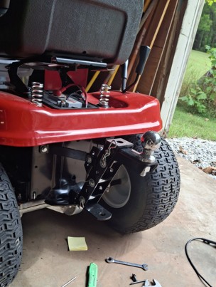

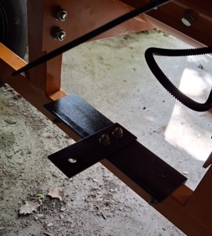

12/04/2025 Status:
In order to complete assembling the plow, I needed two "locking" bolts that I didn't have.  Dr P was sending me some, but had not received them (they may have arrived later after I left).  So I made some out of stainless steel.  I used some nice 1/2" "thumb" screws from McMaster-Carr.  Chopped off the sides and top and hand ground to the right curvature.  They actually fit the slots "better" than the originals.  They are just a little long, but could shorten if it was needed.
I'm not quite happy with the way the plowshare attaches.  The spacer section on one is not meeting correctly because I didn't get the bracket bent back quite right.  I'll need to work on that a bit more.
I was hoping to get further along, but it was a bit chilly and I had motivation problems...:(  I also had to wait for some parts.  I originally intended to use stainless in strategic areas, but some of the bolts I bought were of such low quality, that they kept galling with only enough force to close the lock washer.  I quashed that and got grade 8 bolts instead.  Actually had to cut one off that hadn't even been tightened enough to keep the parts from sliding around.  After I cut it off, I tried getting the nut off and could not putting it in a vice and using a 24 inch pipe wrench.  It was firmly welded in place :(
It was leaf mulching time, but all of the mowers were broken.  It was about to rain, so I tried to get one of the riders going.  I replaced the two deck spindles (which were probably used on another one), sharpened the blades, cleaned, and painted.  I also straightened the deck wheel brackets.  I moved to the engine itself, replaced the battery and got it started, but the float was sticking and dumping a huge amount of gas into the cylinder.  I cleaned the carburetor but all of the rubber gaskets were deteriorated.  So I ordered a new carburetor for about the same price as a gasket set.  It didn't arrive until the last day of the trip when I was trying to get things cleaned up to leave.
Since it was clear I wasn't going to get the rider fixed, I went to town and bought the lowest end push mower they had and mulched the main areas.  It was very wet and things didn't mulch well.
I also took some of the Dunham Lehr disc tongue and rear gang mounts to the welder to be straightened up.  He straightened the tongue brackets pretty well, but was unable to straighten the angle iron sections.  Couldn't get enough heat on them.  I opted to have him make some replacements I'll pick up in a few weeks.
I took the hydraulic cylinder to a shop for repair.  He seemed optimistic about being able to repair it (even optimistic about locating a replacement head/cap section).  He can also make one if needed.  It's a pretty simple design in aluminum.  Hopefully, that will be ready also to be picked up in a few weeks.
I put primer on various parts so they don't rust before I get around to painting them (including the above straightened brackets).
Edit:  I also built a mounting system to add a vac onto the sand blast cabinet.  This is the unit sold for the larger (vevor) blast cabinet.  Was pretty easy to adapt.  I liked it better than the small/puny one sold for this cabinet.  I still can't operate it at the same time as the compressor though (inadequate supply current).  I'll either have to run a long drop cord or work on getting the other leg of the 220 from the pump house to the barn.  It's already probably wired, but does not seem to be energized at the pump house, which I'd have to dig up.
Edit 2:  I designed some movement limiting bars for the hydraulic rams so that it's easier to use the single remote while leaving the 3pt mod in place.

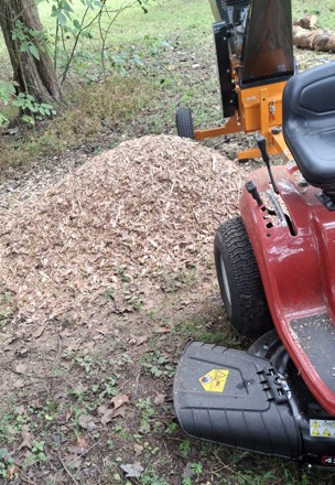

01/01/2026 Status:
The December/Christmas trip was less productive than planned relative to tractor/plow/disc progress.  I did get new rear gang mounts made for the disc but didn't get them painted.  I also checked on the disc hydraulic cylinder progress, but the guy that makes the replacement parts for them is out for 6-8 weeks with back issues.  I could have taken it to one of the regular machine shops, but that would be several hundred dollars more and I can wait.
I spent several days getting one of the 4 broken riding mowers going.  It seems to be working fairly well but the governor is not working correctly.  It keeps trying to rev to max RPMs.  I had to add an extra spring to bring it back to idle but the one I chose isn't quite strong enough.  But I am able to control it over a very short range.  Needless to say it doesn't "govern" properly, but at 16HP, it doesn't bog down that much anyway.  I ordered a mulching kit for it.  I installed the new carburetor and I had to straighten the front steering linkage crossbar, the deck, and the deck belt engage return spring bracket/rod.  I tried adjusting the governor but there's very little adjustment to be made.  Adjusting it to the "correct" setting per the manual leaves it revving.  I could perhaps force it to limit the revving travel, but then it wouldn't have enough travel to perform the governing function (adjusting under load).  More investigation when it warms up.  It was annoyingly cold most days.
The other activities included fixing the left side garage door spring so my sister could raise the door (left cable frayed), and began work on the barn roof.  It's starting to leak, several rust spots, and the drip edge is frayed from rust.  As a deterioration delaying tactic, I started pop riveting a flashing strip over a spray on rubber coating.  This is partly to protect the rubber coating and to provide the to-be-applied top rubber coating something to stick to underneath.  That will probably consume the next trip as well.  I ordered a new 12 foot ladder so I can climb on the roof.

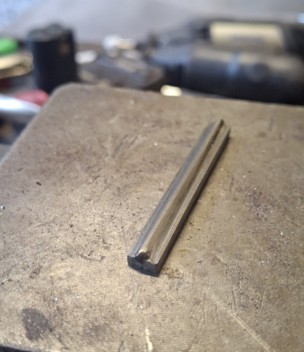

I wanted to make sure I have something ready for my next trip, so I made a draft (clip) spacer for the pickup plow pull bar.  I'd still like to acquire the correct one, but this should work if I can't.
This is probably too thick to set the tongue at the right angle so I'll probably have to shave the bottom slightly.  I don't think that's really critical though since you're never going to have a plow and tractor on perfectly level ground in the real world.  If it works as-is, I'll probably not modify it.  If I have to modify it, I'll consider cutting the sides at the same time to match the snap coupler rendering rather than the pin hitch rendering in the plow manual.  What is the purpose of the side cutouts?  Perhaps better moisture drainage?  Better greasing access?  Change for change sake?

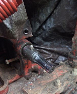

The main project was to finish up the PTO adapter.  I worked this up mostly at home in TX then shipped the developmental version (which of course doubled the cost).  I tried it out with the finish mower and it worked better than I anticipated (I expected broken chains and nuclear explosions or worse :( :)  The only issue really was some of the set screws came loose (and the chain stretched).  I thought sure I did a final check of them all.  All of the loose ones were on the lower shaft.  All of the upper shaft items were fine.  I do have a vague memory of adjusting the lower shaft to gain clearance to get a wrench in behind, so maybe I just forgot to tighten everything back up :(  I also bought some additional locking collars if this proves to be a problem (that locktite won't fix).
My original goal was to make this adjustable from 16 inches above ground to 20 inches above ground.  However, my memory of the height of the drawbar was off by 1/2 inch so it ended up that about 17 inches above ground is as low as I could go (without modifications to remove the drawbar obstacle).  The lower sprocket (4 inches) would likely be too close to the drawbar.   So, it is set at 18 inches which was my normal operation goal and seems to work well there.  I had made 3 sets of chains for 16, 18, and 20 inches.  The actual adjustment range of the backing plate is 16.5 inches to 24.5 inches, but fitting in the sprockets and idler (and eventually an oiler system) limits the practical range of adjustment.
It has a quick disconnect PTO overrun clutch at the top.  All of the original ones with the quick disconnect had much too short PTO shafts.  They were only a little over 2.5 inches long.  That's not long enough to extend through the backing plate, the bearing, and have enough left to mount the sprocket onto.  So I had to purchase a separate PTO extender adapter that had an extra long PTO shaft to create an overrun clutch with the correct characteristics.  I cut the original PTO clutch shaft at 5/8 inches, cut the PTO extender  back end socket to 5/8 inches and then welded the new PTO shaft on.  It appears to be running very true (a worry).
It has a chain tensioning system that consists of two fine threaded rods that pull down on the lower bearing flanges.  These firmly prevent slippage.  It might have been enough to tighten just the bearing flange bolts and eyeball the chain tension, but I prefer having this fine control over the tension adjustment.  I think that the chain stretched more than anticipated on first use though.  That's concerning, but will see if that continues after I re-adjust.  I may need to remove a chain link to keep it at 18 inches above ground level.
Mounting stability at the bottom is through 2 threaded rods mounted to the drawbar bail.
Bottom end rotation prevention is mostly provided by a cutout in the bottom of the backing plate that allows it to slide below the top of the drawbar.
Since this device is very heavy, in order to try to lessen the weight load on the tractor PTO shaft, I created a downward facing set screw that presses on the top of the drawbar and raises the device just enough to reduce the weight on the PTO shaft.  This is likely going to have to be adjusted periodically (has a locking nut but things will wear).
Edit:  Background is that the CA PTO shaft is 30 inches above the ground.  This causes an extremely sharp PTO shaft angle when operating most 3 point equipment in the down position.  I didn't think it was practical to keep using it for 3 point implements without this solution (or a gear driven one, but that made it more difficult to define something adjustable).  I just hope it's not too unreliable.
I created a guard for the PTO adapter.  This is a homemade brake.  It worked fairly well, but was just slightly understrength for 1/16 inch steel.  The plate bows in the middle leaving nice crisp ends but fat curves in the middle.  Good enough, though.

2) For mounting my PTO chain drive adapter, I needed a guide to help me mount it true, to minimize side force (and weight) on the CA PTO shaft and the overrunning clutch attachment.  The below guide slides into the stock PTO guard and has extendable rulers to help me get the alignment right.  I clamp it in place to the PTO guard side braces.  The cutouts are to avoid bolt heads and welds.
In another post, I had mentioned difficulty with the overrunning clutch not releasing with even light hand pressure.  With this guide I was able to accurately adjust the attachment to allow the clutch to operate correctly.  The vertical weight adjustment of the attachment is also required of course.  I may have to beef that weight adjustment up some.  It is a single 1/2" bolt that presses down on the top of the drawbar.  But after mowing 3 acres it seemed to still be properly adjusted (the OR clutch was still releasing).  The attachment is slowly becoming more reliable as I work through the issues.  I'm pretty sure I'll have to continue to check alignment before every use though.
3) I installed the new, newly painted, 3 point lift brackets.  After mowing several small fields, the PTO chain drive adapter seemed to be working very well.  The set screws did not appear to have come loose.  That would be very obvious, but I checked before moving to the second field and all was well so I continued on.  It appears that the best leveling arm connection position for the finish mower and the MF41 will be the position closest to the cylinders which gives a lift range of 13 inches.  At that point, it is virtually impossible to cause the PTO shaft angle to become too great.  That's exactly what I was hoping for.  I don't like having to worry about lifting the mowers too high.  The new mods also allow me to make proper top link tilt angle adjustments (level, tilted back, or tilted forward).  It was more difficult when the lift range was too great.  And it has the effect now of lowering the rear of the mower when down (allowing it to float with the terrain better), but leveling it when lifted so it doesn't droop.  I damaged one of the wheels (tread) on the mower because it was drooping too much one time.  There was no evidence of lack of lift force from connecting the leveling arms at the sharper angle towards the hydraulic cylinders.

6) Analyzed the failure of the Murray riding mower.  I was aware that the plastic governor gear was likely broken which was causing the engine to rev excessively.  I installed a heavy spring that helped me control the speed but when you disengage the blades, you had to adjust quickly to keep it from revving.  Just as I turned it off in June after mowing, I heard something shatter in the engine.  Very crunchy.  I disassembled the engine and found that the counterweight mass is separate from the crank and one of the connecting arms made out of pot metal had shattered.  And the cheap plastic governor gear was broken.  Rather than continue to waste my time trying to get one of the 4 broken/mangled mowers going, I decided to just get a new one and try to scrap the others.  I could fix them all, but that would consume my entire trips and I have other things I'd rather work on.  I really don't like that B&S engine design.  Designed to fail.

8) Installed overrunning clutch on the M for the brush hog and attempted to desulfonate a few batteries (one successful one not).

2) I modified the MF41 PTO connection from spline to quick disconnect.  I had to make a custom key to mesh with the 19-spline shaft.  Technically, it wasn't necessary because I also drilled a matching through hole for a 5/16 bolt.
3) I installed the new lock in the OEM PTO shaft.  It will be unused since I couldn't shorten it without damaging the shield slide mechanism.  I purchased a new PTO shaft to connect to the CA.  It looks like it fits perfectly as-is (no cutting).  How often does that happen???

5) I bought a new mower AND 6" chipper and put it to use starting to clear some of the fallen trees and raising tree canopies.  My brother removed the 4 dead mowers but hasn't yet found someone that wants them (I rebuilt one that died again but decided it was going to take forever, so punted).
Tree (7 tulip poplar) canopies raised for easier mowing.  I also removed a bunch of brush and two cedar trees.
6) Installed new hitches so I can pull the chipper around easier.

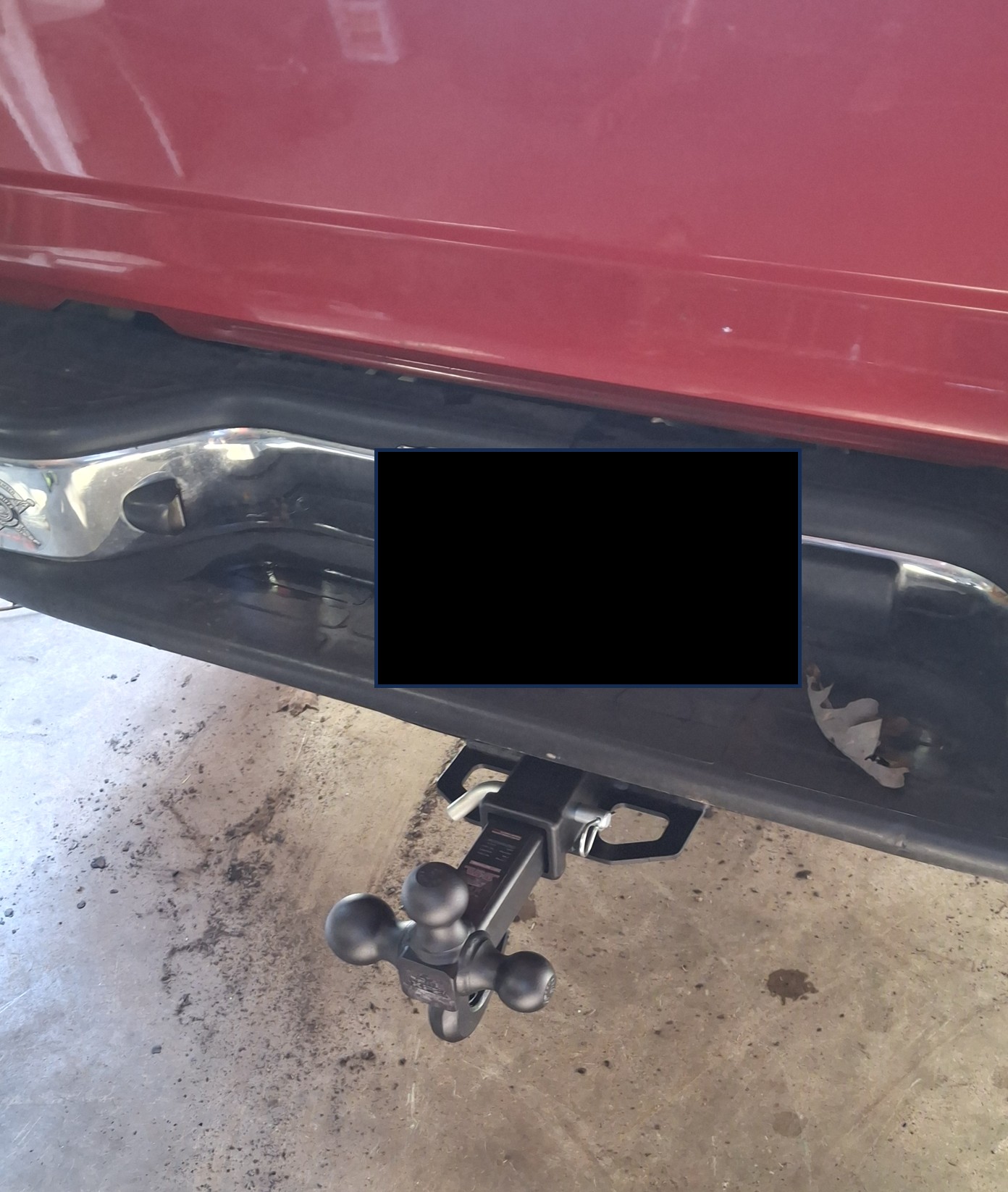

The truck is severely rusted.  The bumper is almost gone, just a shell of chrome.  So I added a new "class 4" hitch.  If I actually pulled 10,000lbs, the truck would probably split in the middle though :(
Custom hitch for the chipper to pull the garden wagon behind with various tools.  I didn't start on the garden wagon repair.  I was waiting for the pest control company to eliminate the hornets swarming around it.
