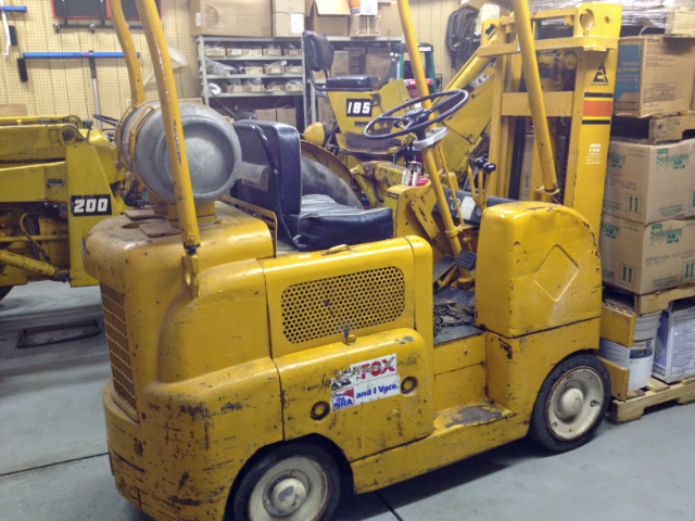

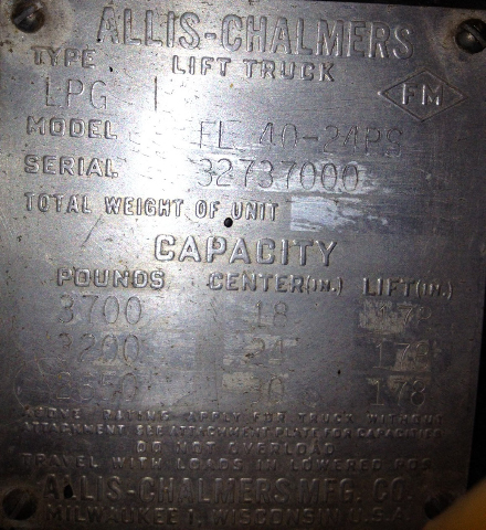

Hello.  I am new to this forum and new to an AC Forklift with a nameplate on it that says FL40-24PS lift capacity 3700 lbs and fueled by LPG.  I am trying to find out what engine it has in it.  It has a Delco Remy distributor 1112602 in it and the gentleman at NAPA says that was in use between 1958-1964.  It is 4 cylinder.  Attached are some pictures.  Any help is greatly appreciated.  I am trying to do a proper tuneup.  Thanks in advance.
Rick

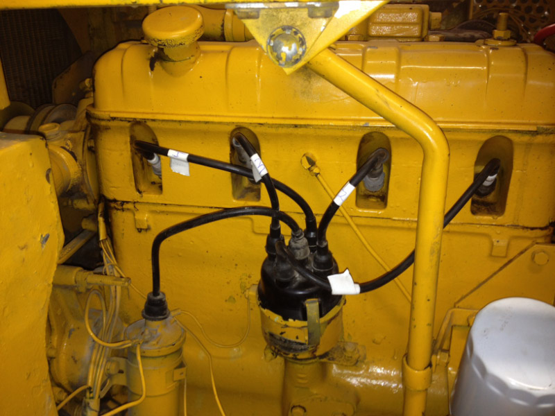

Hi There I was looking at your pics have you got the firing order correct ,your lead is maked no 4 is on no 3 plug
hobbit out

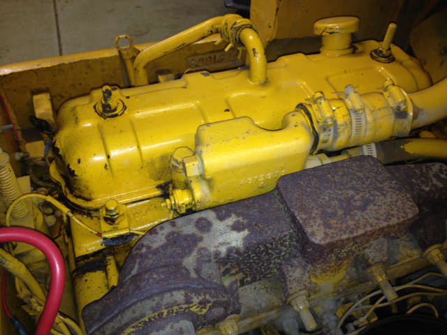

looks like a d15 engine 149cid or 160 cid. that is what was used in the 500

You are correct, I mislabeled the leads as far as the firing order- I just put the labels on expediently from the front of the forklift(rear of the engine) so I could put them back on the correct sparkplug.  Thanks for looking and replying.
Trying to find info on the engine so I can get the spark plug gap, dwell angle, and point gap.

Could you tell me who made the d15 engine. I am been researching and I see Buda, Continental, and Waukesha engines were prevalent in the late 50's, early 90's. Just trying to find the correct engine electrical specs. The firing order is stamped on the engine casting- There just is no engine plate.   Thanks,    Rick.
Carl Ohio View Drop Down
Location: Johnstown OH
Points: 9
Post Options Post Options   Thanks (0) Thanks(0)   Quote Carl Ohio Quote  Post ReplyReply Direct Link To This Post Posted: 22 Dec 2011 at 4:01pm
Hi I believe that is a 4B153 Buda engine It is a wet sleeve design and parts should be avail from NAPA possibly car quest and maybe some at auto zone
hope this helps

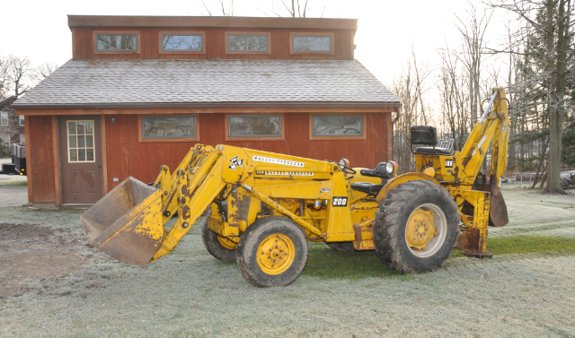

  Hey, Rikker, is that a Massey-Ferguson hoe sitting behind the forklift?
rikker View Drop Down
Joined: 20 Dec 2011
Location: Lockport,NY
Points: 4
Post Options Post Options   Thanks (0) Thanks(0)   Quote rikker Quote  Post ReplyReply Direct Link To This Post Posted: 22 Dec 2011 at 6:28pm
Ooops- Posted reply w/no content.
doctorcorey- yes, it is my favorite toy - My 1966 MF 2135 industrial Tractor w/200 loader & 185 hoe.  so cool of you to notice.  Bought it 25 years ago from a gravedigger to dig my waterline/septic field and clear my property.  2900 hours on it and just had the injector pump rebuilt last month and now the Perkins AD3-152 diesel purrs.  After getting it in perfect working order, I thought it was time to do the same to my AC forklift.
Rick
