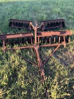

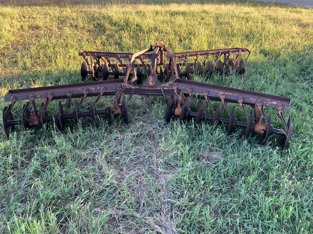

I have an Allis chalmers drag disk , I was curious if any one would be able to identify it by model number ect . It has a couple bearings out on the gangs and I figured it may help trying to find parts

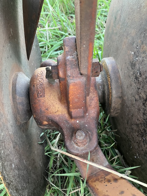

Right there on the bearing housing is a part number to get you started.

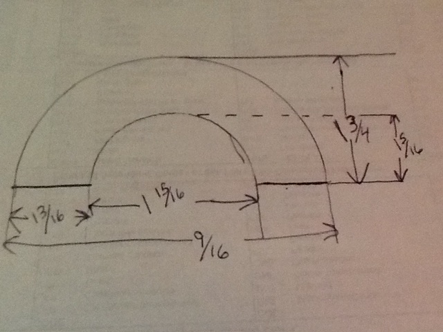

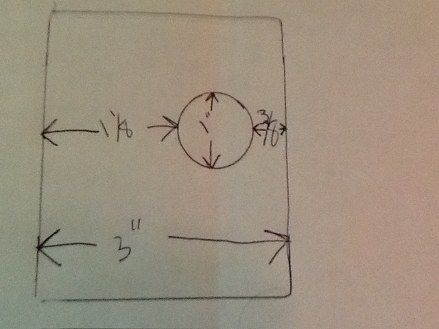

#9 pull type   bearings are wood  made of  rock maple    most folks make there own    off the top of my head  inner dia is 2" and outside dia is 3 1/2"    soak in hot oil bath  before install then grease initially and after  every few hours of use
some guy out in Minnesota was advertising he had some NOS ones  talked to him on the phone  wicked nice ... said he would call back with some measurements  ...never did

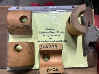

Post Options Post Options   Thanks (0) Thanks(0)   Quote juniorp53 Quote  Post ReplyReply Direct Link To This Post Posted: 10 Oct 2023 at 5:54pm
talked to these folks few years back    explained to them over phone what i had and seemed like no problem for them

I think I kept a nos for future measurements.
