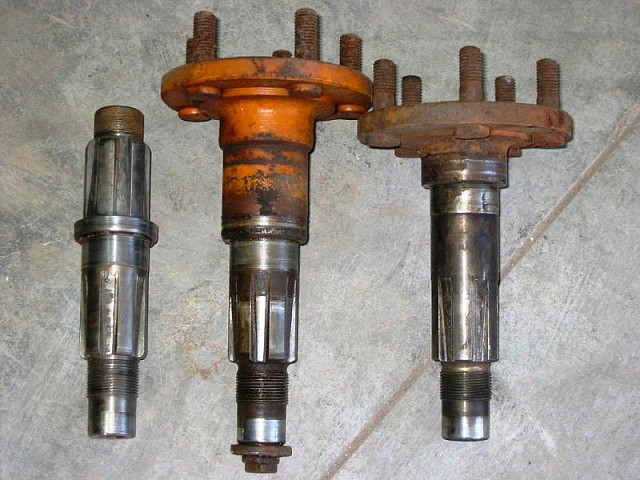

Nathan (SD) View Drop Down

There is one more if you use the first B axle stub with the splined 5 stud adapter hub,
