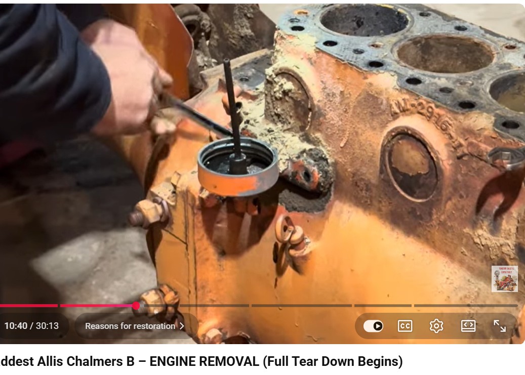

might be a good idea to look at the impeller on the water pump ???  NExt time you have the head off, stick an air nozzle / 1/4 inch rod,  down the water ports around the cylinder sleeves and poke around, blow to stir things up... then flush.

I might try something like this:  remove the carburetor or manifold to gain clear access to the block's coolant drain hole, which I think is 1/4" pipe thread (an actual 1/2" diameter hole). Remove the petcock from the block to get a large of hole as possible. Fabricate a 1/4" copper tube or a 1/4" steel brake line say about 6 inches long to fit into the hole in the side of the block. Bend the tube to go around the corner to try and aim towards the front and back of the block. Connect this tube to a pressure washer and start in, flooding the lower block area for a short time and let it empty itself. I don't think faucet water pressure would be adequate enough to bust up the rust, but maybe. When the color of the water becomes pretty clear, call it good.

to expand on Dr idea... i think there are 3 freeze plugs on the side of the bock behind the oil filter and mag.... you might knock one out and take a look !!!
