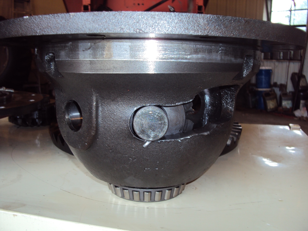

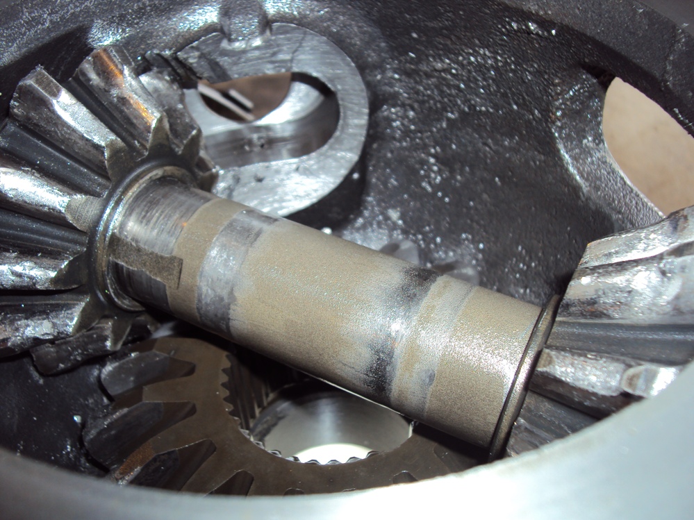

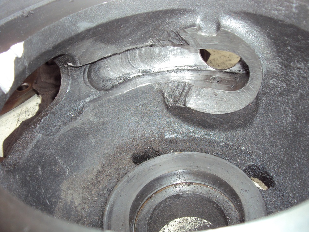

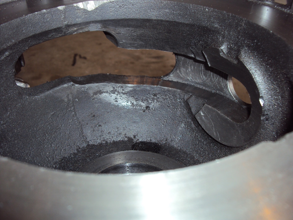

This is the differential carrier from  an 8030 a few years back.
Points: 23485
Post Options Post Options   Thanks (0) Thanks(0)   Quote DrAllis Quote  Post ReplyReply Direct Link To This Post Posted: 17 Feb 2026 at 8:23am
That's pretty cool, Lynn. For sure when he placed it in "park" on a hill it rolled another couple of feet !!!
