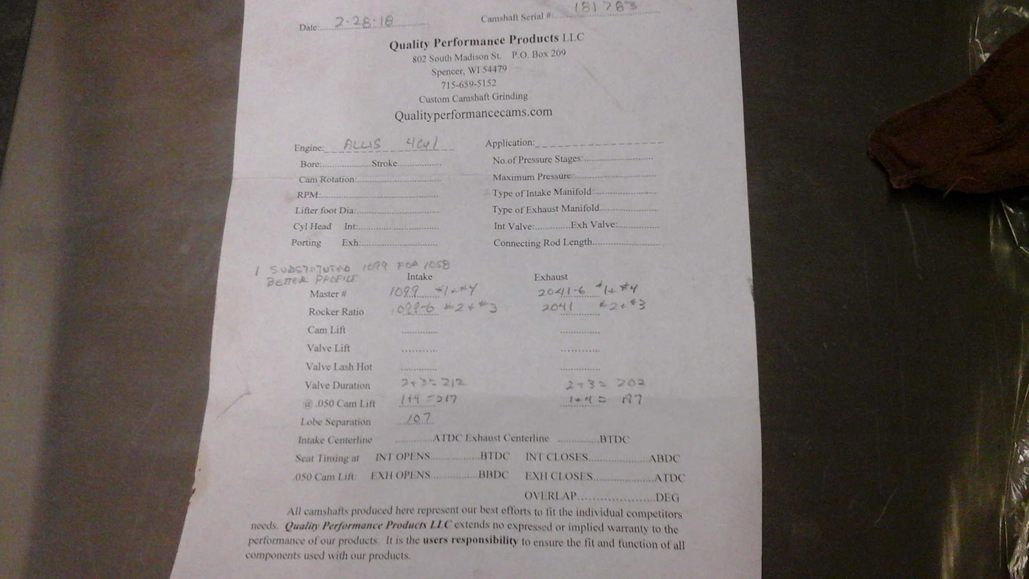

Post Options Post Options   Thanks (0) Thanks(0)   Quote Robacpuller Quote  Post ReplyReply Direct Link To This Post Posted: 27 Oct 2019 at 7:12pm
Quality performance products in Spencer Wi.
ph. Number 715 659 5152.
They did a 4 master grind on my D17 cam. Wi 50 does a lot with them.
Give me a P.M. or ur cell number. I will give u a copy of my cam card.

I can't get my text to go through. I am posting it here.
