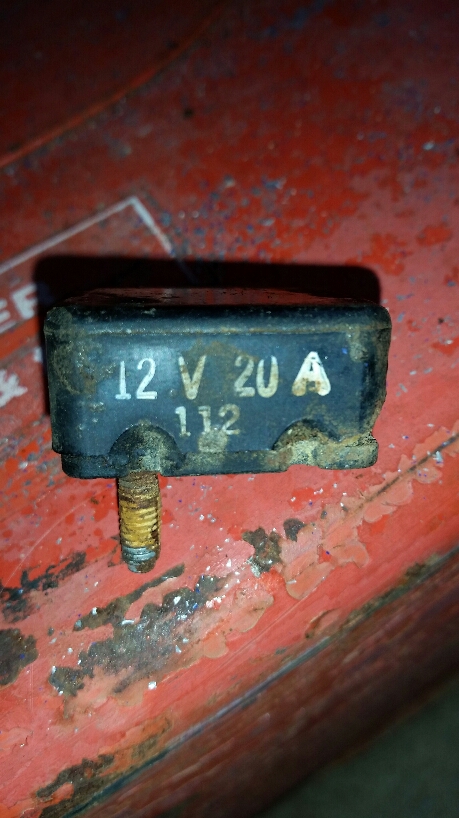

Sure sounds like it could be the circuit breaker. I have had them go bad or the post corrode off. The wire usually has a sleeve type connector that pushes on the threaded post. You can loose connection there as well. Some folks will cut the sleeve off and put a connector on the end and tighten it with a nut on the post.
The last breaker I bought was at oreillys auto. It was around $3 but the thing i liked was that is was built here in the USA by Littelfuse. Can't buy many things that are built here anymore.

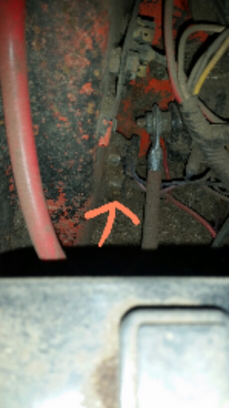

Here is where the circuit breaker is located.

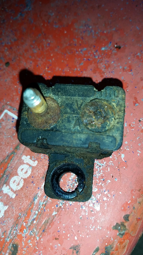

Here is a picture of the circuit breaker. One of the post had corroded off.
