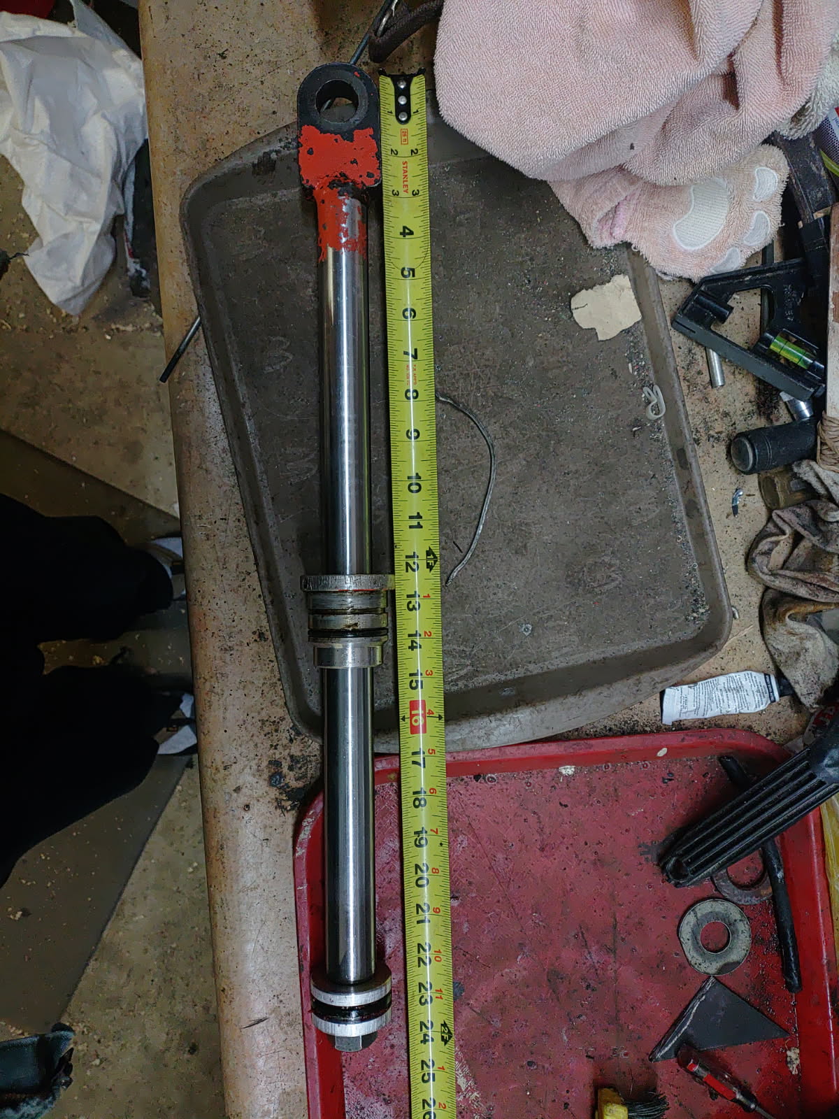

Looking where to find a rebuild kit for my tilt hydraulic cylinders on a 430 loader. Anyone have an idea or part number? The dealers have not been able to help so far. Thanks

Update: research leads me to the cylinders being a japanese manufacturer sub contracted out by Hinomoto . The barrel is approximately 19 inches with a 2.5 inch bore and a 1.5 inch rod. Any info will be appreciated

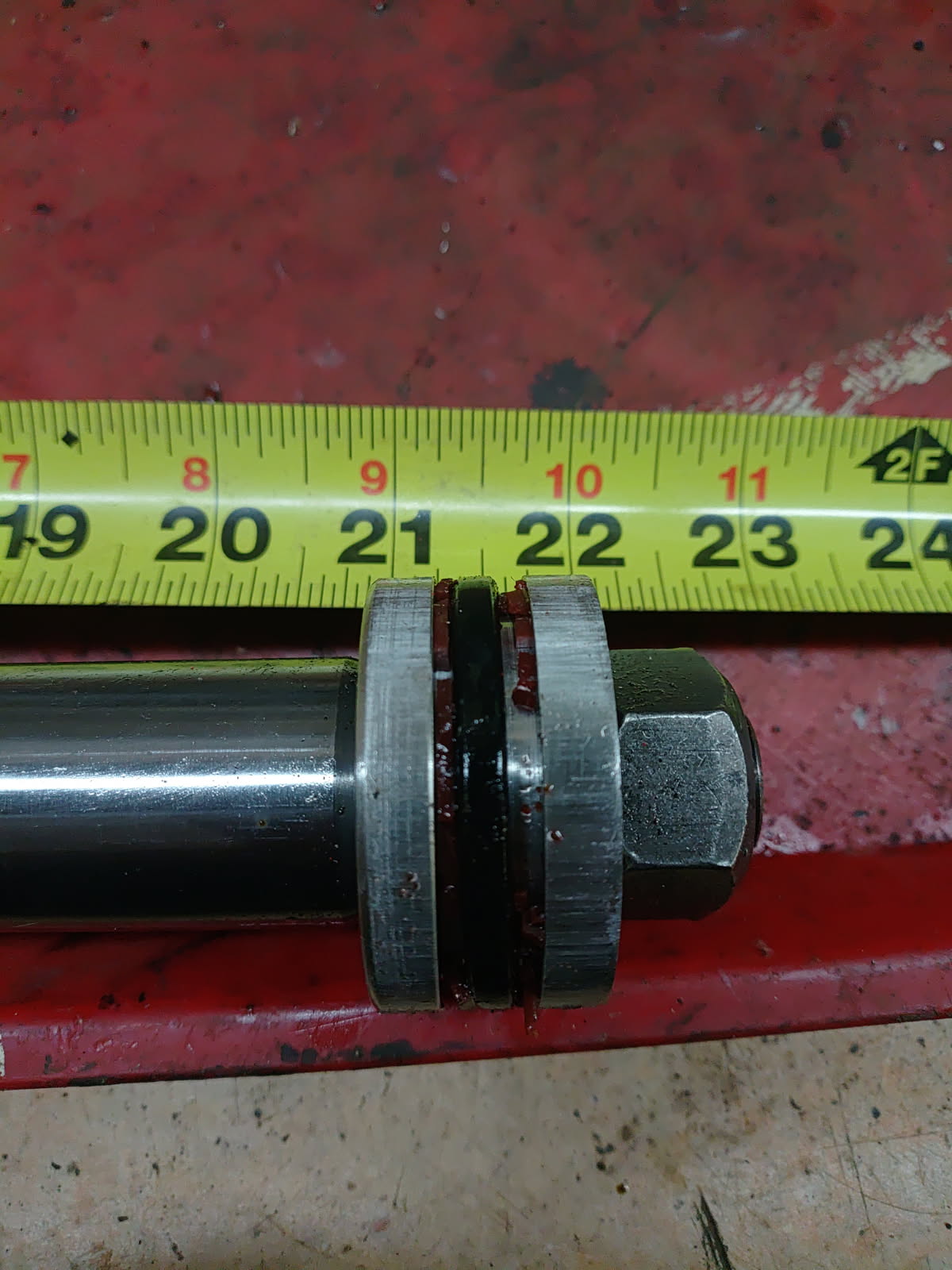

Post some pictures of the Cylinders, especially the Piston end so we can see what style they are.

here are pics of the rod and the gland .... any help appreciated
The rod is 1.125 with a bore of 2 inches
There are no markings on the cylinder with a 3/4 inch wide tang attachment on both ends

Yes take them to a hydralic shop and they will have everything you need to rebuild it, then go home and rebuild

A company named Baum Hydraulics can help you.  I do not have their address but their phone # is 800-642-9333.
