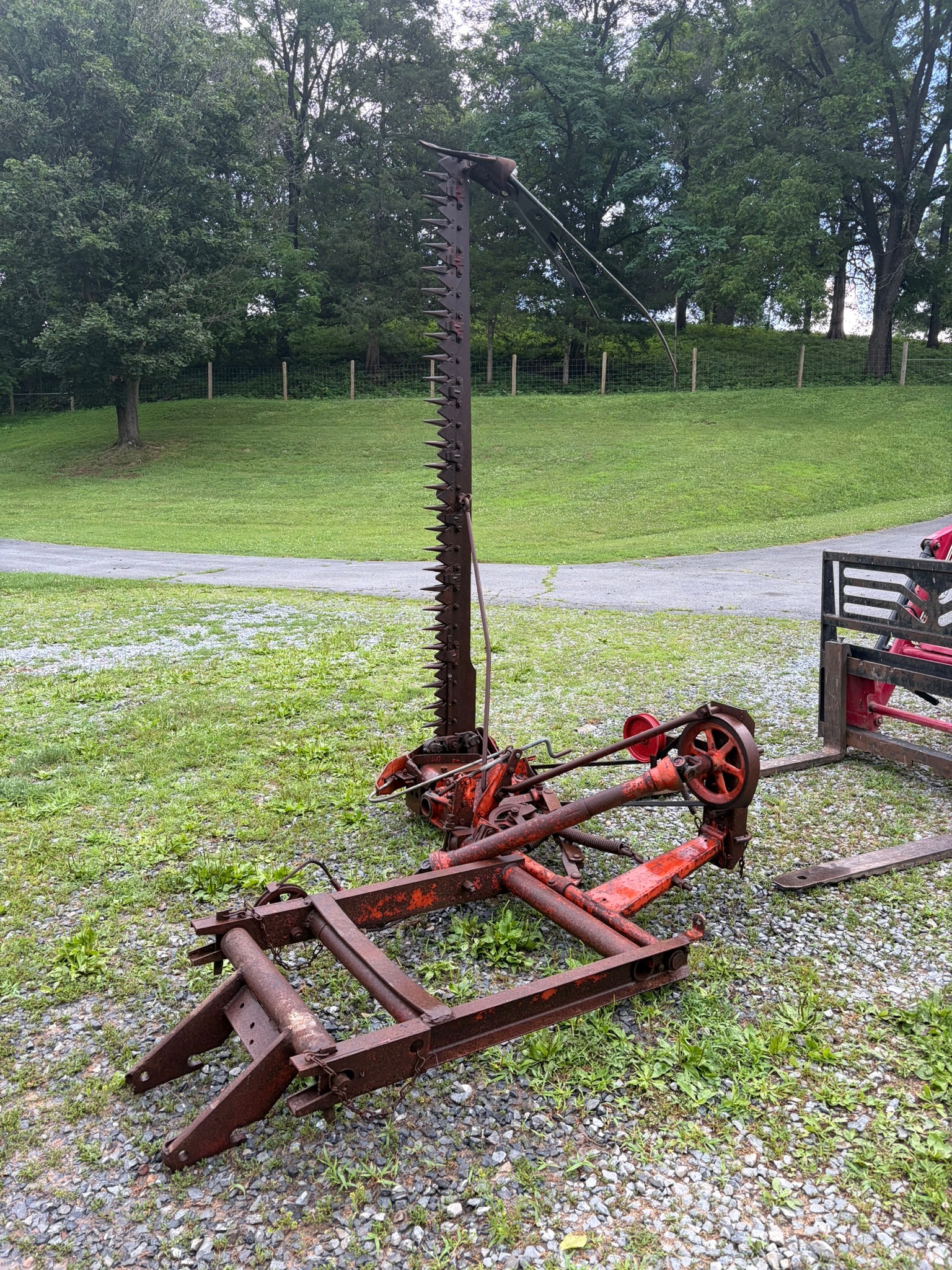

Post Options Post Options   Thanks (0) Thanks(0)   Quote AC720Man Quote  Post ReplyReply Direct Link To This Post Posted: 07 Jul 2026 at 10:23pm
Not much paint left but it’s in decent condition. Has the rear pto for the conditioner which I doubt I will use. My 82S setup is better for that. Spent today greasing and oiling things up. I took the mount to my machine shop to have a repair done. It is missing the spring anchor that bolts to the tractor so I will have to get that fabricated. Otherwise, looking forward to be mowing with it in a few weeks.

Post Options Post Options   Thanks (0) Thanks(0)   Quote Unit3 Quote  Post ReplyReply Direct Link To This Post Posted: 07 Jul 2026 at 11:14pm
Just looking at that picture and I get the dreaming about a hydraulic valve that could send oil to the cylinders to run the snap coupler. On the other side of that valve, send oil out behind to a hydraulic cylinder that would raise the cutter bar.
