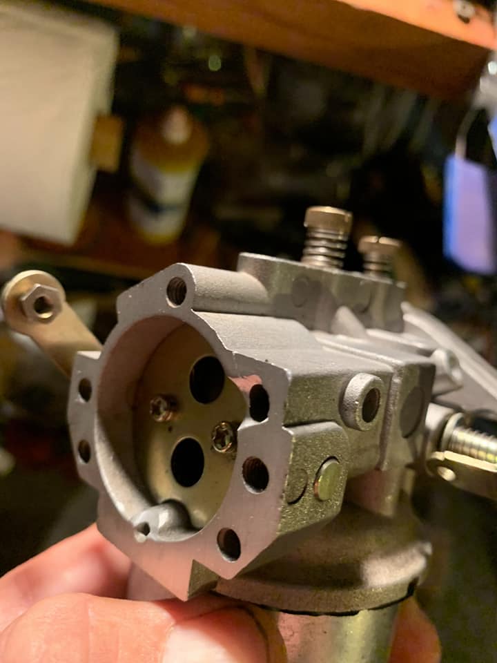

Forgive me for being lazy but I can’t find the modification procedure for the Kohlor carb to install on my 720. Dremel tool mod for the intake horn I think? Thanks for any help in advance.
Rob
Points: 5690
Post Options Post Options   Thanks (0) Thanks(0)   Quote AC720Man Quote  Post ReplyReply Direct Link To This Post Posted: 09 Aug 2024 at 7:17pm
I have the engine timed on the money, she runs great, just need to know the final step. Horizontal cut of the top right hole? Bottom hole vertical cut? Can’t remember and can’t find the instructions! Dang it!
How deep to make the cut and if I’m correct?

Post Options Post Options   Thanks (0) Thanks(0)   Quote AC720Man Quote  Post ReplyReply Direct Link To This Post Posted: 19 Aug 2024 at 3:11pm
Finished up the carb upgrade over the weekend. Went well and I am happy with how she runs. A full test this week under load of the belly mower will prove that it can handle it. Did a short run with the mower and it did fine but want to do a full 1 1/2 acre test before I call it awesome. Did a compression test after installing new head gaskets after cleaning the carbon out. 112 psi so I’m tickled with that. Leak down test also showed no issues in the engine. Only has 689 hours on it
