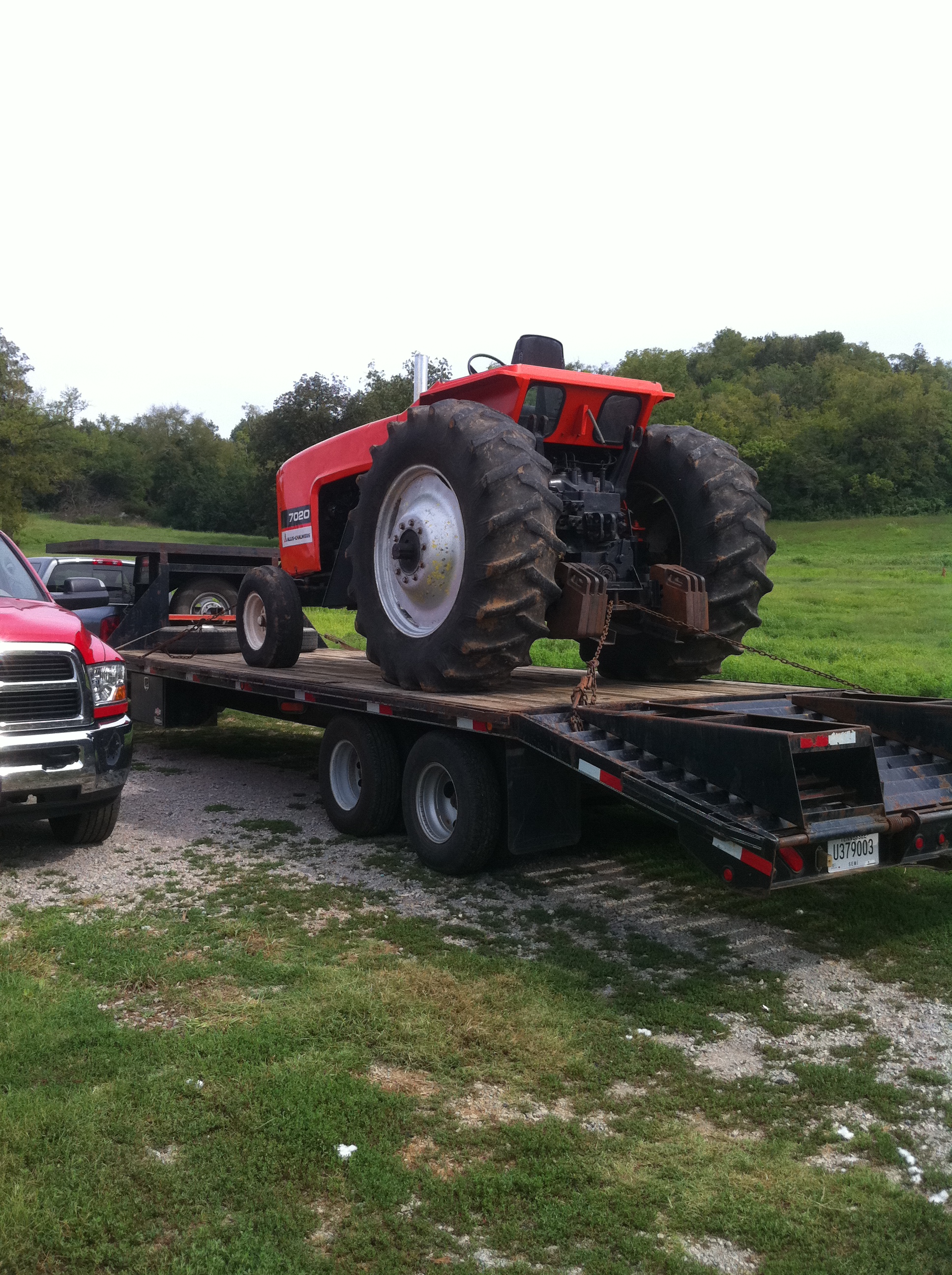

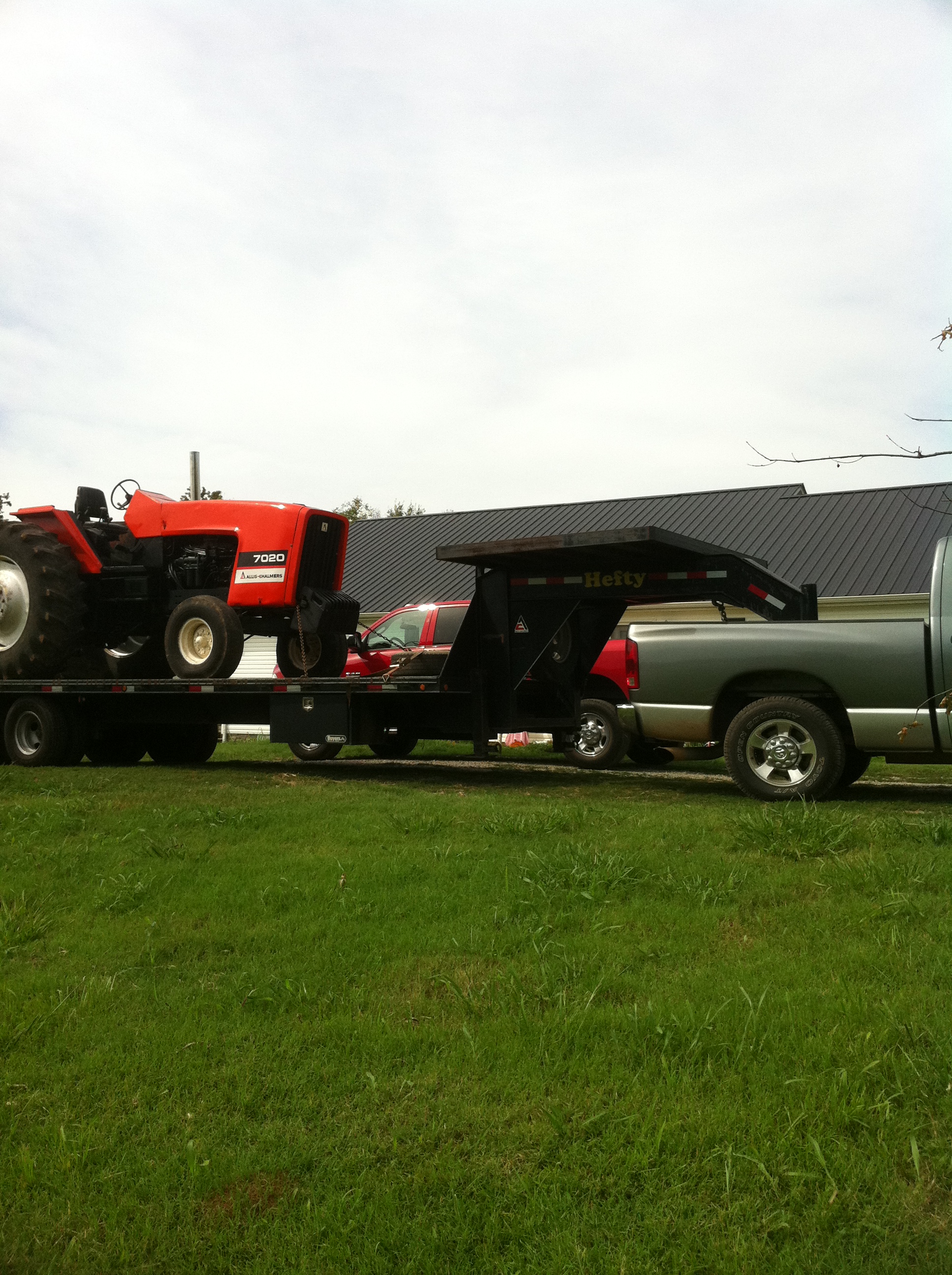

Check out my Pulling Tractor
7020AC with a 7045 426 Engine. Many other upgrades as well. No more Rotary Pump====Bosch Inline!!!!! Tell me what you think!!!!

I'm not into pulling but it looks pretty sweet setting on the trailor.

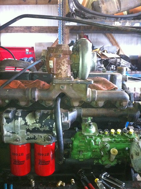

Lets see more of the engine and what you got for turbos and injectors. More specs!! lol

Please excuse the paint colors!!!!
4440 John Deere Injector Pump= Stock
Turbo HX40 from 8.3 Cummins= Works Very Good!!!!
Injectors are stock Bosch Injectors.
Fuel is Maxxed out on stock pump,runs very hard for what it is.
Makes about 40 pounds boost, with a little fire out the top of pipe!!!!

What did you do to the tractor to hold the power? PD trans?

Very nice !! Luv the 7000 series style !!Just curious on the engine setup, a 426 wasnt factory on the 7020 ; did u get the ok from the guys you pull with ?Most of the time it has to match factory sheetmetal to engine

Also are they stock 7045 injectors or 7080 injectors?

Still has stock 7045 Injectors, Power Director is a 7080 complete Unit they have 1 more clutch disc on low and high than 7010-7060. Will be pulling September 22nd at the pull I have been advertising in Tennessee on here.

Very nice tractor! Are you still using the factory connecting rods? I know they were definetly the weak link in these engines. How hard is it to cut the cab?

I have the 1-3/4 rods with lubricating jets on end and new rod bolts but that is all. Cutting cab was easy sawzall or torch.

If you are really using "stock" 7045 injector tips, they are only .0128" (4 holes) hole size. Tractor will make more HP and your injection pump will last longer if you switch to injector tips with .0200" (4 holes)hole size and set them at 2800 psi. You to have them made, they aren't available from AGCO that big.

I was using the stock ones I have switched to Mack truck tips that have a 9mm tip with the same spray angle as ac, had to drill head out. They are a good running injector, my diesel shop had these on hand. This tractor had the Bosch Injectors from Factory.

hey joe, when you put the mack tiped injectors in the engine, did you turn the injectors 90* in the head? bc if you didnt, your spraying fuel onto the head. Im putting the same nozzles into a set of injectors and i found it out after i bought the tips.

I agree. Be sure the injectors are oriented correctly for the Mack nozzles. This will require a different injector hold down if needed. There are a few different Mack nozzles. You may have one that works without turning the injector in the head.
If you ever get to a point where you have 400 or more cc's of fuel delivery from your pump it will help to dual feed the injectors and nozzles as well. The stock fuel passage diameter through the Bosch injector body is small. Like .062" dia. Your stock A pump is probably no where close to that yet so you should be fine.
Excellent choice on the turbo for what you have. Post video when you can.
