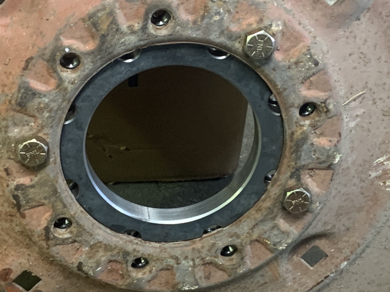

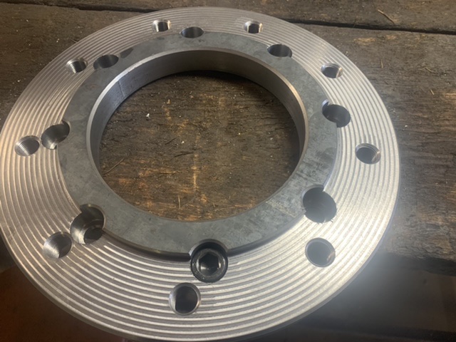

Post Options Post Options   Thanks (0) Thanks(0)   Quote cms Quote  Post ReplyReply Direct Link To This Post Posted: 21 Aug 2023 at 11:23am
These will work.

Post Options Post Options   Thanks (0) Thanks(0)   Quote cms Quote  Post ReplyReply Direct Link To This Post Posted: 22 Aug 2023 at 8:05am
Weight is around 20 each with bolts. Made out of 1” material. Probably could lighten up some. Will have to try that on the next run. Have 1 set ready to go.

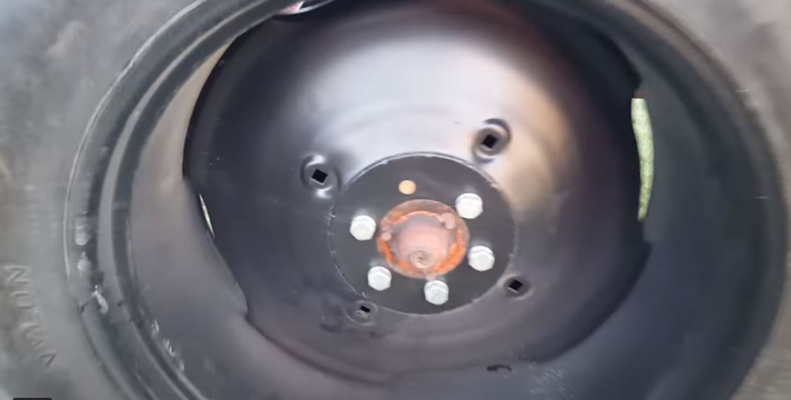

Post Options Post Options   Thanks (0) Thanks(0)   Quote CAL(KS) Quote  Post ReplyReply Direct Link To This Post Posted: 23 Aug 2023 at 7:50am
When i built my UC puller,  I had a 1/2 center plate machined to my bolt pattern and welded it into the wheel center after cutting it to fit.  While i was working on these,  i removed the entire center from the rim and spaced it to allow about 1 inch clearence of the rim to the UC final drive.  34" tires are not tall enough to clear the finals and 38" would be way to fast, this put me narrower that factory stance for hauling but still spaced out for pulling.  lighter than adapter but not interchangable now, but i can make 5000 with me on it running max tire size. 16.9x34.  Yes that is a locating dowl pin,  UC used 5 bolts and a blank hole with a dowel.  No threads in #6.  if i can ever get a damn engine built, maybe i will be able to turn them.....
