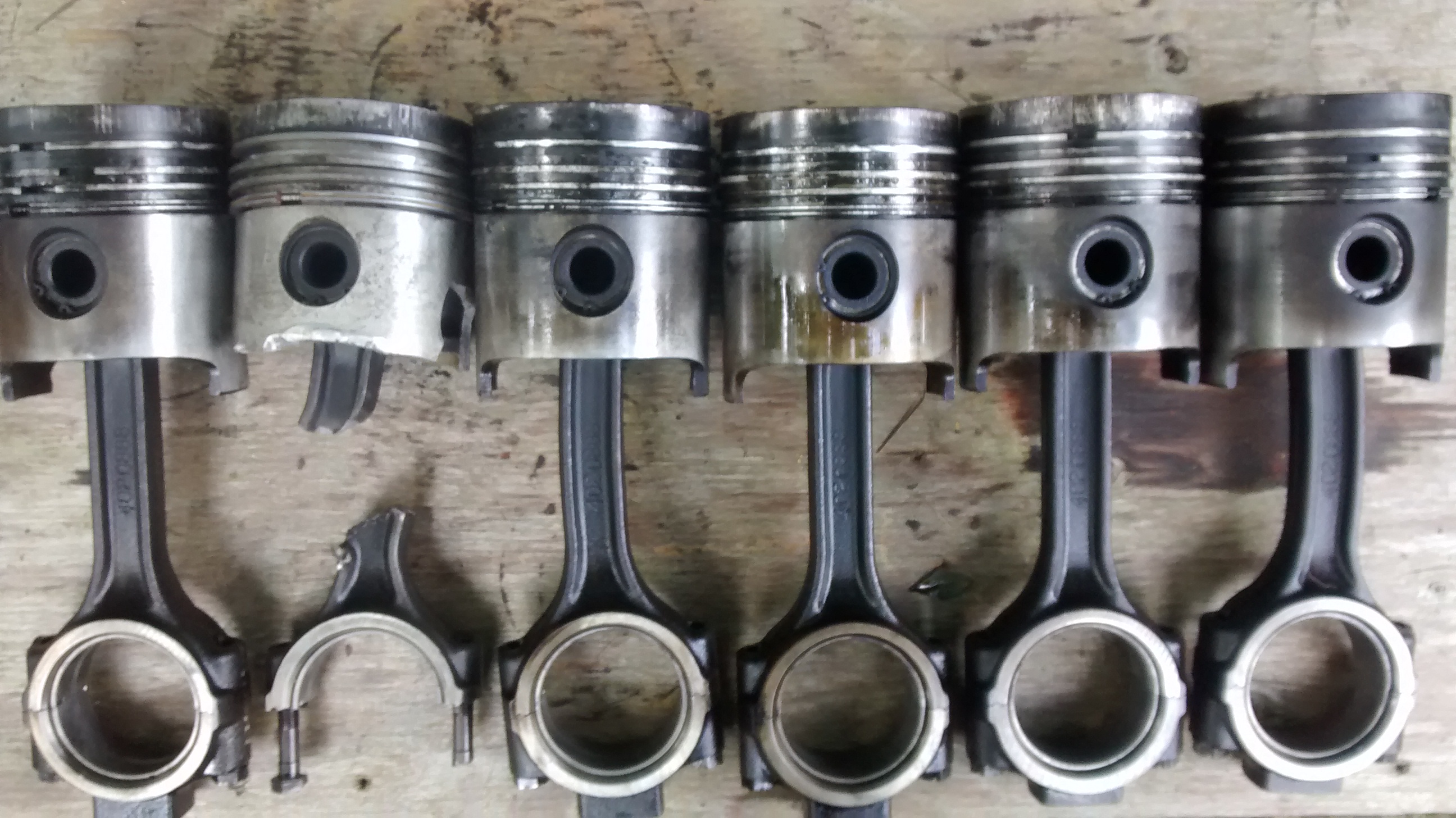

My question isn't on how to make power but at 400 or so horsepower what weak points are going to be an issue with a 301? The bottom end is my main concern but I'm sure other things should be taken into consideration.
Points: 23484
Post Options Post Options   Thanks (0) Thanks(0)   Quote DrAllis Quote  Post ReplyReply Direct Link To This Post Posted: 04 Oct 2018 at 7:19am
Bending connecting rods would be your first concern.

Will the crank still be happy or is it time to get a custom crank made?
Points: 23484
Post Options Post Options   Thanks (0) Thanks(0)   Quote DrAllis Quote  Post ReplyReply Direct Link To This Post Posted: 04 Oct 2018 at 12:09pm
We still use a stock 200 crankshaft at 1200 HP. Didn't girdle the main caps until over 800 HP.

I knew the rods weren't that great wasn't sure about the crank. Will just the 7080 injector tips be enough or will they need to be reworked?
