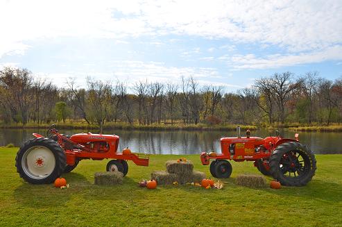

I have 15.5-38 on my wd45 with a diesel rear end. track seed is between 3mph and 2.4 under full load. which would be the same speeds as a regular wd45 with 14.9-28. so same power/speed more rubber on the ground.

Nice tractors Fields!!!! Good pic

Very neat picture and tractors !
