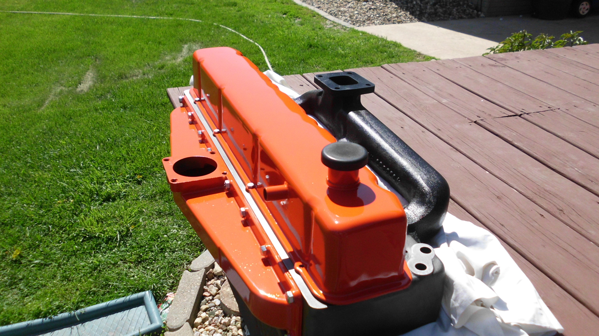

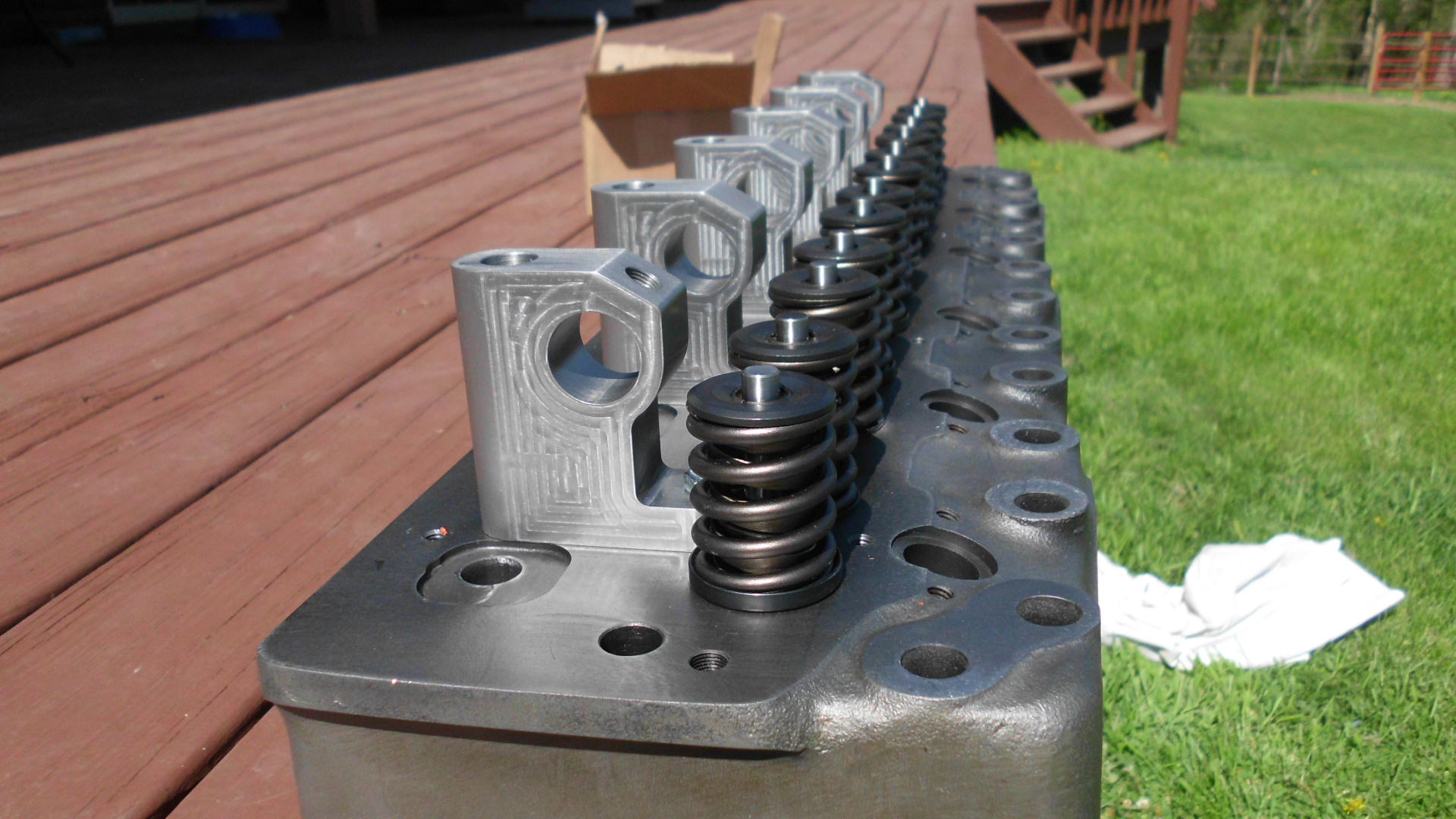

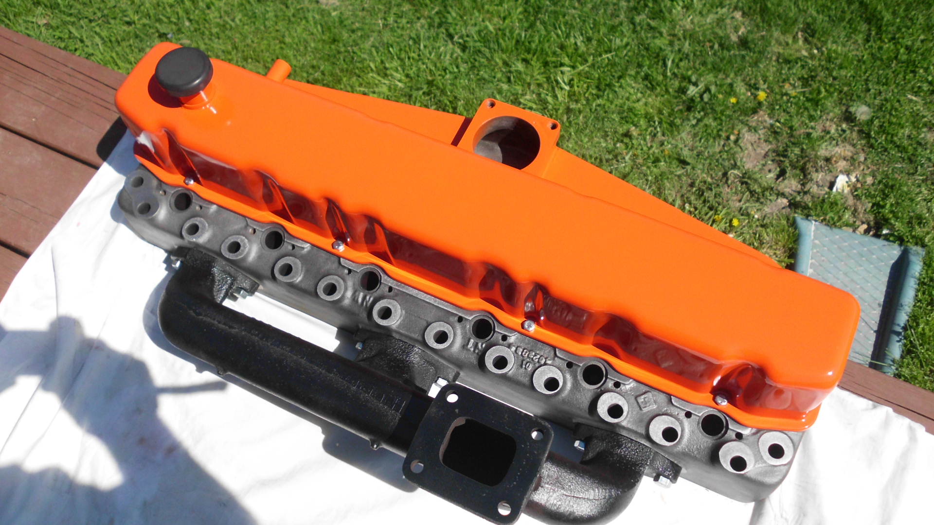

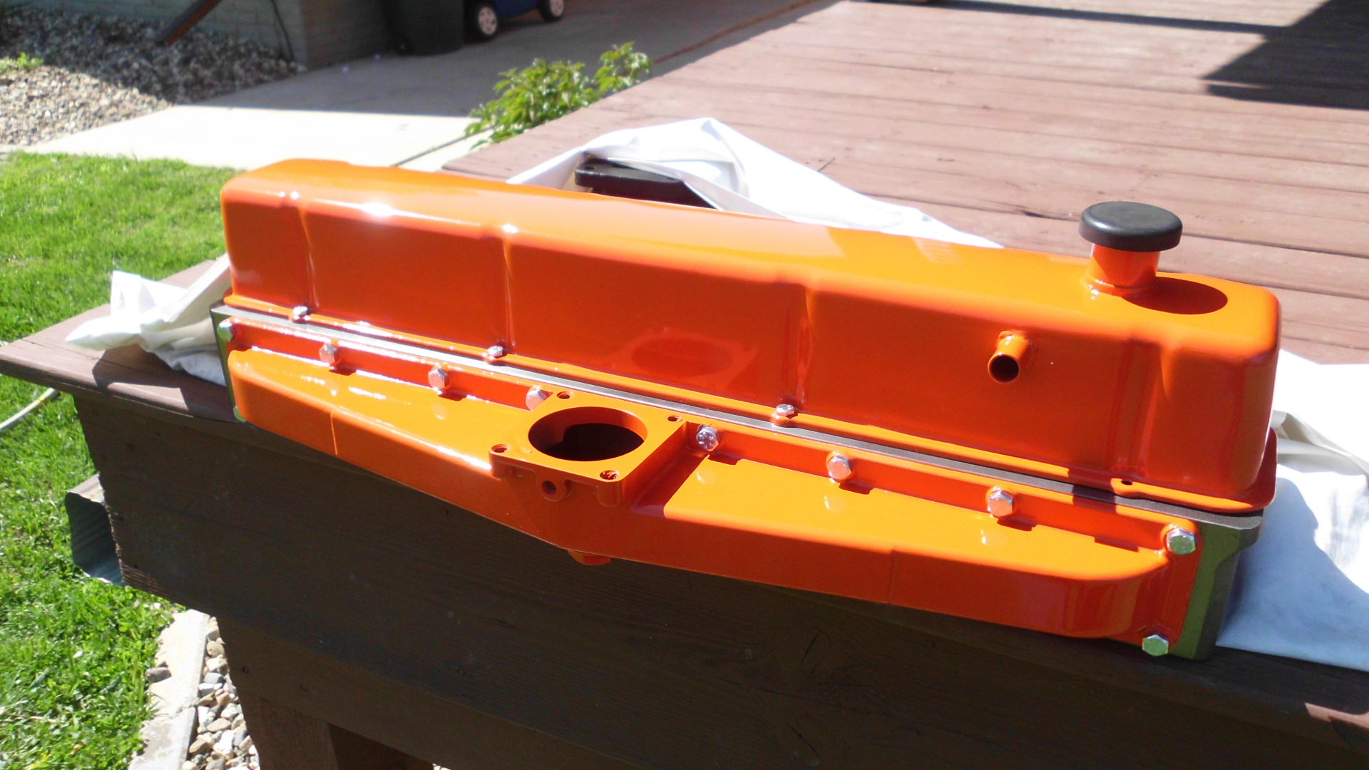

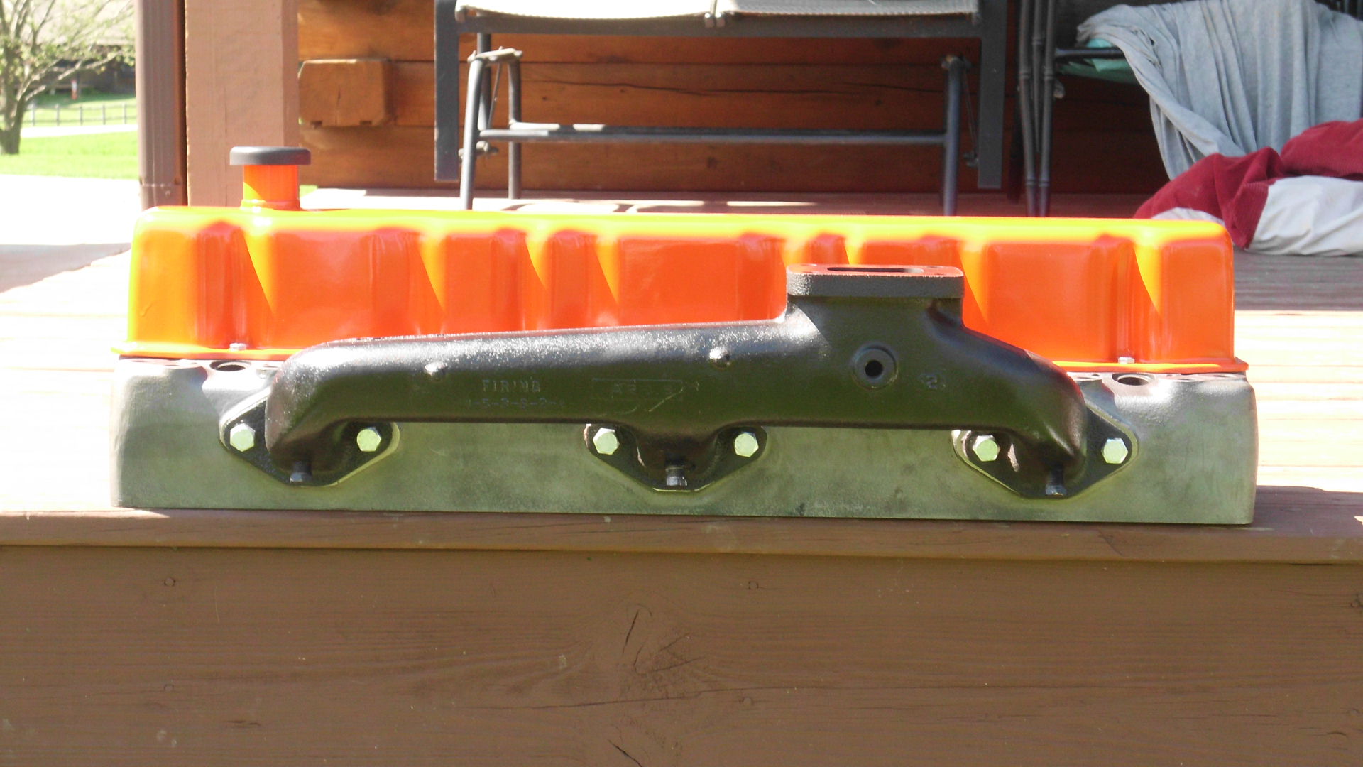

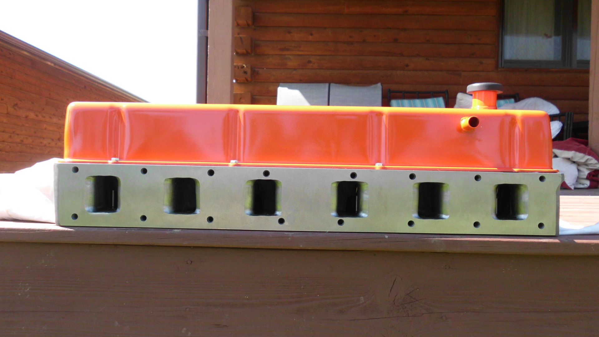

The second one of these so far. Enjoy the photos. If anyone can help me size them correctly it would be much appreciated.

Post Options Post Options   Thanks (0) Thanks(0)   Quote DougG Quote  Post ReplyReply Direct Link To This Post Posted: 13 May 2013 at 7:40pm
Very nice,, completely home made or just doctored up      ?

Post Options Post Options   Thanks (0) Thanks(0)   Quote O.P.S. Heads Quote  Post ReplyReply Direct Link To This Post Posted: 13 May 2013 at 7:51pm
It's a new, solid casting not an OEM head with the water jacket filled. This allows for improved intake and exhaust ports.

Awesome. I'm just curious if the exhaust manifold is on it for some reasons we talked about

Not on this one(and yes I know what you are talking about). The manifold is there just to illustrate how a stock manifold will fit. The intake side uses the 426 intake manifold bolt pattern so a 426 intercooler will bolt right on if need be.

How much bigger is a 426 valve? Im running a naturally aspirated 301 at 2400 rpm in antique farmstock and looking to get more power out of it.

Matt B. The 426 intake valve diameter is 1.835". A stock 301 valve is about 1.600 if I remember right. Depending on your bore diameter you can go with a bigger valve which will yield more flow yet. The ports are big enough. Flow bench results show that an OEM head with 426 valves will flow about 160 - 170 CFM on the intakes with a normal port and polish job. This head was at 240 CFM with 426 valves. The very first head was @ 285 CFM with 2.00 inch dia. valves. I am working to improve the port more yet and the goal is to get 265- 270 with the 426 valve.

Nice looking head. Do the sleaves have to be cut for the 426 valves on this head?

The valves in this head are located in the same position as an OEM head so if you are less than 4 1/8 dia. bore you will need to notch the sleeves so the valves will have proper clearance if you are using 426 sized valves.
It is not mandatory to use 426 valves. Depending on how the head is machined, smaller valves could be used.
