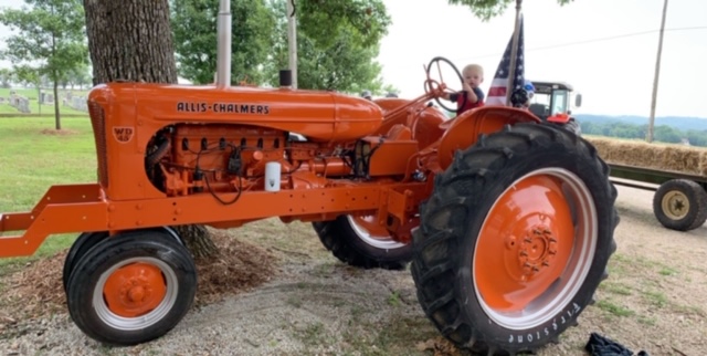

Post Options Post Options   Thanks (0) Thanks(0)   Quote Justin Vandy Quote  Post ReplyReply Direct Link To This Post Posted: 20 Jul 2020 at 10:44am
I finally got the project done. Eventually I am going to bump up the compression and run it on 110. Have a set of diesel pistons I am hoping I can make work.

Post Options Post Options   Thanks (0) Thanks(0)   Quote Steve in NJ Quote  Post ReplyReply Direct Link To This Post Posted: 19 Oct 2020 at 7:33am
Great lookin' Tractor Justin!  Good luck with it!
