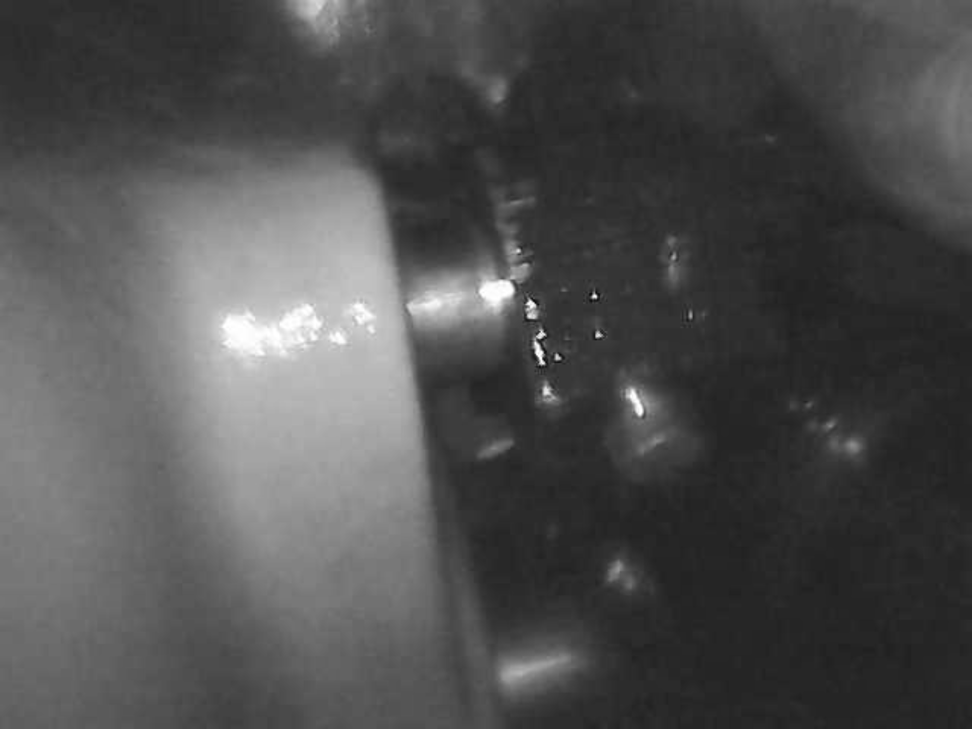

Pulled the shaft and it looks good.  Used a remote camera to go down though the dipstick and looks like the assembly that attached to the rod that passes through the housing is lose.  I have several manuals and none show the details in that area.  Has anyone had the same problem.  I’m pretty sure I will have to split the tractor.
Todd Walter
Points: 23493
Post Options Post Options   Thanks (1) Thanks(1)   Quote DrAllis Quote  Post ReplyReply Direct Link To This Post Posted: 16 Aug 2026 at 11:11pm
No split if you go about it right. So, the groove pin has worked out of its hole. Not common at all, but obviously has happened. Remove the cover and oil manifold on the right side where the brake latch pawl hangs from. You might want to unbolt the right platform and remove or at least lift it up higher. Let the brake pedals fall forward after unhooking rods and springs to get them out of the way. Looking inside with a good flashlite you will see what's going on. If the pin is missing, you need to get in there with a magnet and FIND IT !! before it runs thru any PTO gears. Maybe use a small mirror to hunt it down. I would replace the pin with a 5/16" grade 5 or 8 bolt about 2+ inches long and a locknut. Using an air ratchet (with a 1/2" wrench) the nut can be tightened up and you are fixed. There are oil tubes in the way and with an assortment of wrenches they can be moved around. Using a bolt it will be easier than trying to align and press that OEM pin back in place. This isn't easy, but easier than a split, because all the parts you remove to gain access must be removed anyway for a split.

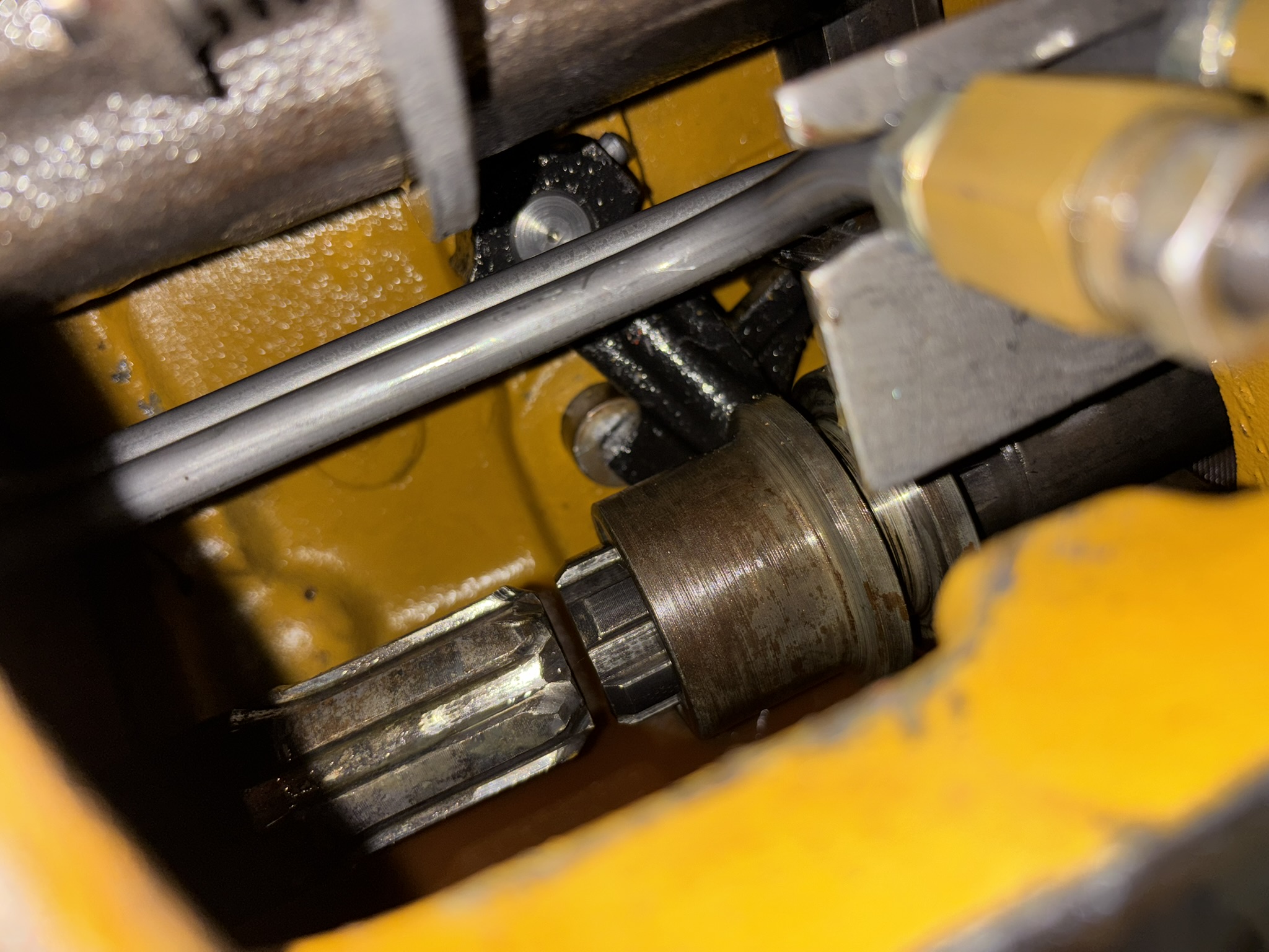

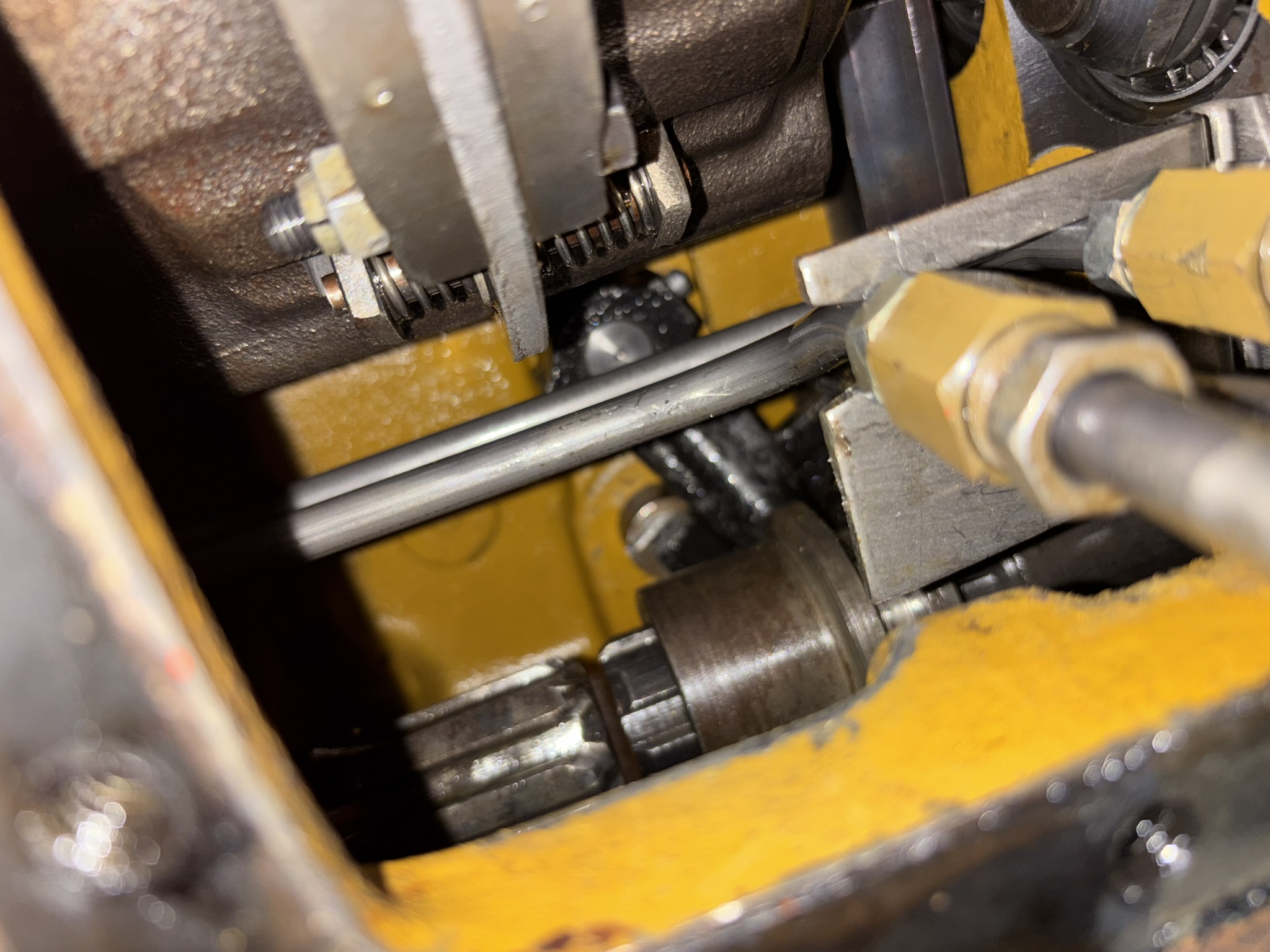

I took the fittings and cover off the right side of the tractor.  I can see the coupling and the pawl or what ever the device is called that moves coupling.  I cannot get the pawl to move.  Did not get real rough with it.  Is there a ball bearing or something on the end of the clutch pin to hold it in place?  Or does it look like it traveled too far and should be on the backside of the clutch pin.  Towards the back of the tractor.  Thank you for your help.
Todd Walter
Points: 23493
Post Options Post Options   Thanks (0) Thanks(0)   Quote DrAllis Quote  Post ReplyReply Direct Link To This Post Posted: 17 Aug 2026 at 9:55pm
Sliding coupler needs to be slid rearward to be flush with the front shafts end. The "shifter" has been thrust forward (I assume) violently and is now broken off the stop tab!!! That is why the coupler is too far forward. I don't know if you can get a bar shoved in there and pop the coupler back flush and make it work again or not. If you do, there will have to be caution used to not pull back on the PTO lever too far causing the same scenario again. The groove pin is indeed still in place and that isn't the problem.

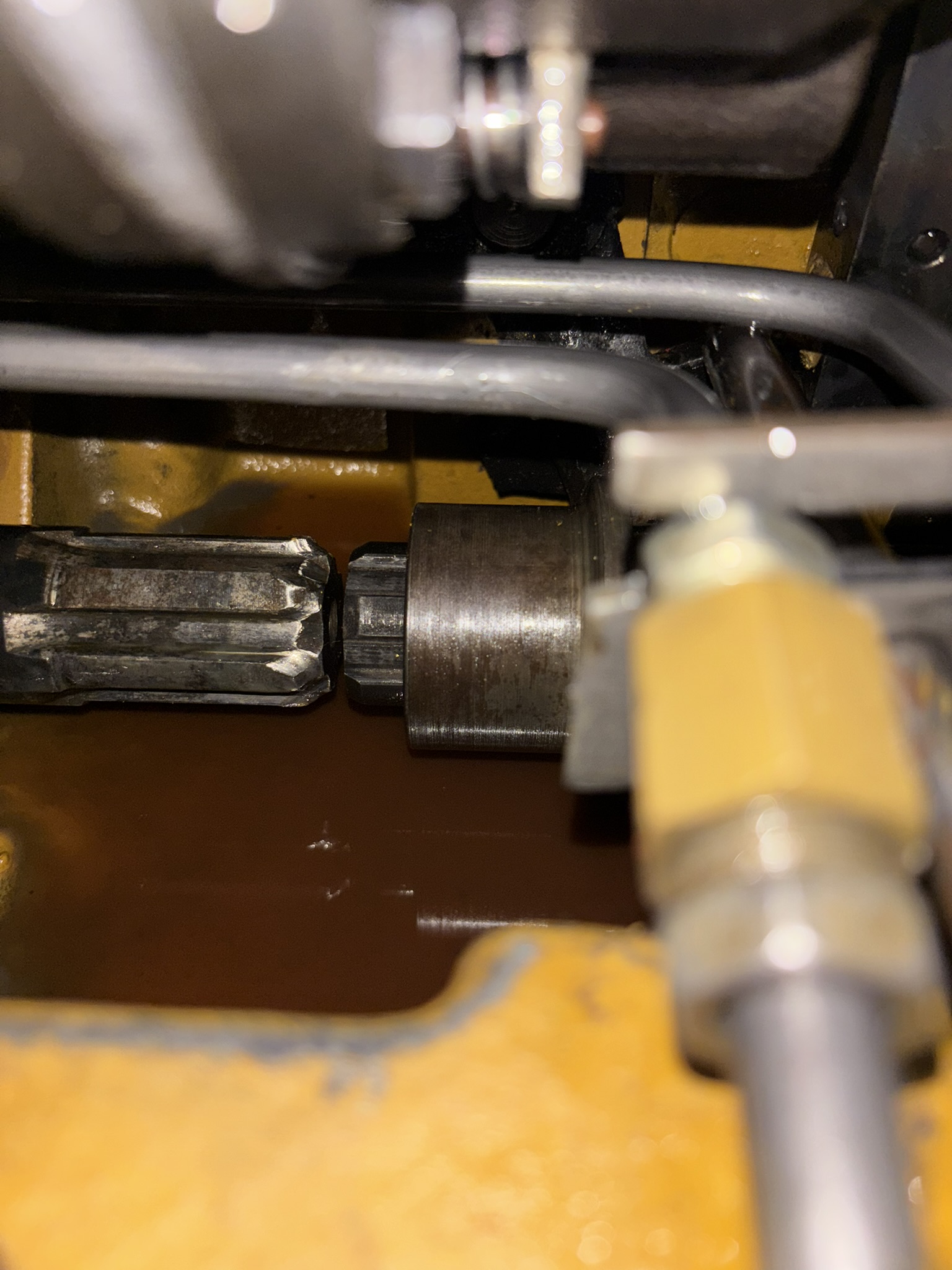

got the replacement installed.  First time I installed it and go the bolt tight I notice I had the coupling in backwards.Dead So i got some extra practice doing it again.  It was quite a trick to get everything lined up with one hand while sliding the pin in from the other side. After I got in installed the correct direction I noticed the coupling would not slide over the output shaft.  Pulled it out and notice burs on the splines.  Filed them down and it engaged as it should.  I used a grad 8 5/16” bolt in place of the role pine.  I tacked the nut on with a wire welder and used lock tight.
I think some one got hung up on the PTO lever when they were getting off the tractor.
Edited by Toddwalter - 1 hour 25 minutes ago at 1:20pm
Todd Walter
Points: 23493
Post Options Post Options   Thanks (0) Thanks(0)   Quote DrAllis Quote  Post ReplyReply Direct Link To This Post Posted: 0 hours 60 minutes ago at 1:45pm
Glad you got it fixed. I think the rear PTO shaft was burred and as a result the coupling couldn't fully engage. When using the PTO, a shock load was encountered, and the coupling was violently spit out of engagement and the stop got broken off when it hit the stub shaft that the detent spring and ball fit into.
