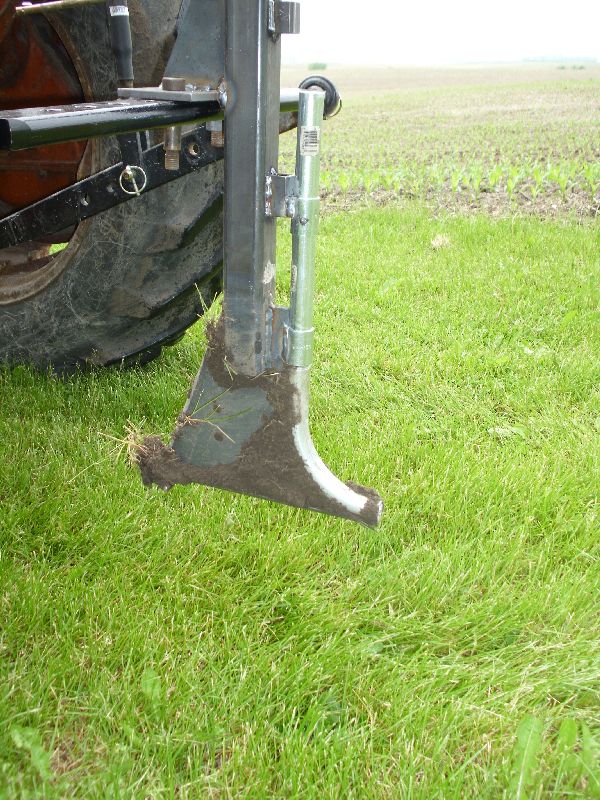

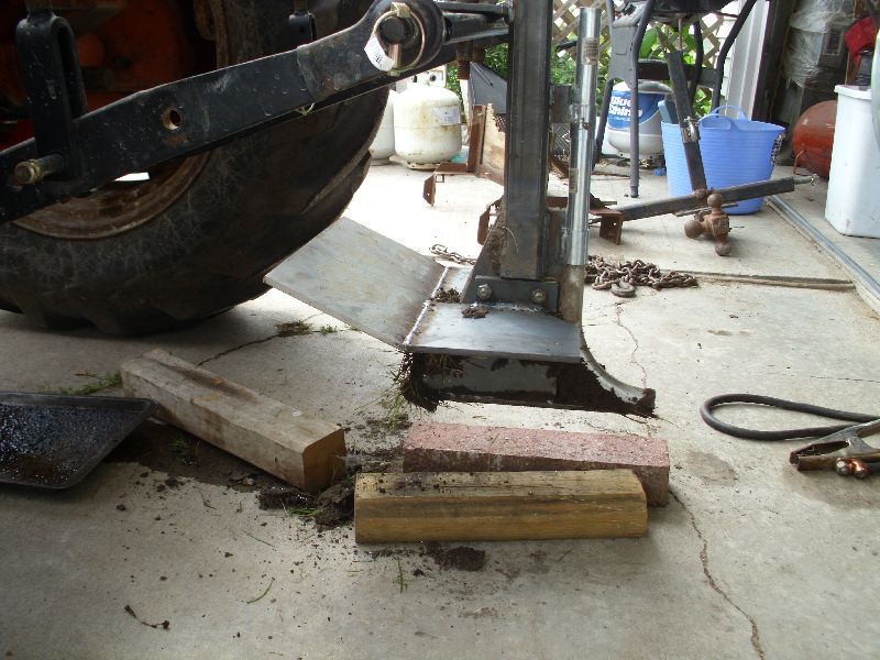

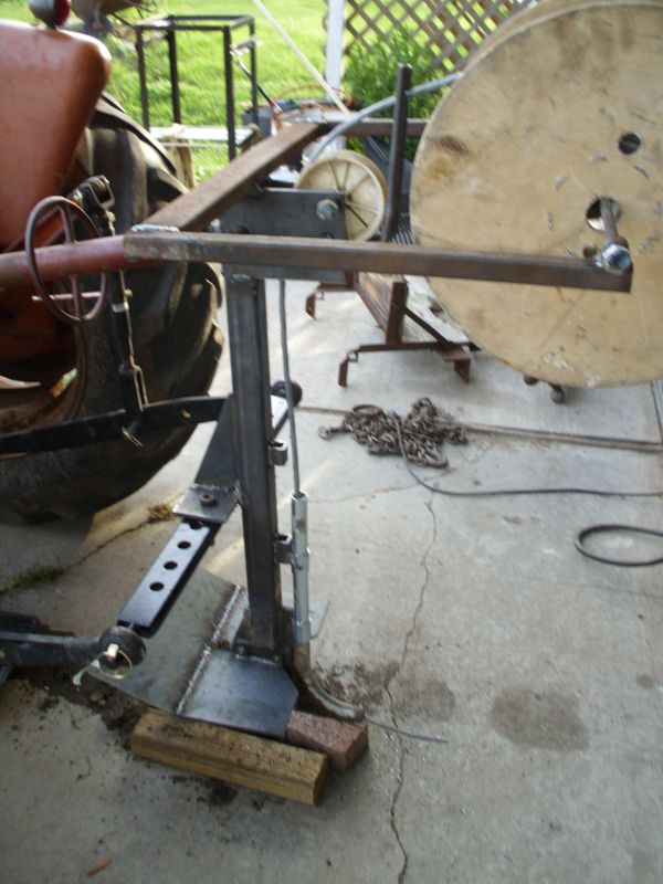

Just posting a gadget I had need for, and had a few minutes to slap together... for pulling invisible dog-fence wire.  I made it adjustable, so it can go down a little deeper... but don't need to go beyond about 6"... but here it is:
This is without the depth-control shoe...
and:
There's the shoe...
and:

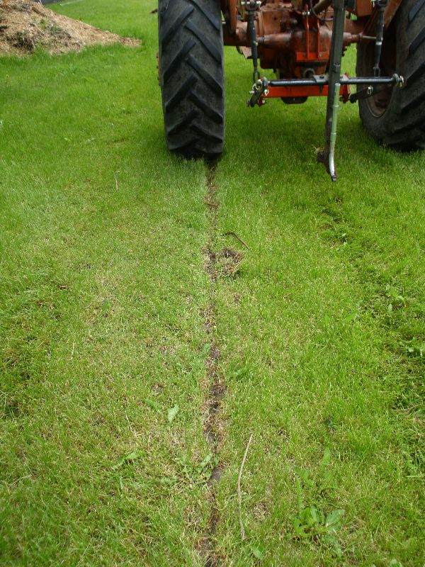

And the test results...
First pass, coming back over it, and the front tri-rib is perfect for re-seating the soil...

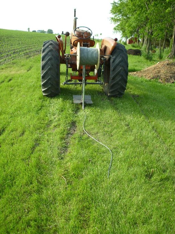

Looks really good... now to test the spool dispenser...
And...
And it puts in this wire REALLY WELL!

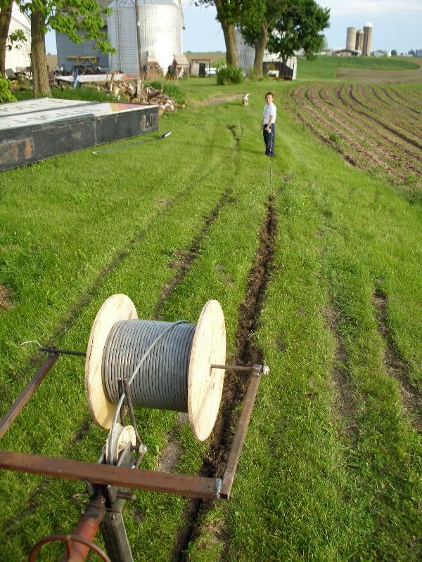

Now, just so it's clear... I built this thing to run in DOG FENCE... can't run it in more than a few inches, or it won't work well.  I didn't intend to go in 10-16" or so, but I'm betting that if I put that serious of a knife on it, the D17 WOULD dig it through without any trouble, especially if I had some more ballast.
Next... that's a HUGE piece of wire... it's 3-twisted-pair audio communications wire that I happened to have a half-spool of.  I wouldn't normally plow this stuff into the ground- it's not direct-bury rated, but it IS the biggest SIZE I'd ever try to push in the ground (both reel, and wire size).  I know that if it'll put this stuff in, it'll put in tiny dog-fence wire just fine.
Tractive effort requirement for this size knife... in the soil I have here today (pretty wet), is next to nothing... the D17 pulls it like it's not even there.  In the fall, it won't be so easy on the knife, but I don't think the 17 will have any problems making the cut.  I'm thinkin' that I could put this knife on my Cub Cadet 109 and plow in dog fence easily... but if I were to ever go to a deep knife (like... 18")... it'd certainly be best suited to the 17 or larger tractor.

Just plowed in 1800' of wire, took me 40 minutes... 45 feet per minute... or one foot every 1.3 seconds.  Actually moving a little faster (1st high, just a little above idle), but we did stop a few times, back up, and re-point it to make tighter corners.  Worked great.  Only had one spot where I had to have John (assisting buddy) stand on the drawbar to help push it back down... we had to re-point for a tight corner, and there was some compacted gravel in the soil, so he 'helped' it get down, but once down, it went fine.
Amidst the pull, we found one tree root that DID cause the 17 to slip a right wheel and tear up the lawn a little... and in another area, we found a 10' piece of old rusty dog-chain.  Didn't find a dog attached to it, but I wouldn't be surprised if there was one down there somewhere... it IS a farm, after all...
