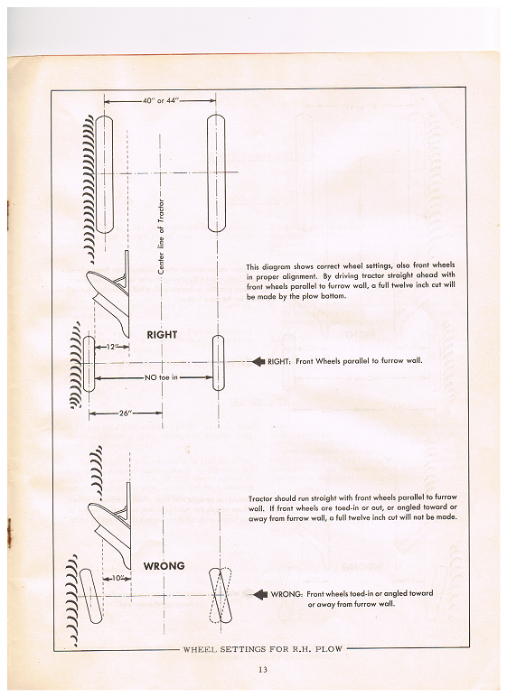

what are the wheel spacing on g allis for (front mounted plow) front and rear. show diagram if possible.   thanks

Does that help or do you need it for double plows?

Post Options Post Options   Thanks (0) Thanks(0)   Quote old diesel Quote  Post ReplyReply Direct Link To This Post Posted: 05 Jan 2017 at 7:44am
thanks for print, just what I needed. jcc
