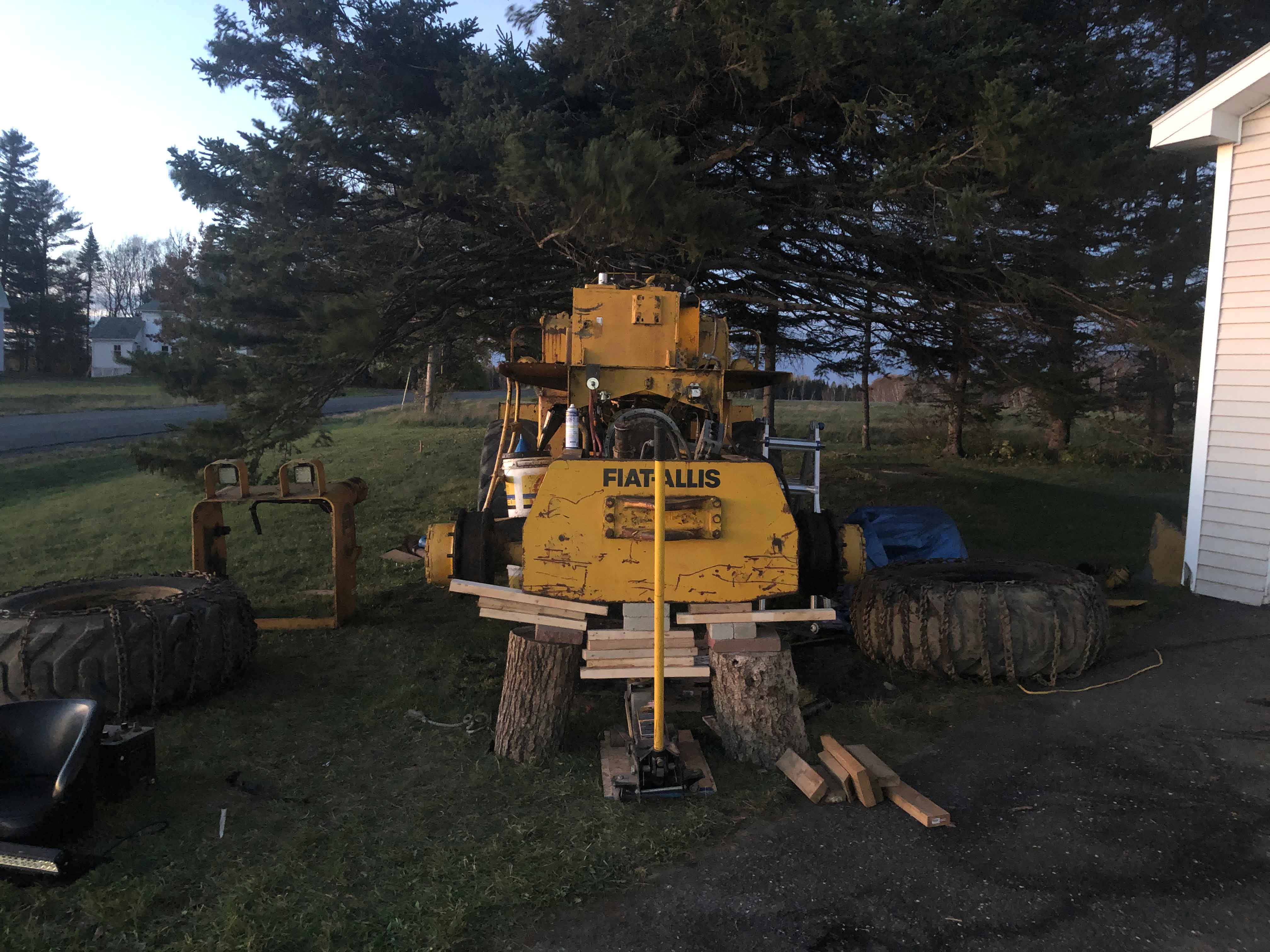

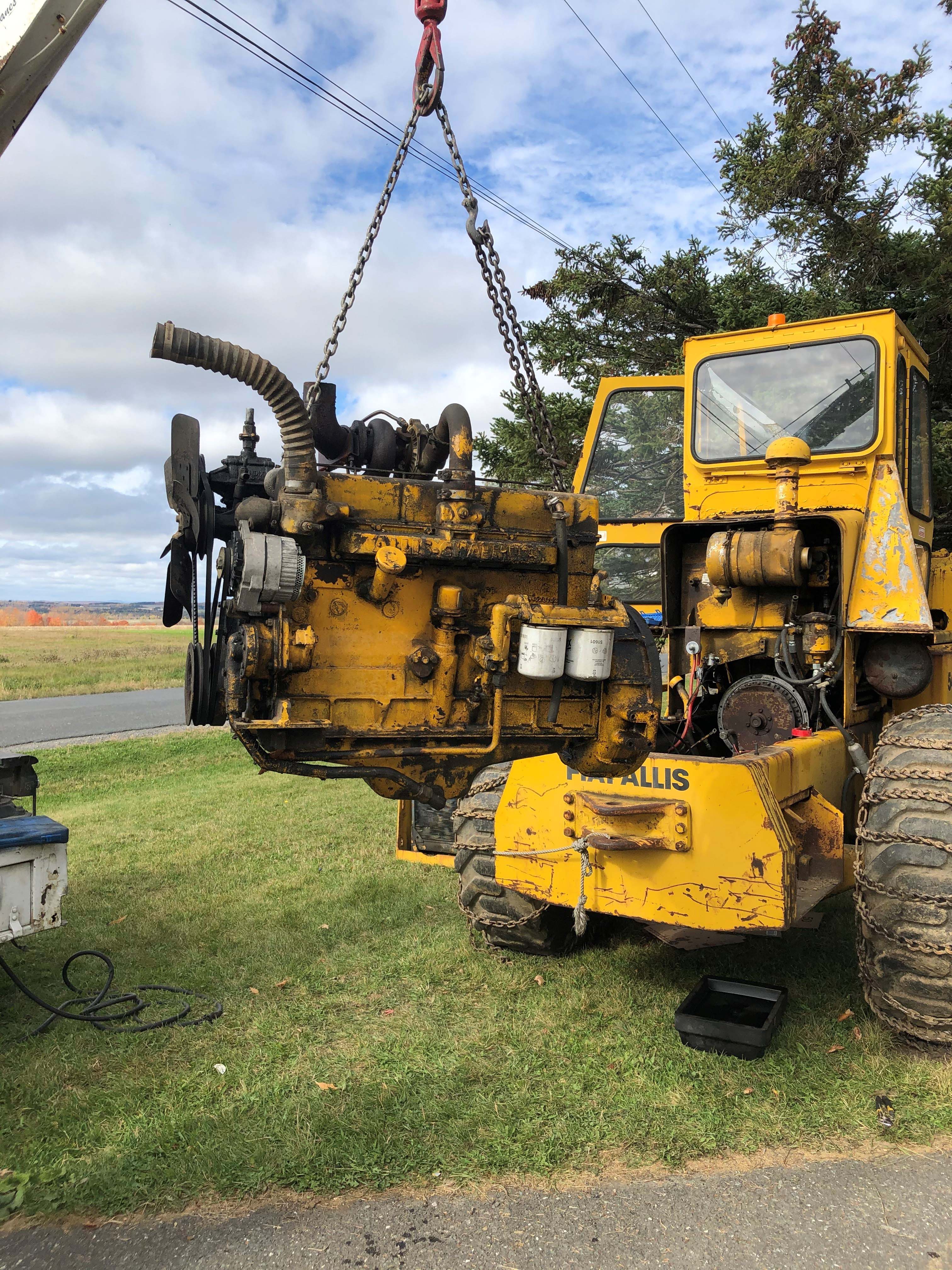

Hello All- wanted to ask the group for some advice with a 1965 Fiat/Allis 545 rebuild. Hour meter doesnt work, but im guessing it has plus 5K hours on it, with at least one rebuild done at an unknown time in its life... Pulled the engine last week, going to start tearing that down, and removed the main valve body which was the source of a lot of grief with the controls/leaks/etc.  Was going to pull the transmission too, but ended up leaving it in.
The lower front pinion seal is leaking, so i am going to drop both lower shafts and replace those seals since there is some more room right now. The input shaft does have a little play in it, not a lot, but there is some present. However the bell housing is dry, so i would assume its not in too rough of shape behind the TC.Big smile It shifts as it should prior to pulling, my only complaint would be it seemed to me like it wasn't as strong as it should be? But, as i hear it, some folks say the old stuff had to be screaming to get pressures up enough to make stuff move as it should. (That would definitely be this machine!) The only ugly issue it has (if you call an issue at this point) it must have had a starter failure at some point in its life, the starter i pulled off it, which worked as it should, was fine, but there were teeth in front and behind the flywheel/converter. These bumbling around in there all but rounded the flex disc bolts right off. Had a bit of trouble getting some out where they didnt have any heads left in hex form. Was able to fish the remaining teeth pieces out though. After explaining these conditions of the tranny, would anyone else feel comfortable leaving it in it too? I hate to waste the opportunity now, where its mostly apart, but at the same time this work is happening outside and i live in northern Maine- so time isnt on my side to button this up is all. Thanks for any advice/tips.

Thanks for the pictures! You're definitely the right guy for this kind of project, also with good help and support from that local service truck. Doing the engine will be nice to have under your belt and shouldn't be too expensive. Hopefully you will have it back together and working good ahead of those eastern seaboard snow storms. We'll look forward to your progress report. These machines are excellent for snow removal. The FR12 I had is identical to the 545.

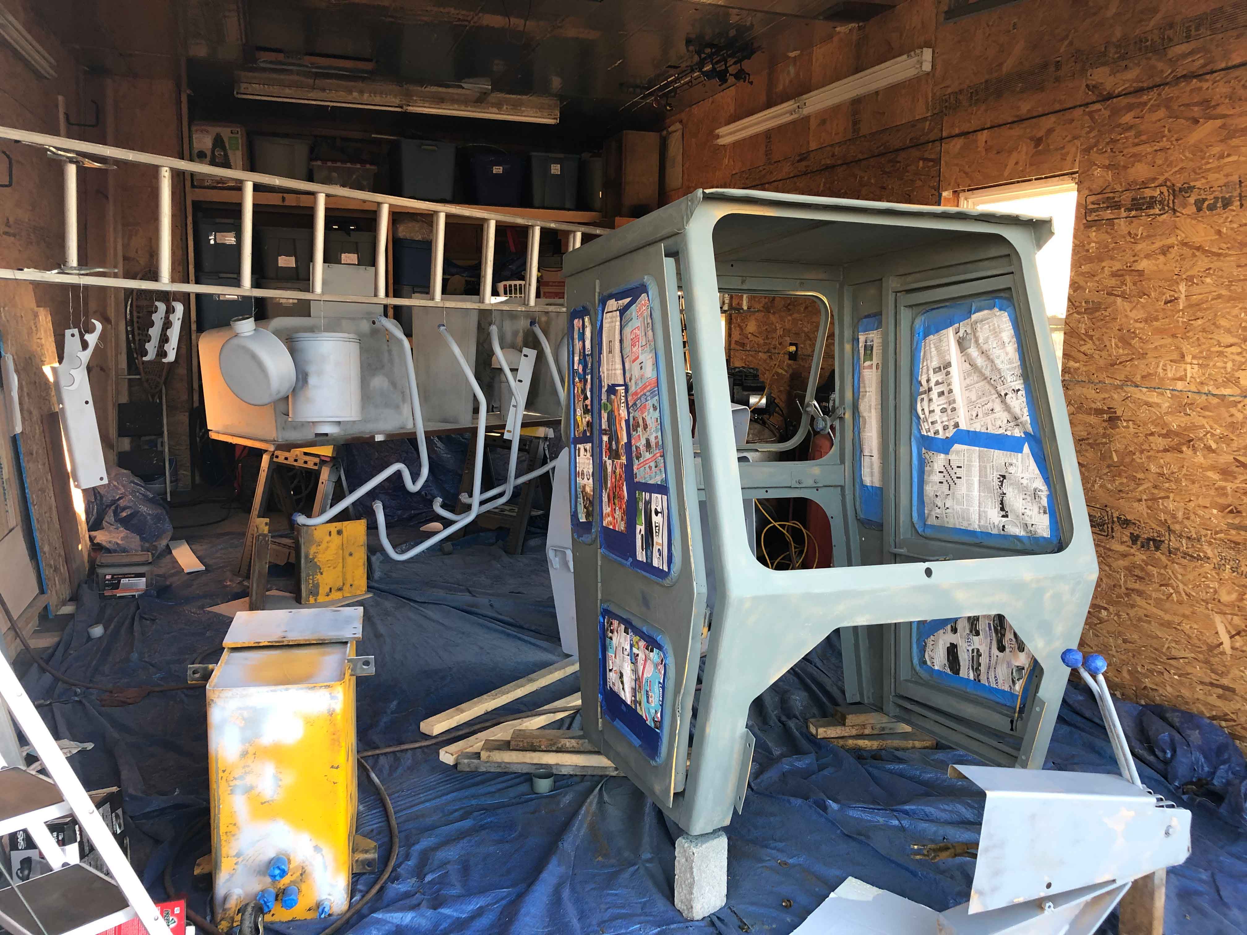

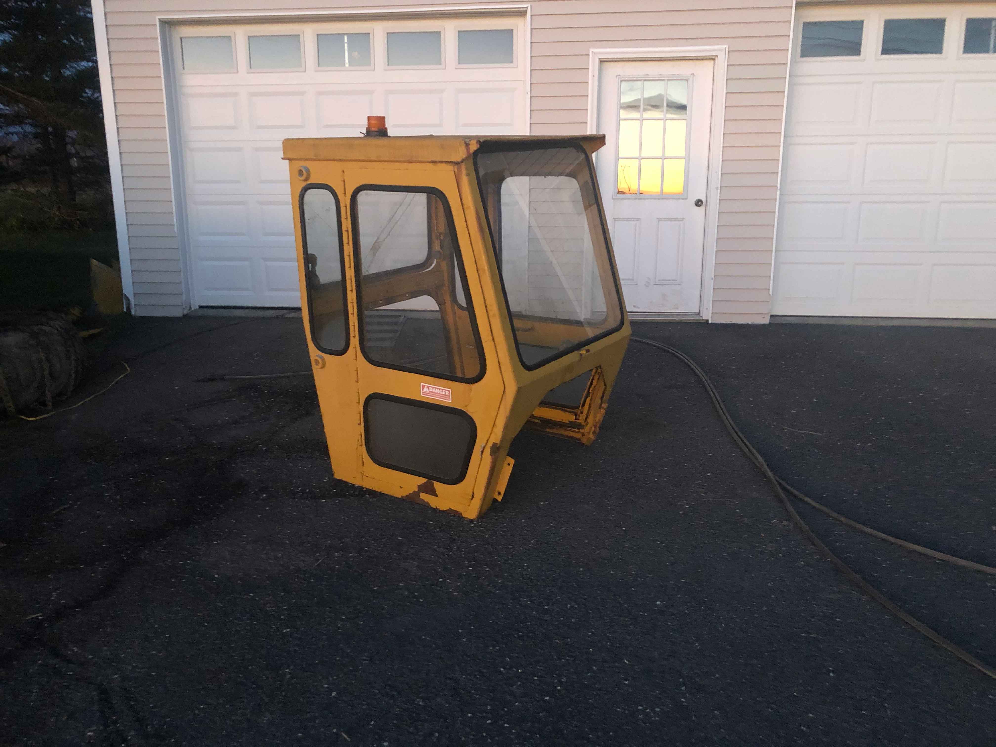

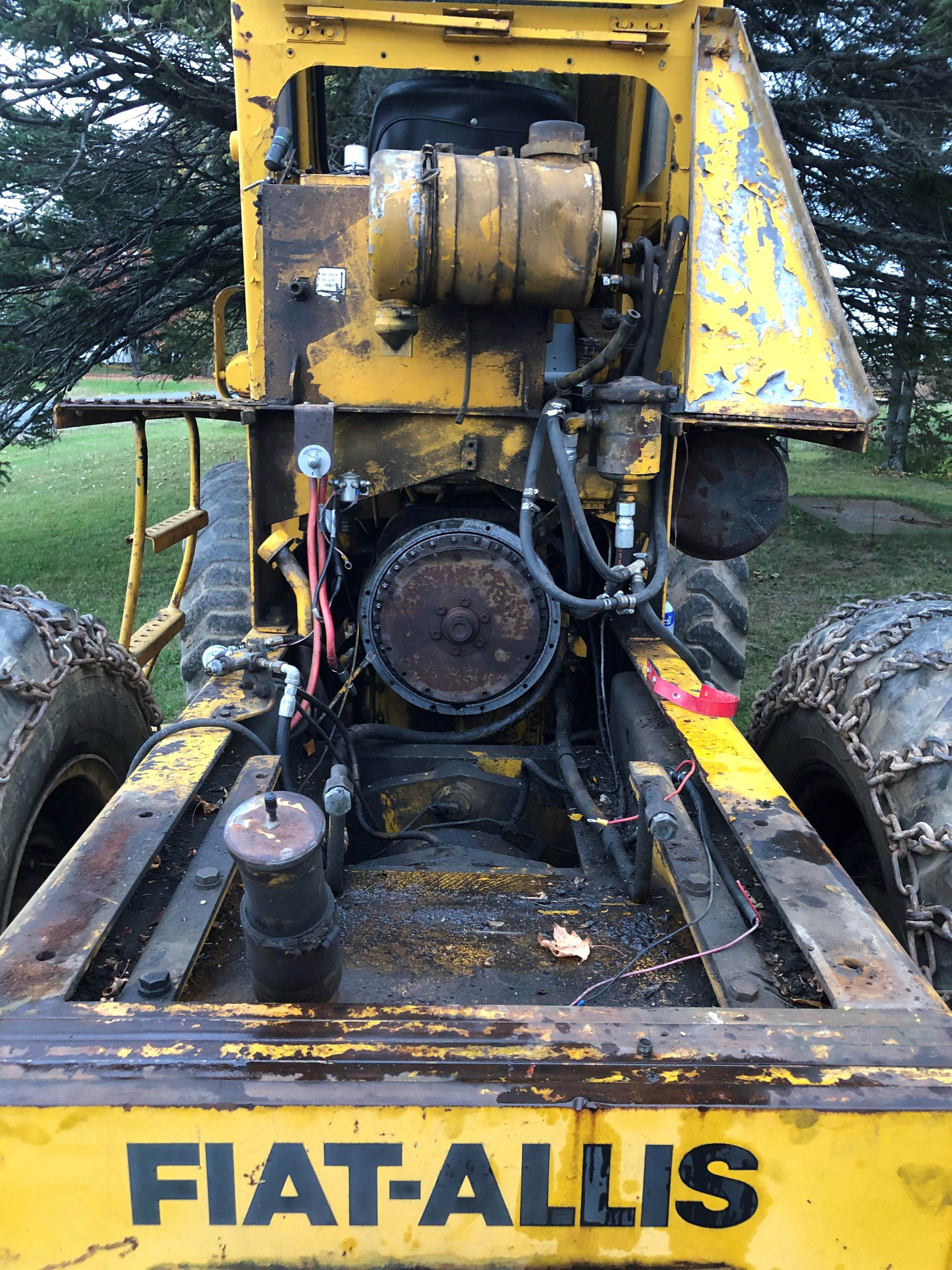

Removed cab, hydro tank, and second hot pressure wash after scrapping and hand cleaning what I could

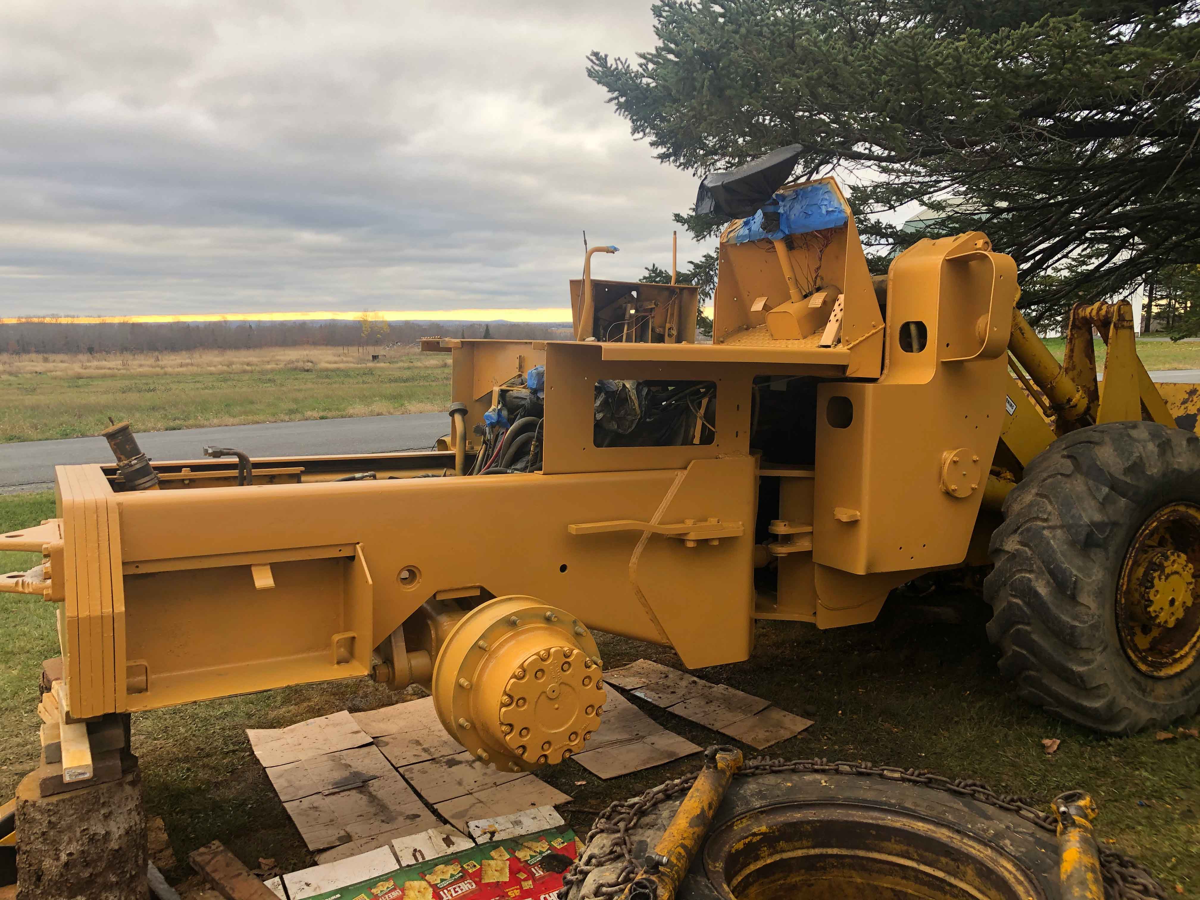

Would you believe I was able to get this off by hand?!? Just enough room to roll back onto the frame and then down to the ground.

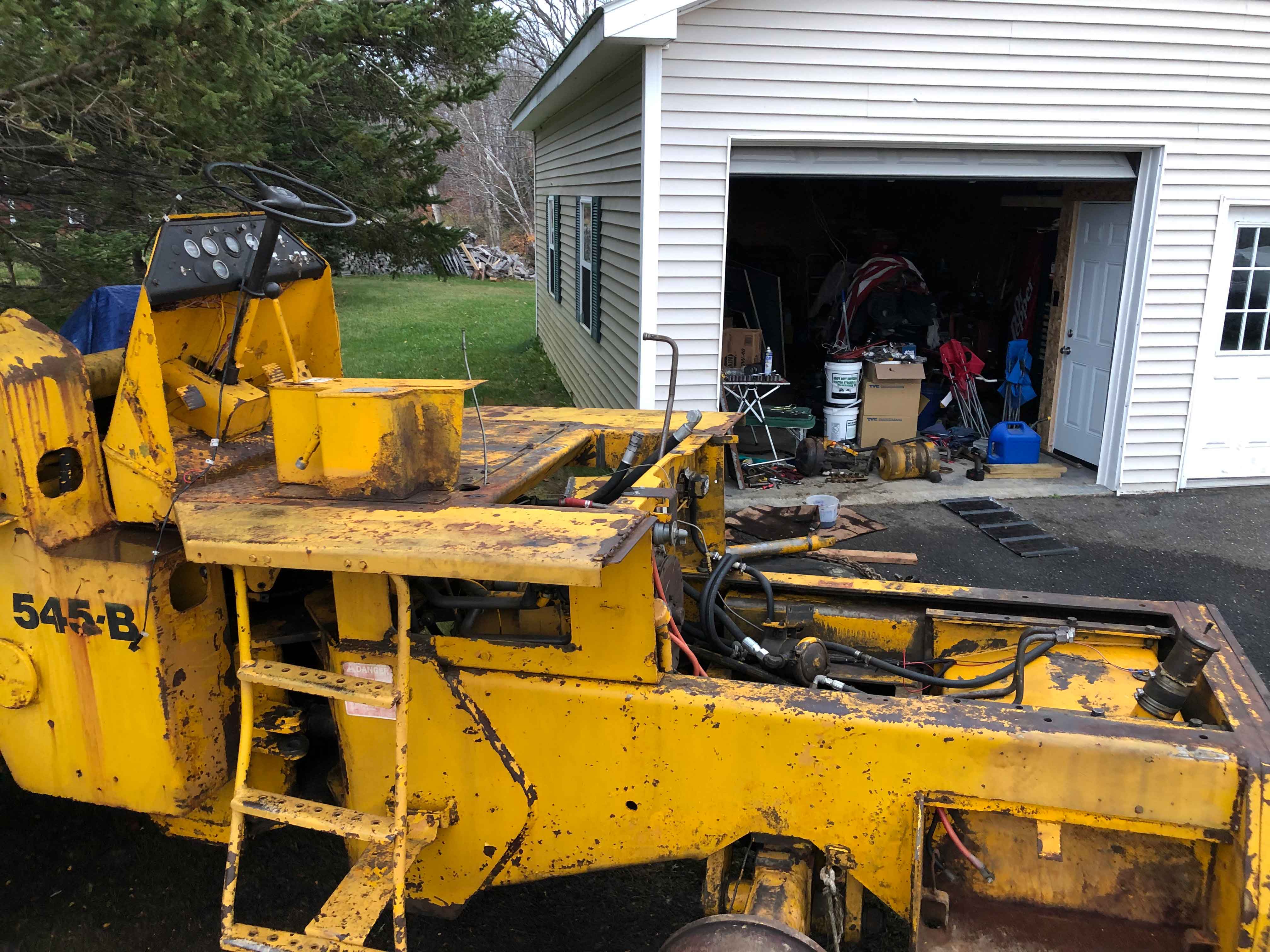

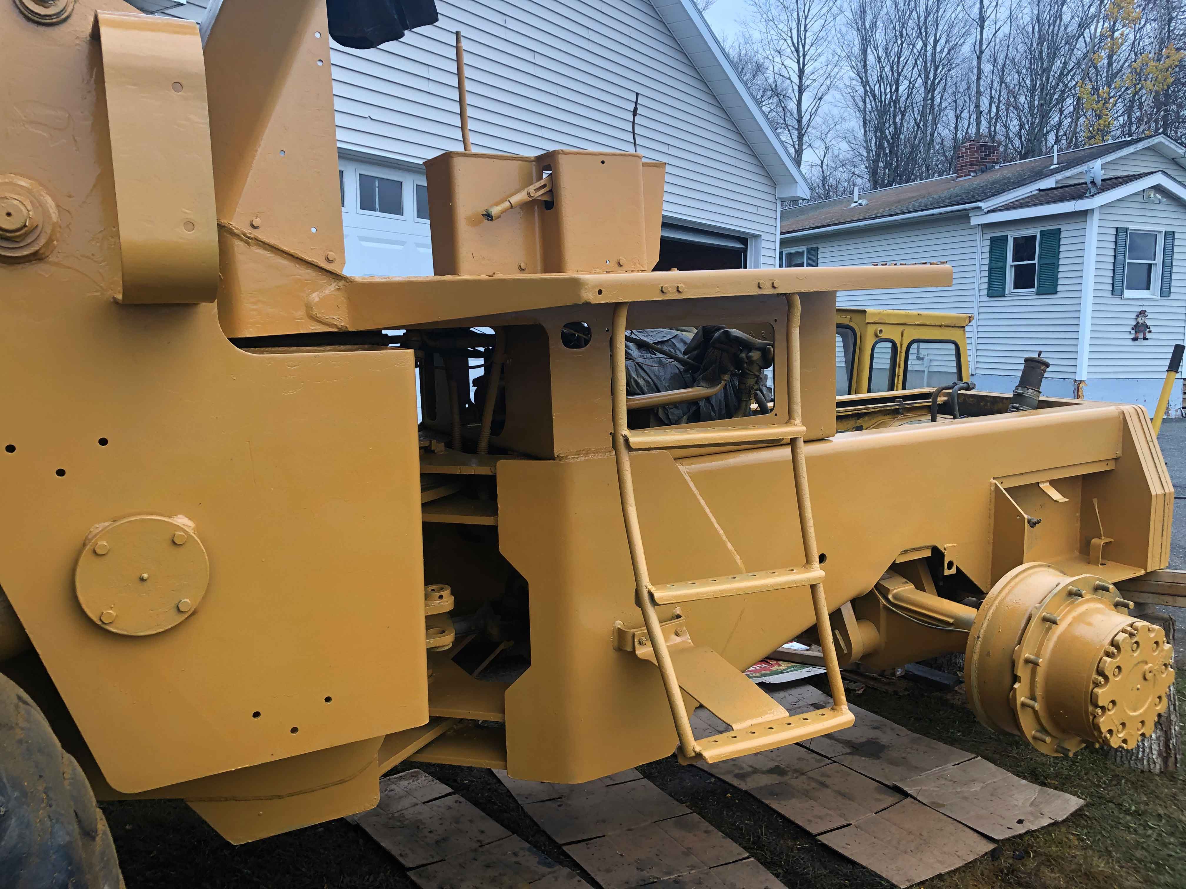

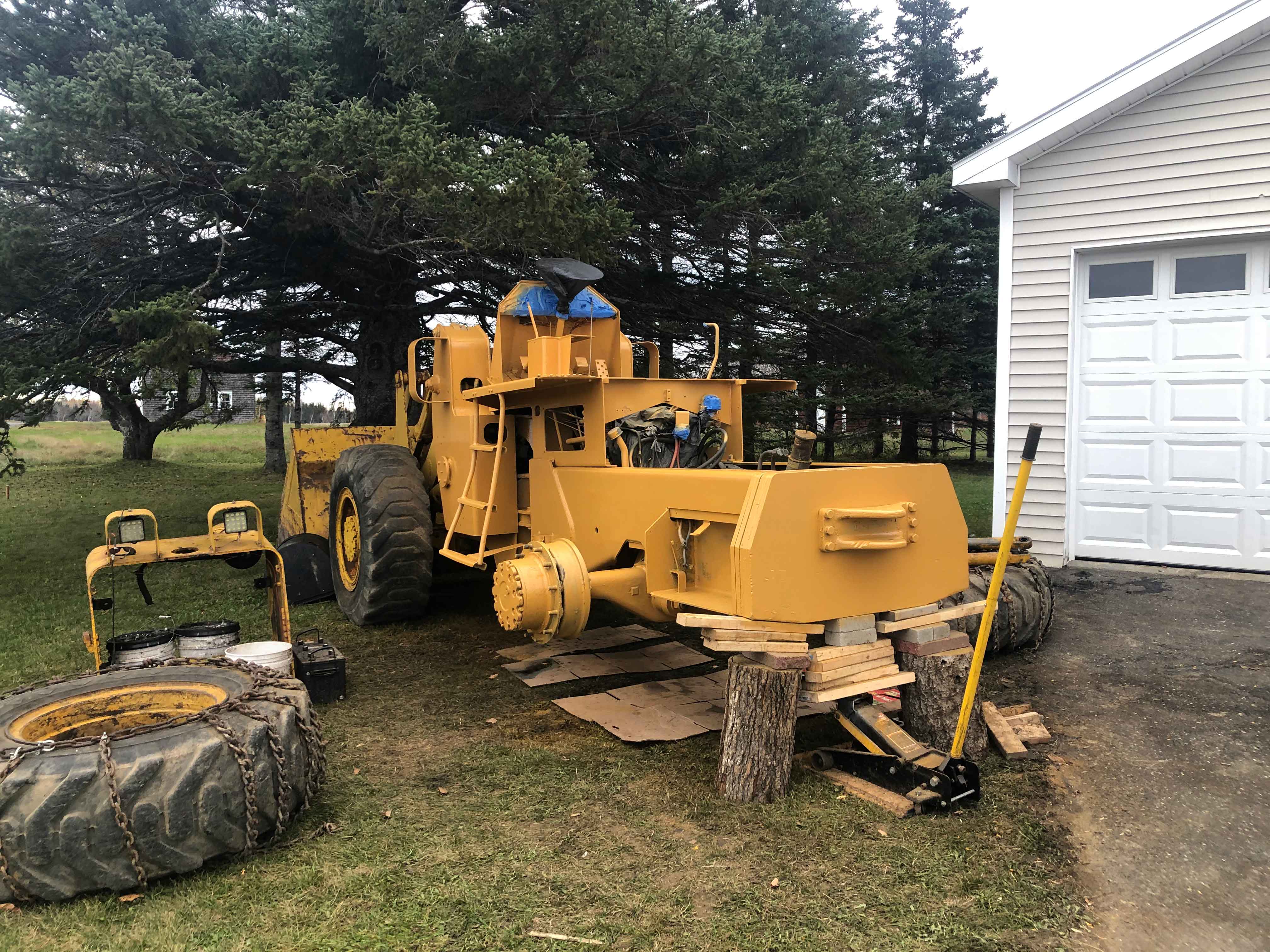

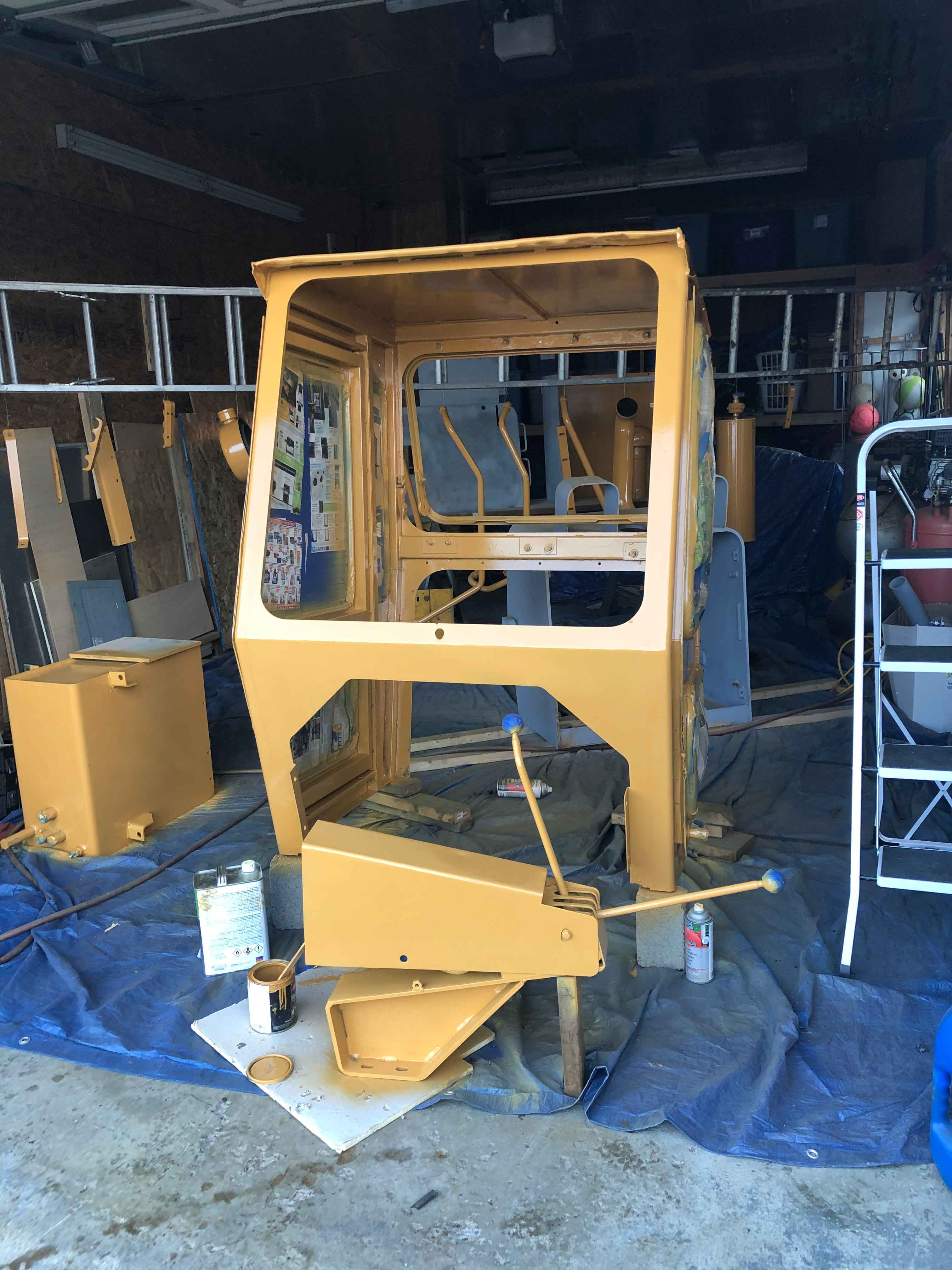

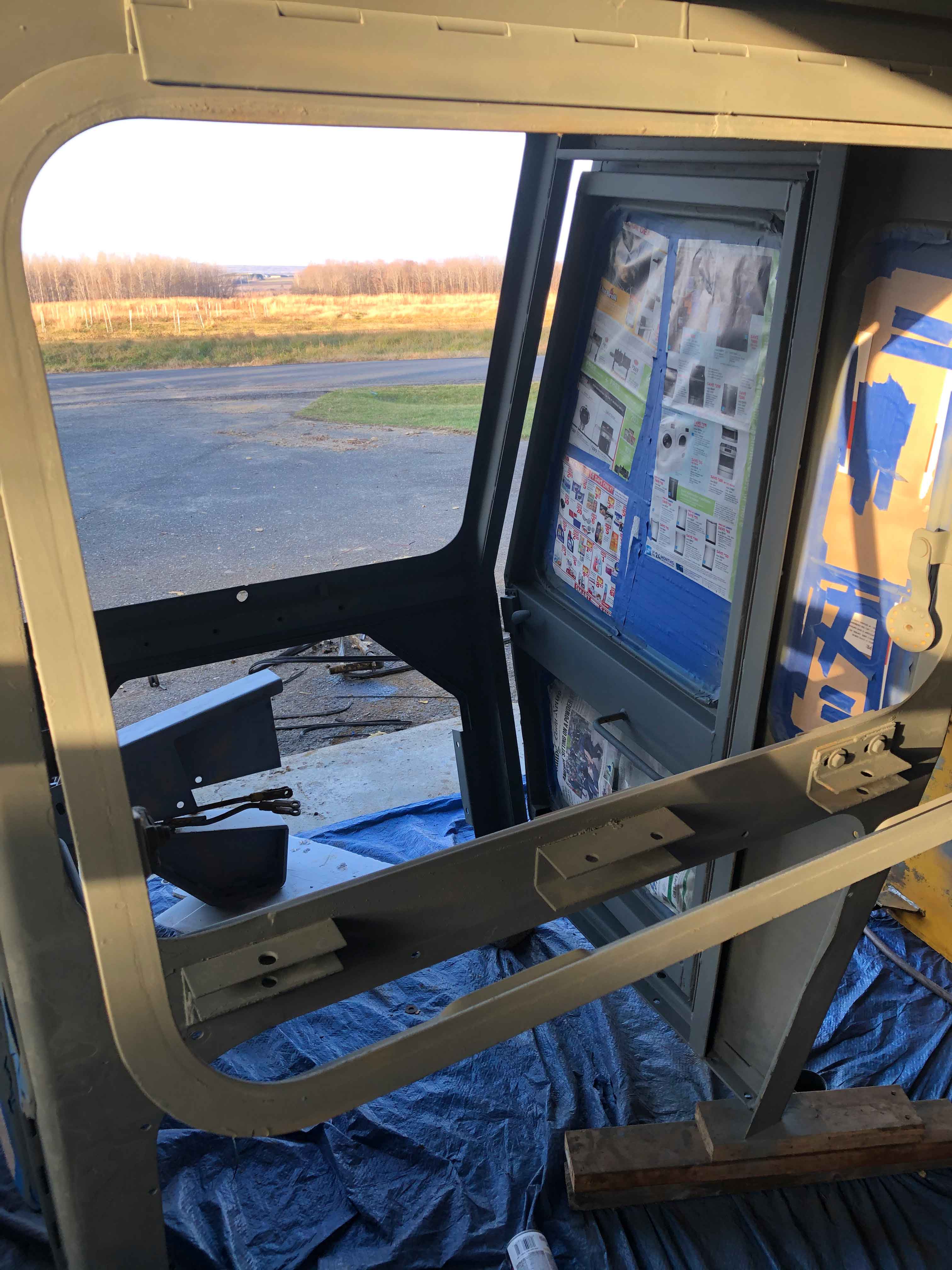

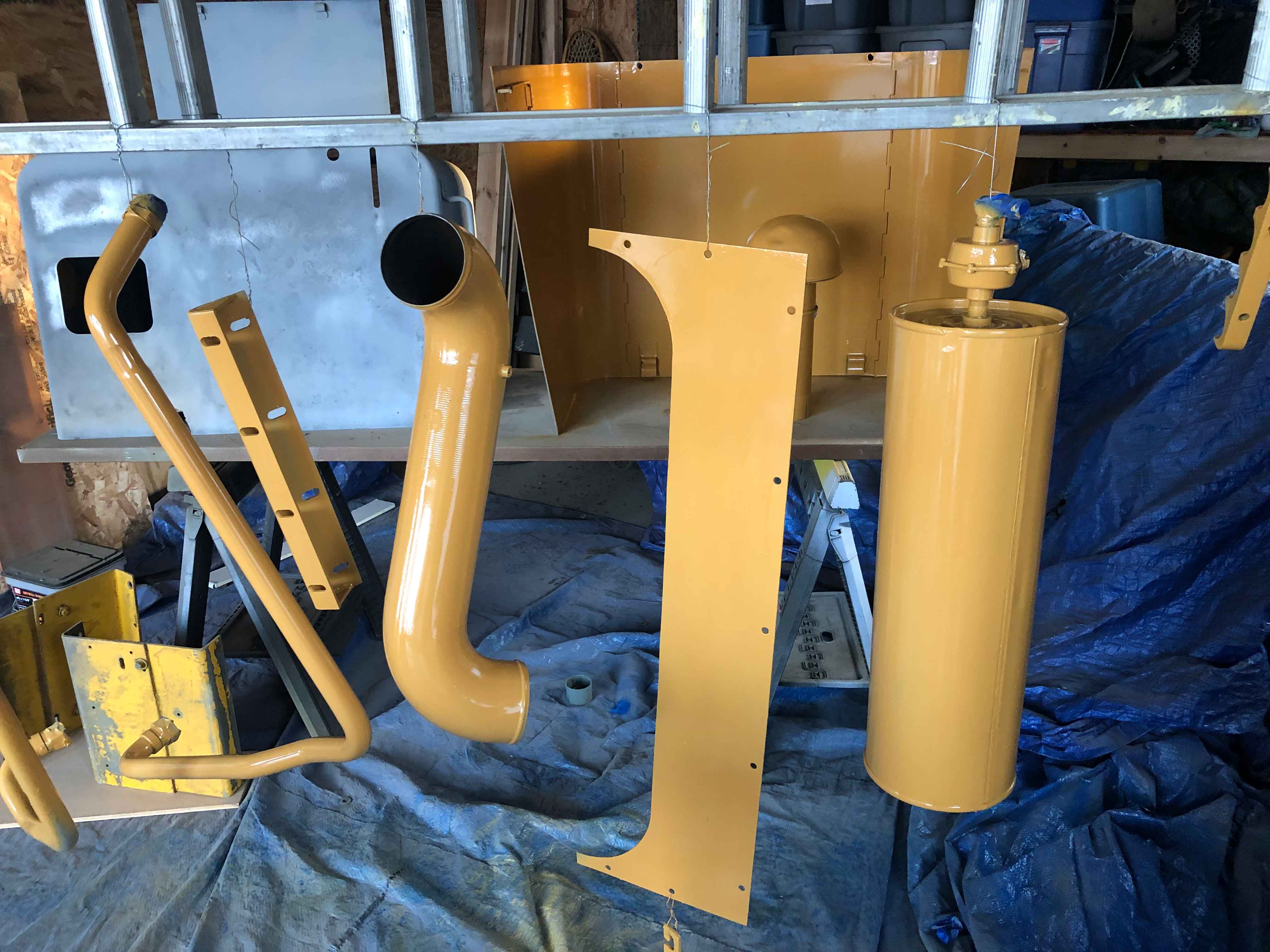

Before Paint
After Paint

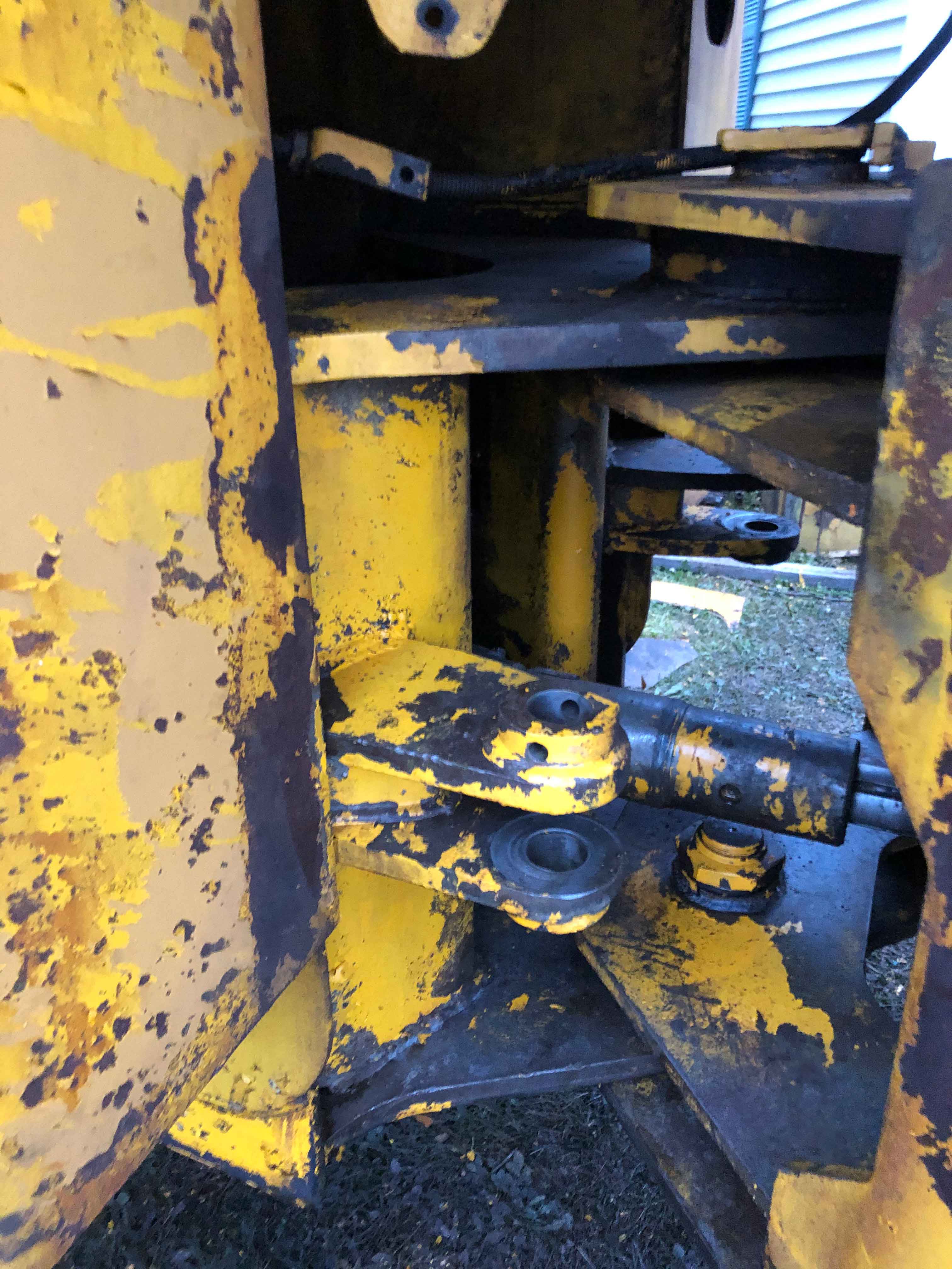

Going to need to do new seals on the axles, after cleaning (and painting) gear oil started seeping out from between the hub/brake drums- im sure the front is not too far from the same condition

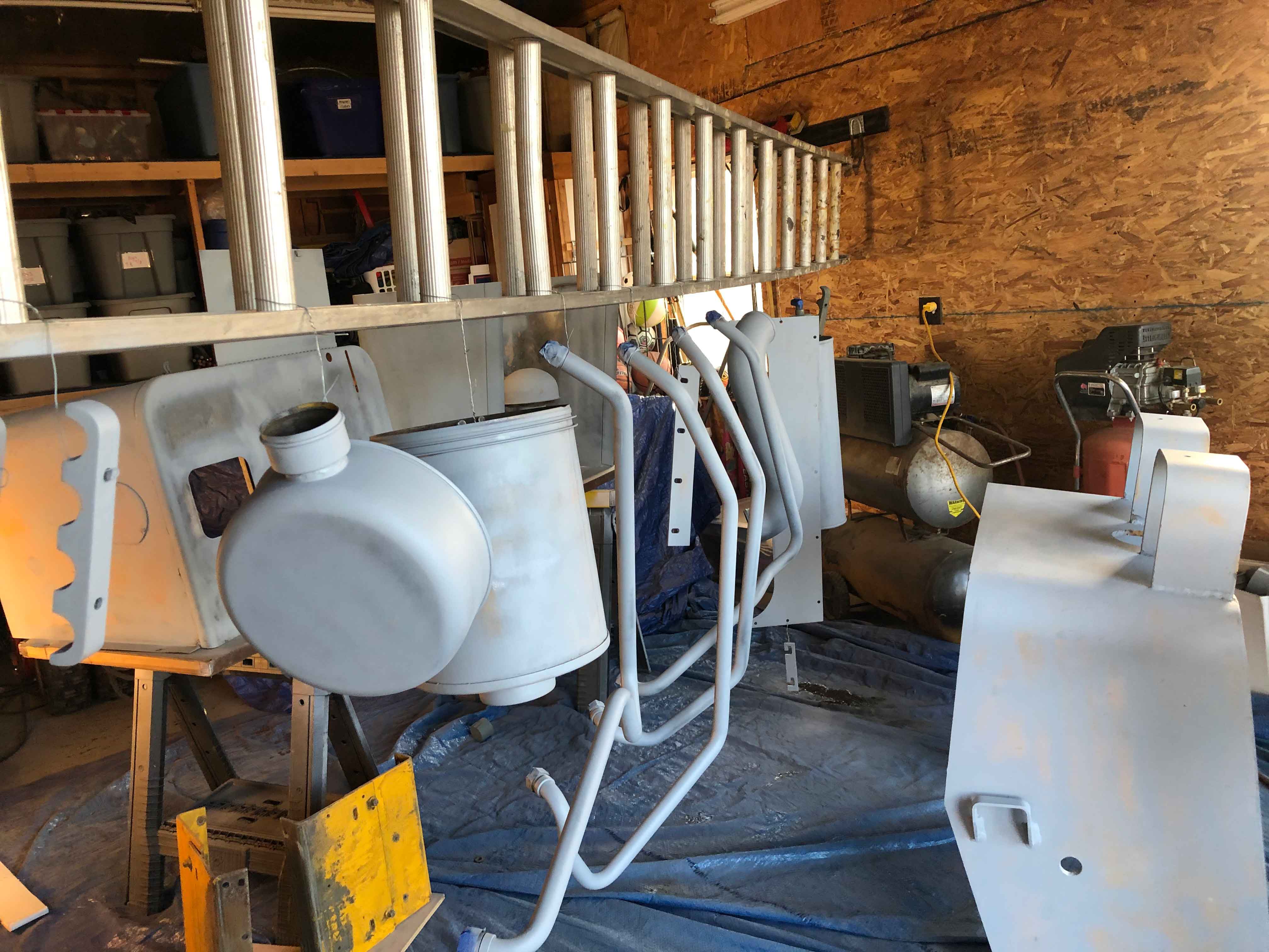

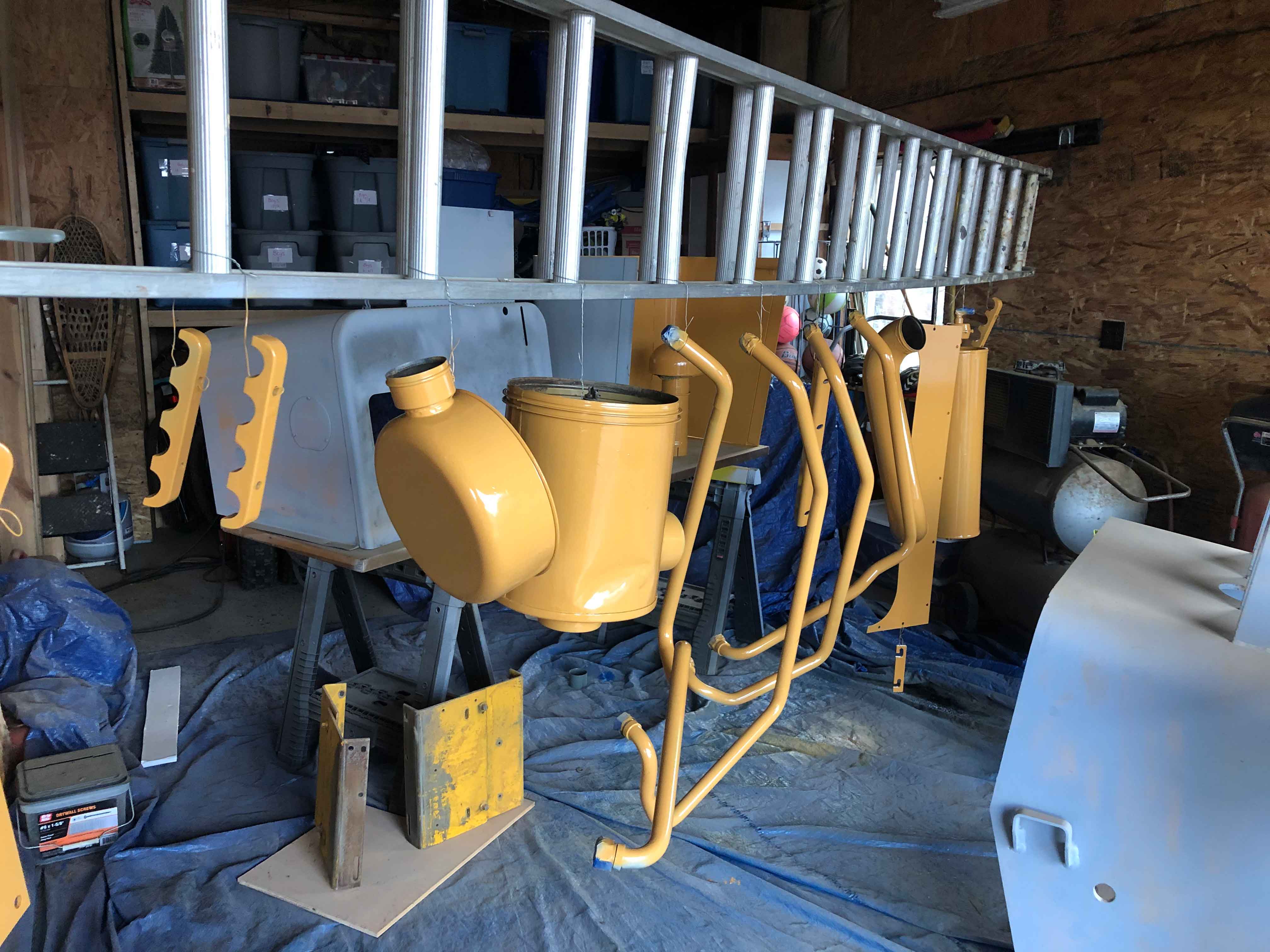

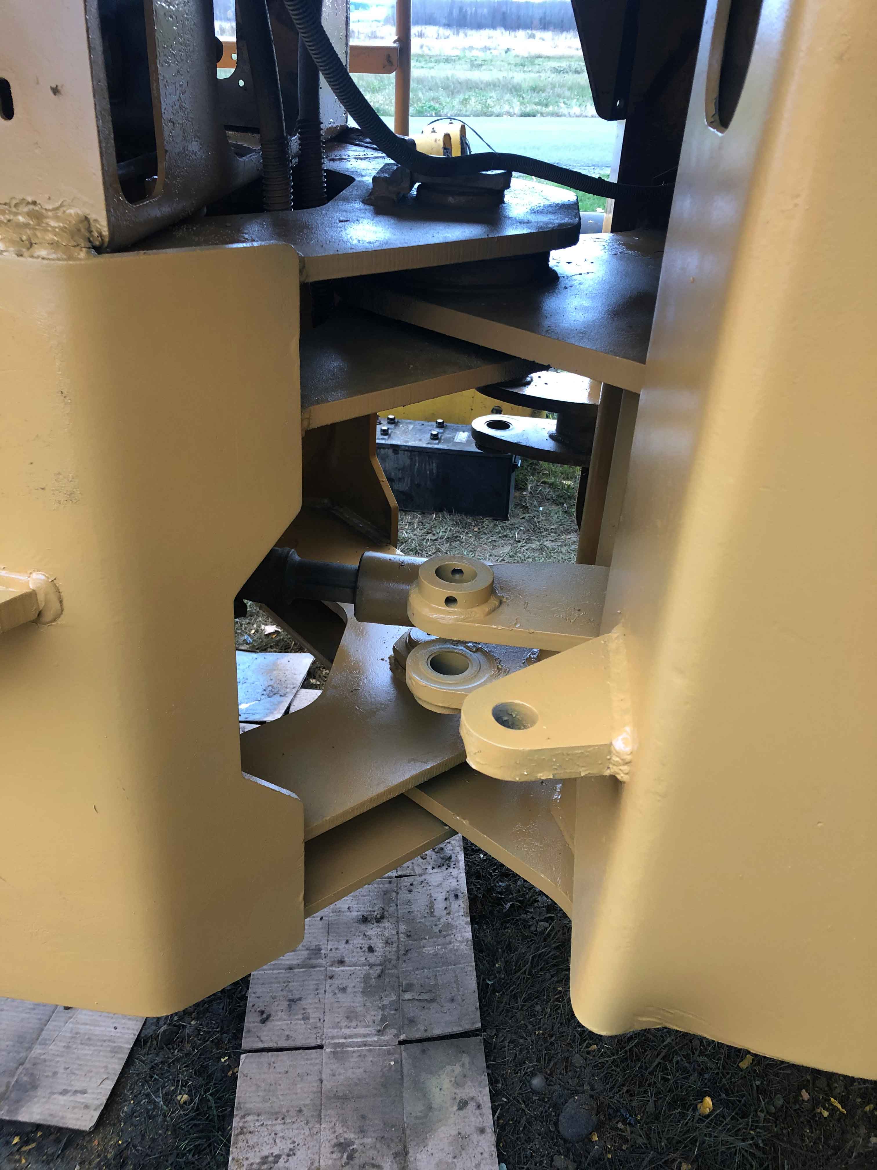

Remaining parts (most of them that is) sanded/primed/prep

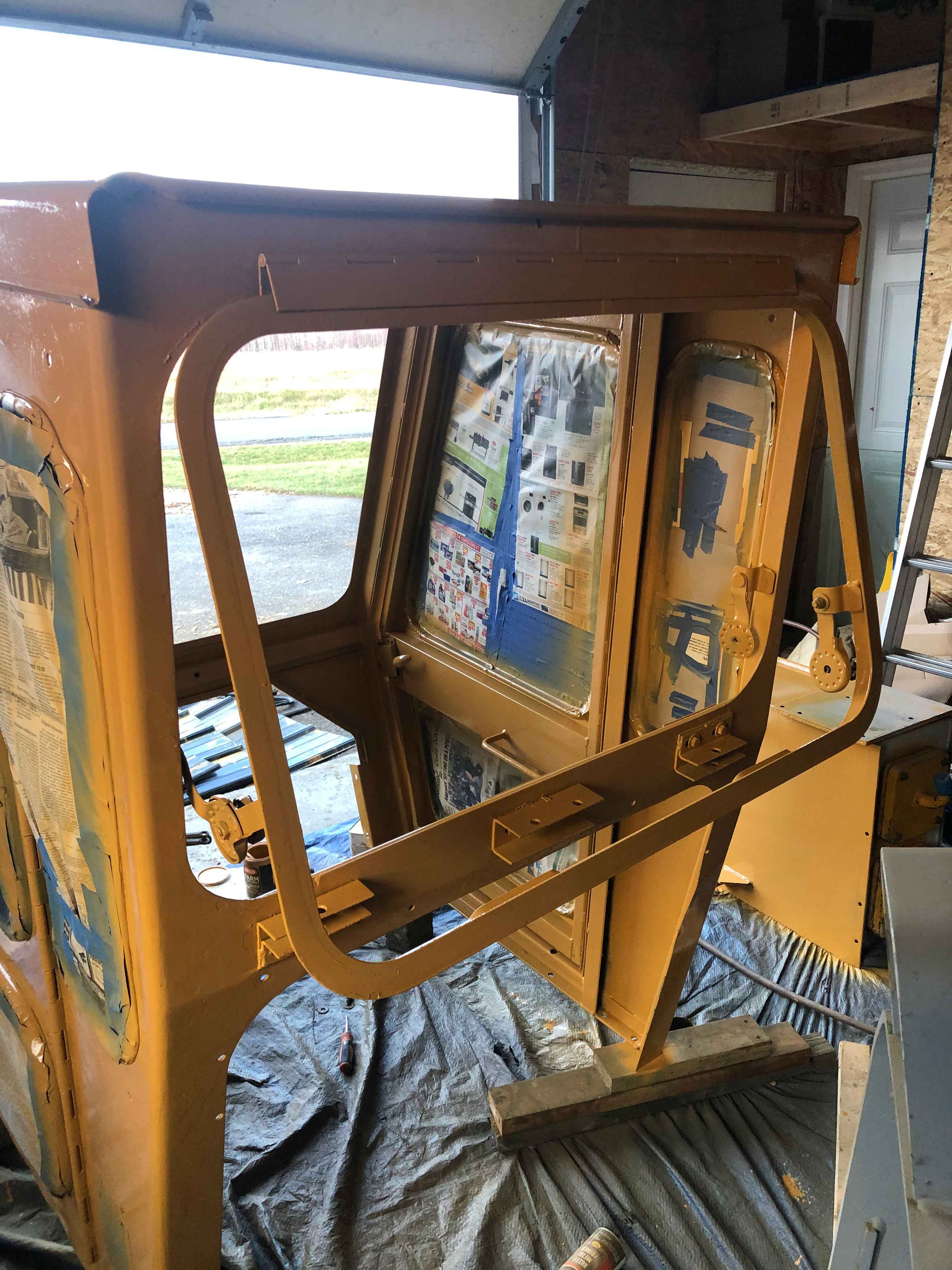

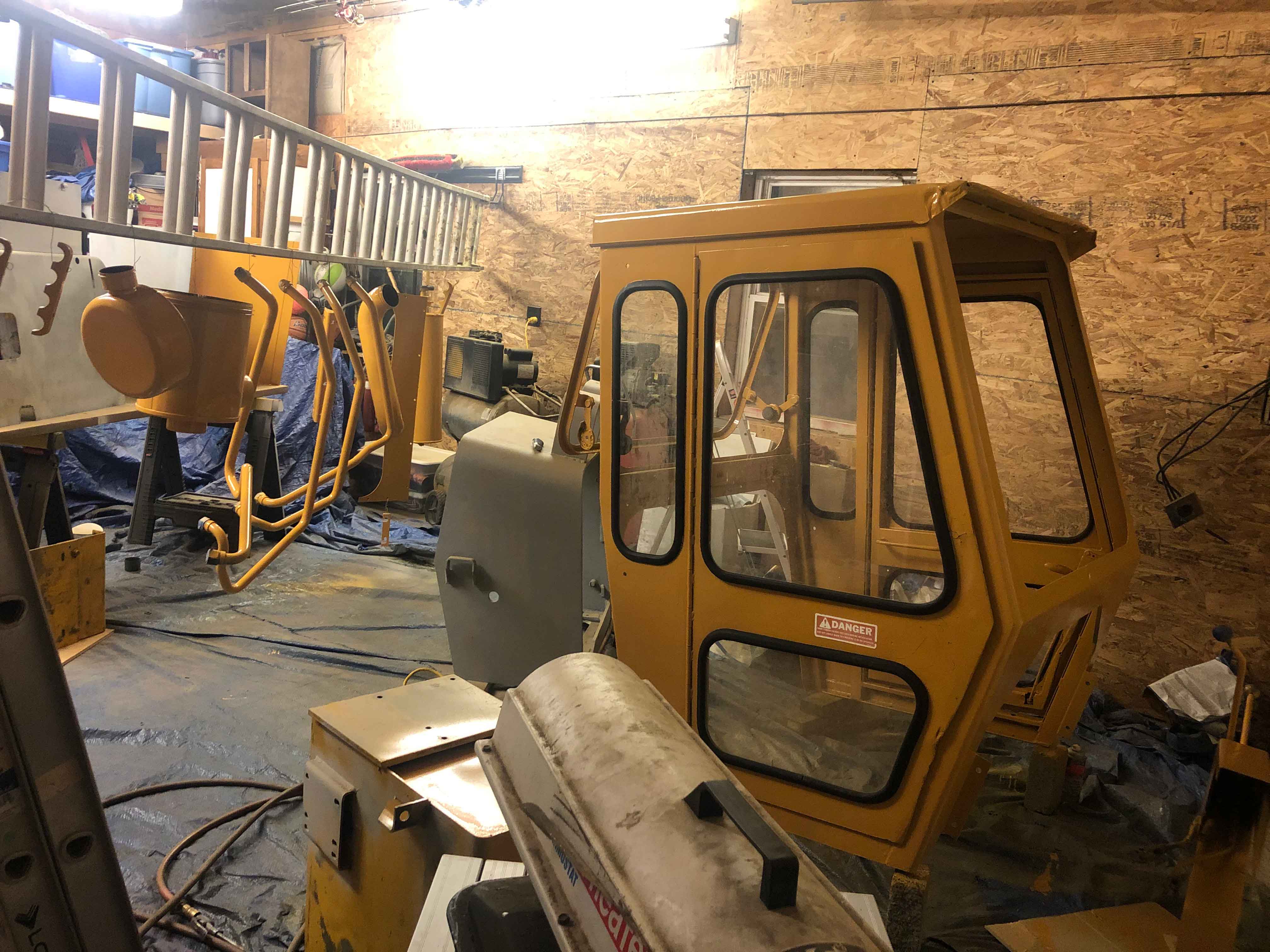

A little heat blast to finish the cure process- (its getting cold here)
Cab will get trailered up this week and brought to the glass shop for new glass and seals on the front and rear windows.

As for everything else:
Rad should be done this week, tested good, but needs a thorough cleaning.
Steering cylinders should be done next week and hydro hoses coming in next week-fingers crossed
Motor, is at the machine shop today- one bad cylinder and another quite tired to say the least- will have pics soon for that.

Thats a big job for a small shop Ken... Your doing a great job !!  Like the NEW FA color !

Wow!! You're being thorough, good job! Thanks for the interesting progress report with pictures!

I like the "aluminum hanger" you used to hang parts for painting... Kind of looks like a ladder i once owned ! Wink Wink

Yes- the color was supposed to be a bit more on the yellow side- I used krylon New Equipment Yellow. although it does match the label color band on the can, it usually has a more bright yellow to it. Not John Deere yellow bright, but more like road paint yellow. This stuff unfortunately came out a bit more towards the beige/tan side of it. Closer to a CAT yellow. I wonder if it was old stock, it was very separated in the cans. I mixed all three very well and still couldnt get them too look closer to what i remember the collor being. Part of the reason i even decided to use the Krylon (not really a brand i typically care for...) They had this color available in gallon cans and spray cans. I thought i could spray it on and later down the road if it got scuffed or scratched i could use the spray cans for touch up and not have to worry about matching. Well, the spray cans are much more yellow than the cans... so that theory is out!
And yes- that is a ladder! haha- crime of opportunity, I have strung up a cable in the past but with the weight of some of the parts i figured it would have been hard to keep it from sagging to the floor. Saw the ladder on the wall and thought- that would work!

I like the darker "CAT YELLOW"... I worked in the Construction end of Allis and we started painting the big dozers and loaders that color in the late 1980s...  FD series dozers and FR series loaders.... I bought a couple gallons of it when i repainted our CASE 530 backhoe.. NICE COLOR !

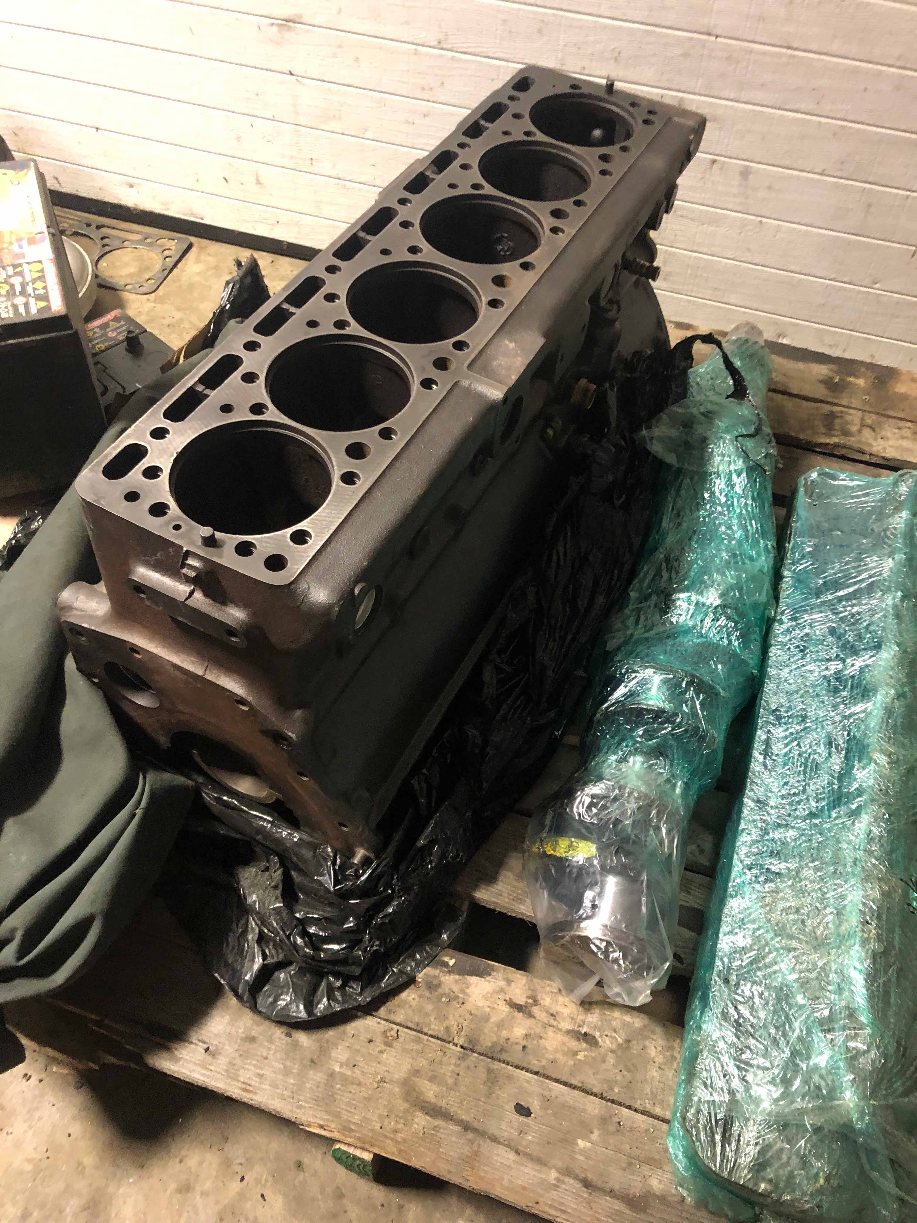

Finally back on the forum here with a quick update/question.  Its been a little while since I last posted, left off with pulling the motor out of the 545 and working on the many fun surprises that came with it! (But not to worry, nothing to bad that a little money won't fix!)
Block has been machined, crank has been done, and head work is complete. Getting a new cam and liners and pistons, (1 new rod as well.) It sure is a tough old motor because any of that newer stuff would have given up the ghost a little quicker i think with all of its aliments...  I found one rod to be miss-match between rod and cap, which did a number on the rod itself (and the crank) and their is a taper bearing set behind the smaller timing gear that in my case, had seized and somehow did not spoil the bore it is in on the block.  Still have to completely rebuild the vacuum pump, but since i havent done the wheel seals and wheel cylinders yet, that's not neccassarily a big issue. (hasn't had brakes in many years anyways)

Post Options Post Options   Thanks (0) Thanks(0)   Quote NorthState Machine Quote  Post ReplyReply Direct Link To This Post Posted: 06 Jun 2022 at 11:03am
Here's the only image i got during the machining process Confused
