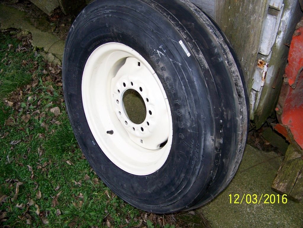

I have a nice set of 7.5L 15 tri ribs on 6 bolt rims I want to put on the front of my wide front 45. Need a set of hubs that will work.

They are 15" tires. I bought the rims from a coworker pretty reasonable, believe they came off a 4020. I painted them white because they may wind up on the 185 but would rather put them on the 45 if I can find the right hubs and put new 11L15s on the 185.
