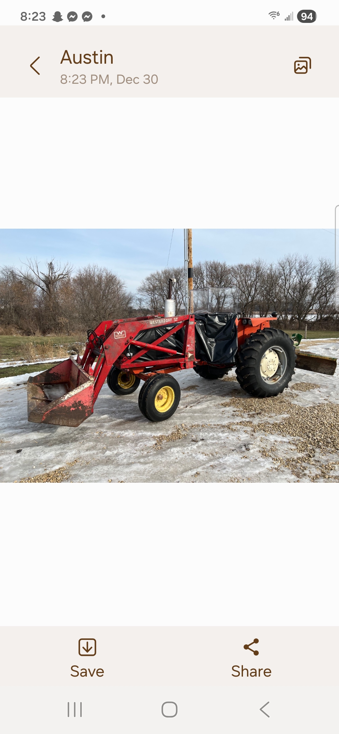

uploads/25332/TractorLoader-WestendorfWL42.jpgHere's the seller's photos from the kit which I ended up buying. It was immediately mounted on the tractor, so I can't provide any other pictures of just the mount brackets.

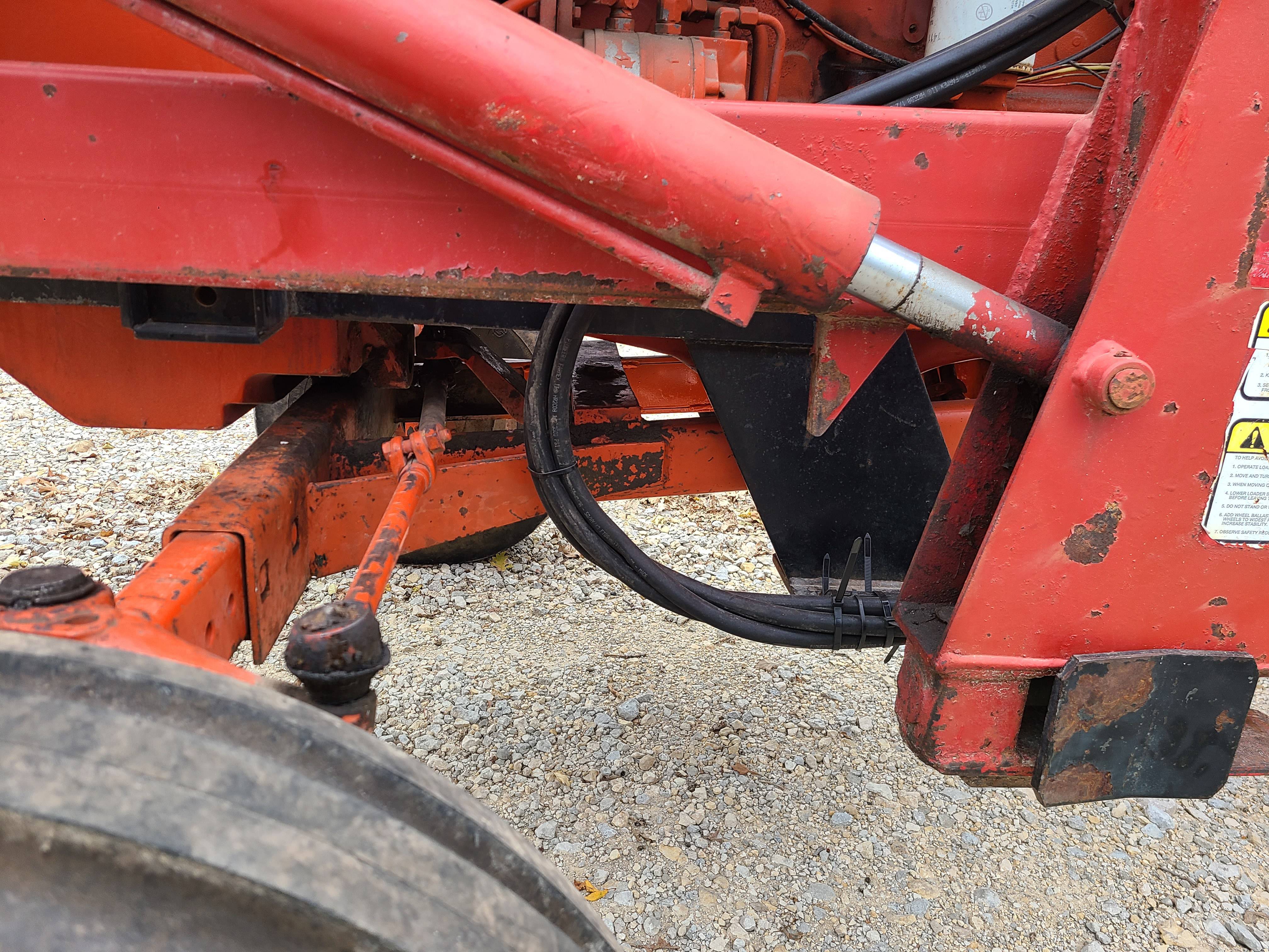

Don't suppose you could get me two dimensions? Then I should be able to fabricoble a plate and use the brackets I have. The vertical from top of bracket to where the square cross bar mounts, and the full from to back of the plate.
Also, what's the square block do on the sides?

I think the square block is just a spacer to keep the mount from sliding left to right. I attached the best photo I could find. The bolt holes which are visible are not used.
I suppose another possibility is some other kind of Westendorf attachment bolts on here, but I can't think of any example.
