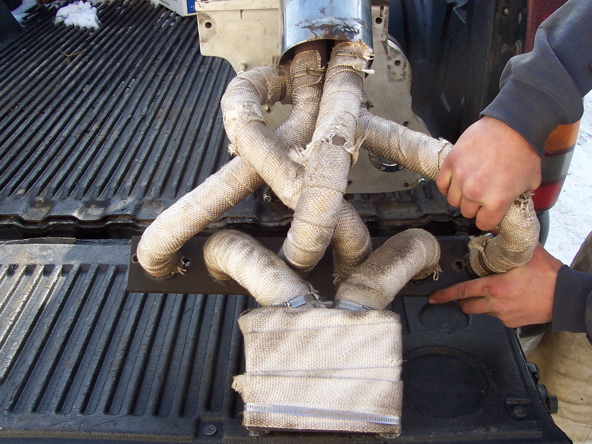

Here's an old picture of my updraft intake.  The tubes stuck into the plenum about 3/4" and were belled pm the end.  If you follow the exhaust tubes in the rotational order they are 1-3-4-2 and were all equill length.  What a @#$!% figuring it out.
I had made the intake plenum fairley large but on a low speed engine I would make it much smaller.  A 1.625" diameter intake tube will be about 1.5" or so ID, this gives an internal cross section area of 1.76" which is about right for the size and velocity you are going to want.  1.5" tubes would give you a 1.5" area, this may even be better for low RPM.  When I do the math on what a 316 cid engine should use for air at 1800 RPM, I think 1.5" tubes will be better, but that's just my idea.  I think either size is fine.
I ran 2" tubes, but I also ran a 2 1/8" bore Zenith carb off a 670 cid Cont. engine with a lot of mods to the carb, and I had 1.8" and 1.9" diameter venturis for it.  I also ran a Stromberg NAR6B carb that used a 2.4" throttle bore.  I had tuned the exhaust for peak torque at 4500 RPM and the engine would usually go in the 5800 range and sometimes over 6000 rpm...I needed around 400-440 cfm I figured to feed the engine, where a 316 cid at 1800 RPM is going to need only 150-170 or so.  I don't figure a very high volumetric efficiency rate on these tractor engines.....You need a carb with a 1.1" venturi (just guessing as a place to start) or so and intake runners with a 1.4"-1.5" inside diameter.

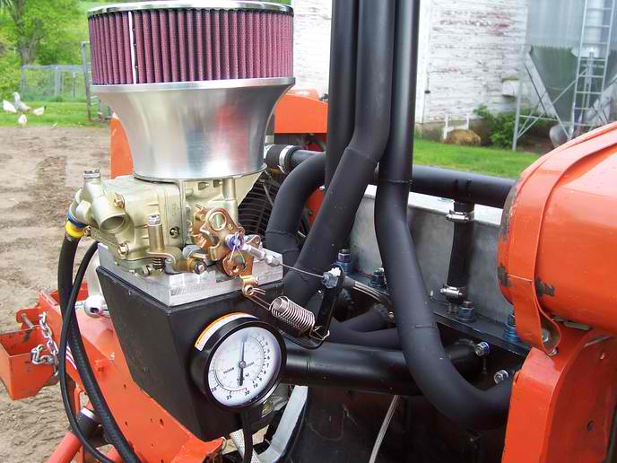

A picture of the downdraft setup,
