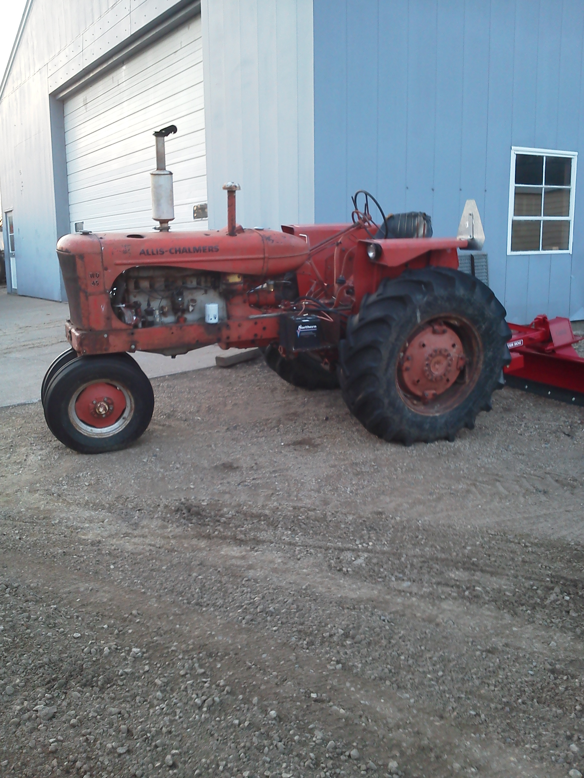

Here is a picture of my 45 diesel that has been converted to gas. Hope you like it !

I have a wd45 with a 6 cylinder Gas 262 out of a A2 combine (Same as d19 gas). The history of it diesel engine blew up in the 70's uncle scraped it put in engine out of a junk A2. Still runs after all these years. Put it on the dyno last year about 65-70 hp.
Here are some Pics of My wd45 6 cylinder Gas and a Pic of my wd45 6 cylinder Diesel
