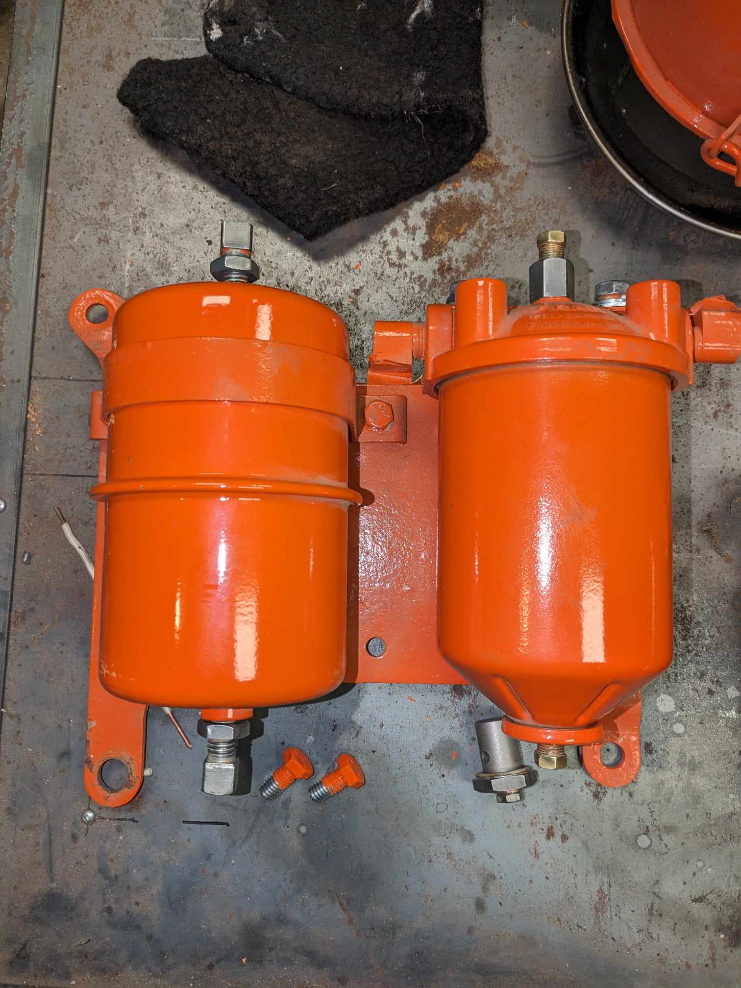

Question about the secondary fuel filter on the left side in this picture.  It appears to be a sealed unit.  Is this correct?  I do not know what its condition is inside.  The ends were closed up to keep debris out when I got the tractor, but I do not know the status.  Not sure I want to use it.
Are these filters still available?  Part number is 74355944
Thanks!

You are correct in that it is sealed unit. They are still available. I bought a new WIX one from my local napa but I don't have the filter number right in front of me. If I can remember I will try and get you the number later today.  Don Jr.

No longer available according to my local AGCO dealer.
Don, if you could give me the WIX number, I would appreciate it.

Baldwin BF7726

Hey Myron, sorry I didn't get it sooner. Suffer from CRS! Lol. I found the filter yesterday finally. I did not get it from NAPA as I thought. I got it from my local AGCO dealer, the heritage line of parts. That number was 90910V and it was a WIX filter in the box. The WIX number is 33191. Hope this helps.  Don Jr.

Looks like the Baldwin number is the only thing around, NAPA site is showing the Baldwin number available through them for $95
