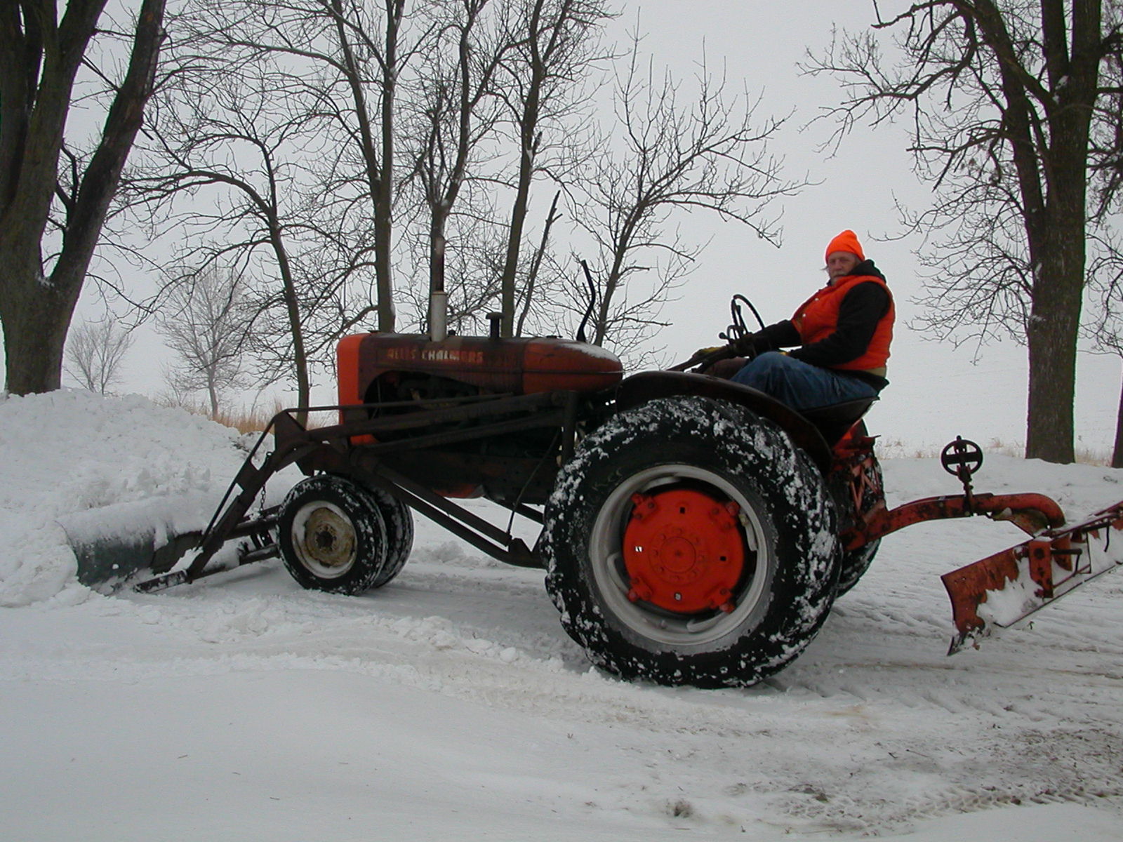

Here is how I mounted the snow plow to my WD. I have since sold the tractor so I mounted this plow on my CA, just narrowed the width of the bracket. I have also added gauge wheels instead of skids. The gauge wheels are the ones off of my Woods belly mower, I shouldn't need them on there till spring. I just put them on today so I don't know how they will work yet. I'll try to get some pics.
