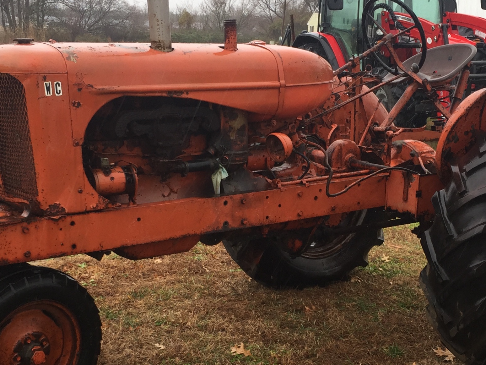

Any body got a picture of a wc pulling hitch girlfriend bought one today need to get it set up got one more pull

Awesome! Good luck with the puller. I will be watching! Those WC's seem to do real well. Will you be in the 3000 lb clas or 3500 lb class? I have never drove a WC. On the hitch, well if you have done this before you may have some good ideas. I would get the fules and start moving the current hitch as much as you can.

         Bradley,  out of the 3 pulls I went to this year with my WC in the 3750 farm stock I had 2 first place and one second place. Standard factory draw bar set up for tractor  with pto.

brad,  tons of hitch pictures on google search.  some good, some bad.  when i built the hitch for my UC,  i took the things i liked from several different hitches and incorporated in to my design.  that being said.  the simplest way is remove the drawbar and bolt on a piece of plate with a hole in it to support.  not adjustable but short and stout.  depends on how serious you want to get with pulling.
