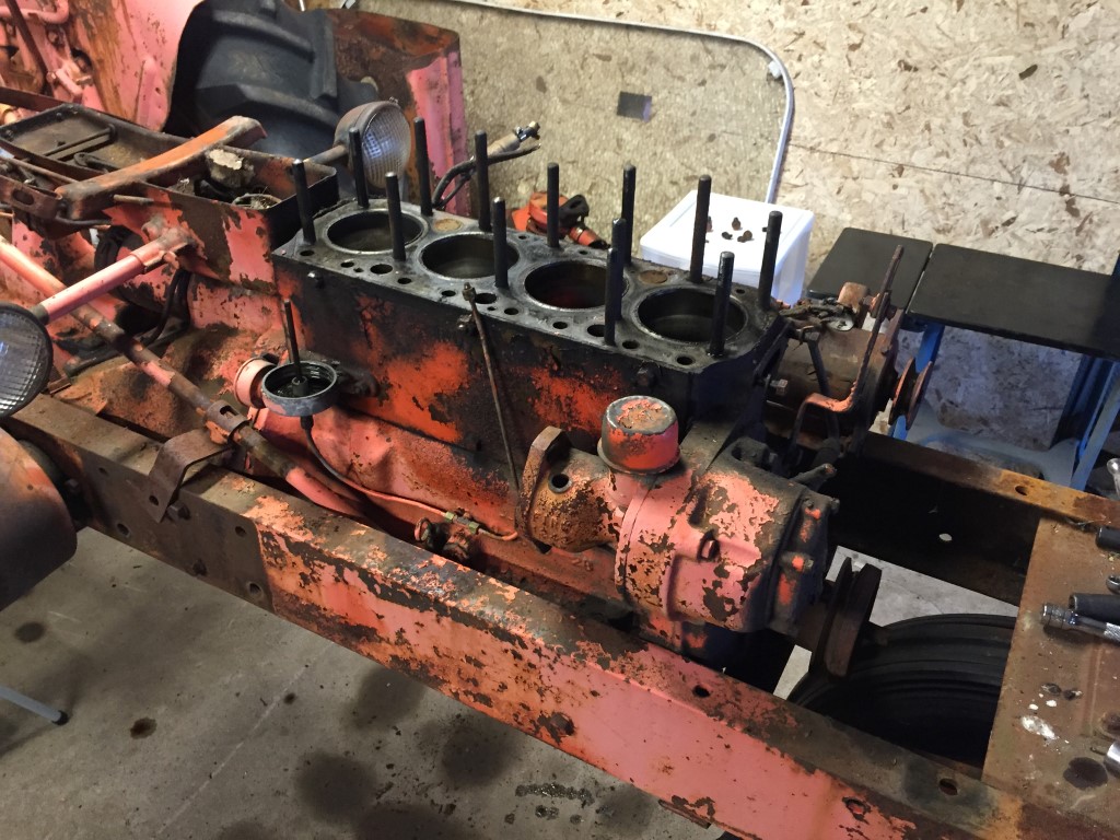

Am putting my 1937 WC back together.  I've got 4 long studs and 8 shorter studs for bolting the cylinder head to the block.  The exploded parts manual only shows where one of the long studs goes.  Where do the other 3 go?

I believe the 4 long ones go along the manifold side and are the ones outside the valve cover that hold the coolant piping onto the head as well. I am in the middle of a WC restoration and I will see if I can get some pics of mine with the head off an studs still in.

uploads/14031/2015-08-18_17.13.51_Medium.jpg
You can see the four along the left/manifold side of the engine.

That's why I love this forum.  Somebody always has the answer.  Thanks so much!
