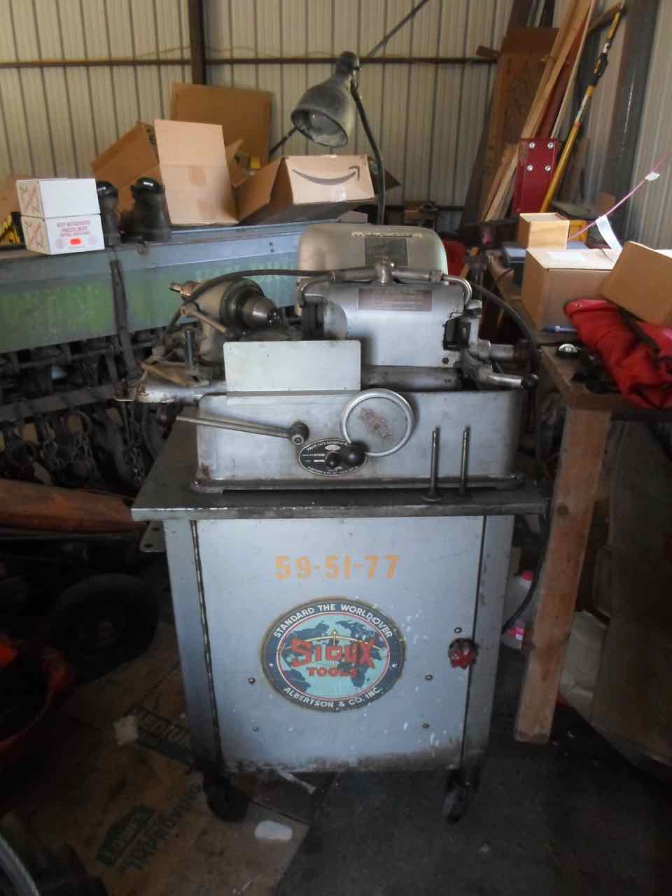

I bought an old Sioux 645L valve grinder/refacer a couple years back, tore it apart to clean it up, and didn't get it put back together until the other day. My 1951 WD needs some touch up work on the valves and seats (it appears to have seat inserts installed already).
The seat grinder is hiding in the cabinet. My question is - if anyone on here has ground seats in their AC engines before, what type of stone were you using? I am currently planning on ordering some general rough and finish stones since I can't find that AC was using anything like Stellite in the WD-45 and earlier tractors, which is mostly what I have. Figured someone on here might have some experience with what the best types of stones to use are.

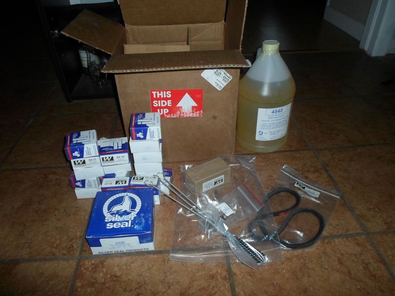

Post Options Post Options   Thanks (0) Thanks(0)   Quote wjohn Quote  Post ReplyReply Direct Link To This Post Posted: 29 May 2020 at 8:56pm
Christmas in May? My grinding stones, fluid, etc. order came in. Guess I better get the valve guides ordered so I can do the seats.
