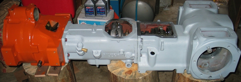

Here is a picture of a WD45, I think the WD would have the same fill holes but I don't know that for sure.  You can see there are three fill holes.  The one in front is the one with a dipstick, that is for the hydraulic system.  The other two both fill the rearend and transmission.
The rear one in this picture is missing the plug.  The whole works can be filled with HyTran universal tractor fluid, so that makes it easier.
