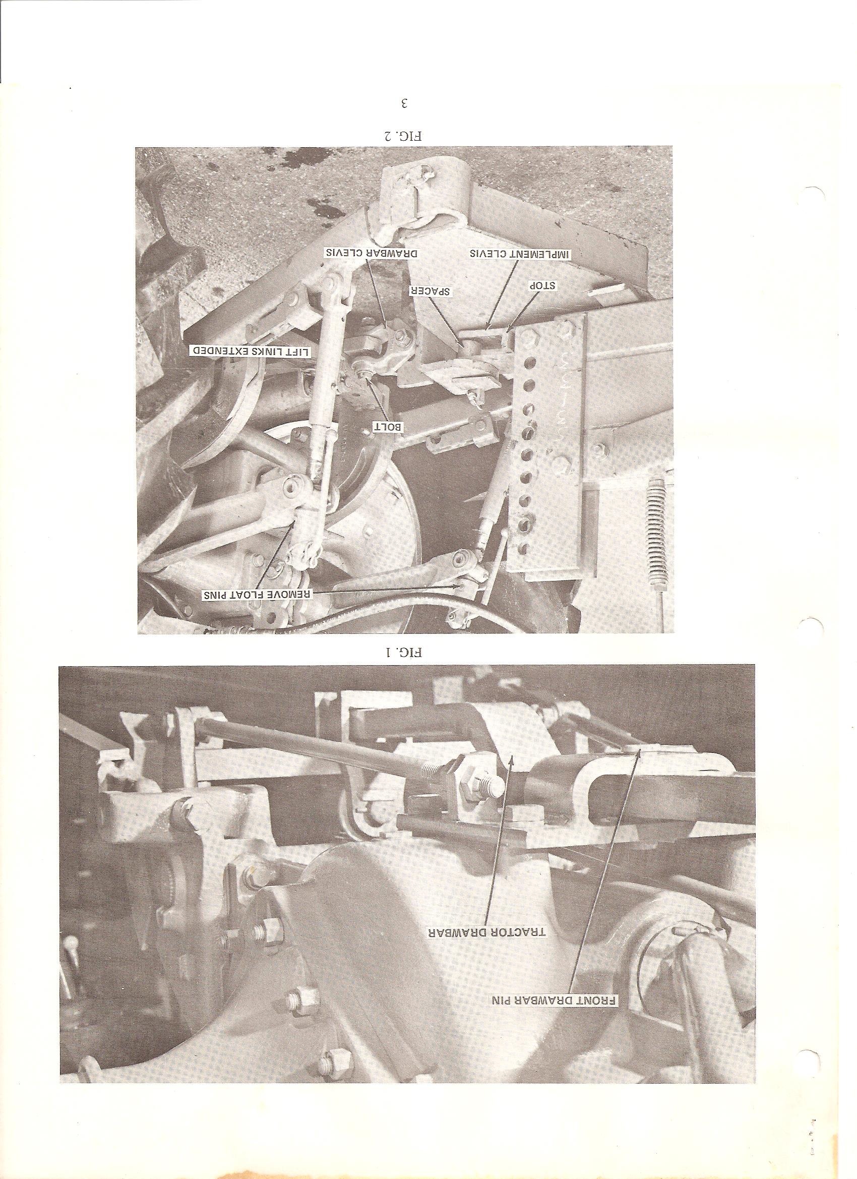

I ran across this Service Bulletin and thought others might find it helpful.
