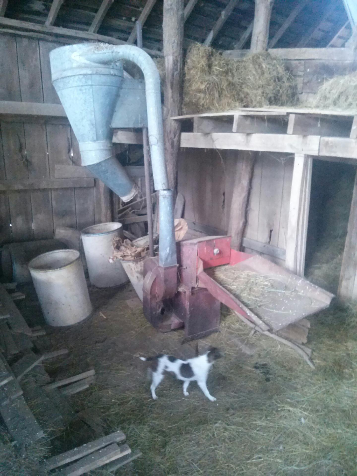

It's belt driven yes. Has an approximate 6 inch diameter input pulley. Was hoping maybe the little C would turn it. Probably grind less than 500 pounds a month if that much.

A C oughta run that, no problem.  You might want to check out what the hammers and screen look like, most are of a type that can be rotated 4 times, before they are wore out.  even after that, you can grind a square shoulder on the rounded hammers, as long as you keep the weight the same for each hammer, to keep the whole thing in balance...

hook it up and run it, you'll soon find out what it'll handle and what it won't!

You'll know how fast you can feed it by the sound of things when it begins to lug down. That and watching the belt slide outward on the pulley, ready to slide off, when the going is getting too tough.

Power required will be affected by the screen in use as well as how fast you can shovel grain in.
