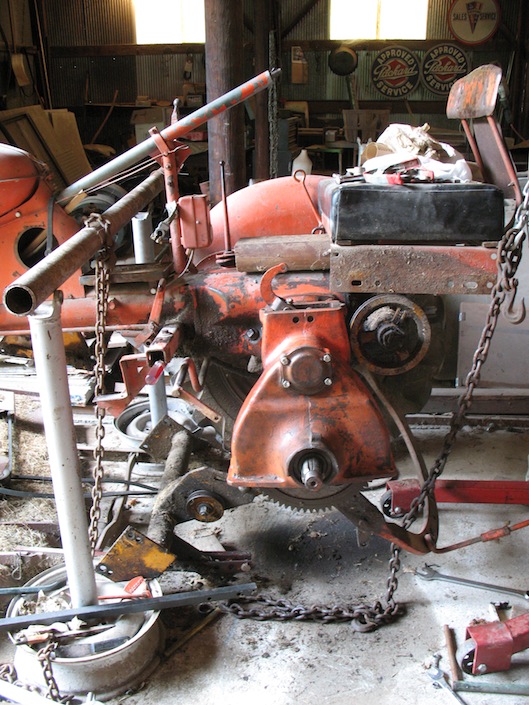

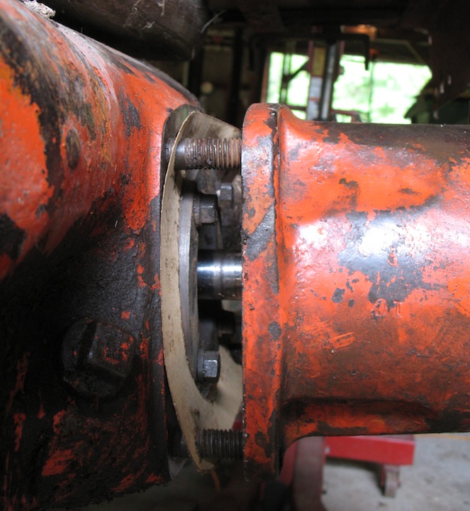

OK, I got the new bearings and other replacement parts put in, so I set about reinstalling the thing. I thought if I rotated the shaft until the splines lined up, it should slip right in. But the shaft seems to be hitting something solid. The second picture shows it at that point. I won't go in any farther. What's the secret?

Sometimes you have to wiggle it up and down or side to side and then it will go. BTDTClap

Bottom looks deeper in than the upper part. Got to go in even.

It should slide right in with some movement. The only place it would be hitting would be infront of that shaft in the axle hole. Pull it out and look in there to see if something may have miss aligned somehow. I've don't tons of them and never had an issue. I've had to get physical with a couple before that question the risk of my back but everyone went in.

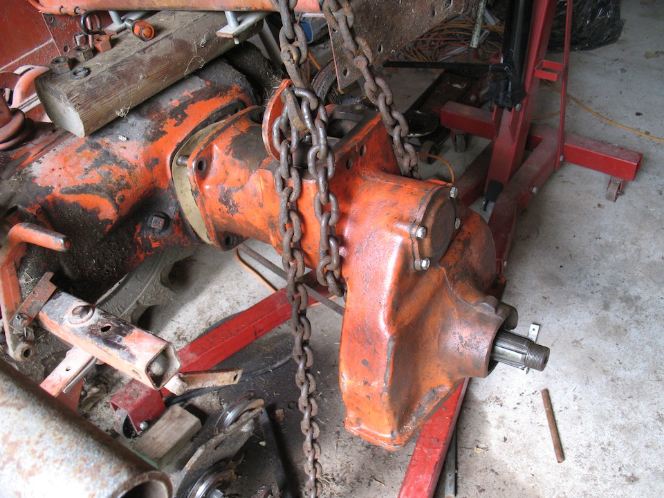

I would block the bull gear pan about level, place your chain up closer to the transmission to where it is almost at a balance but heavy on the axle end. That way you can grab the axle and move the final drive in all directions without breaking your back. Once the axle starts to enter the splines you can adjust the chain up or down to go in the rest of the way. You will not want to put a lot of pressure pushing inward until the shaft starts to enters the splines. As you turn the axle you will then be able to feel the shaft catch and start to enter. You can measure the flange top and bottom to make sure the chain is at the proper height before you start.

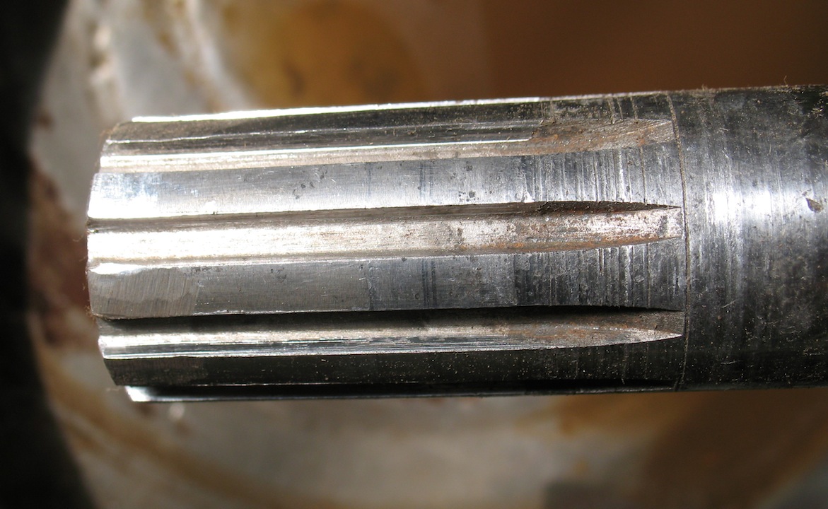

Normally if it wont go into the spline, the splines were enlarged by smacking the shaft when removing the brake drum and bearing. Pull it back out, take a mike and check the OD of the spline in the first inch and then back 2 inches. You may need a file to take off a few thousands on the OD and cleanup the spline root.

I gave the end of the shaft a thorough cleaning and a close inspection.  It looked to me like the ends of some of the splines were mashed wide.
After a bit of filing, I slathered on a little grease, raised the hoist, and shoved the shaft into the housing. I pried the bull gear with a screwdriver to turn the shaft until the splines meshed, and with a little jiggling the thing slid in the rest of the way and I had it bolted back on in less than five minutes.
